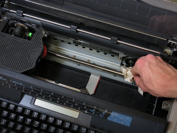

    • Open the lid to the typewriter.
  2. How to clean and lubricate Panasonic KX-E603 carriage: crwdns2935265:02crwdnd2935265:01crwdnd2935265:01crwdne2935265:0
    • Wipe down the rails with a clean cloth to remove any debris, making sure to clean around the carriage.
  3. How to clean and lubricate Panasonic KX-E603 carriage: crwdns2935265:03crwdnd2935265:01crwdnd2935265:02crwdne2935265:0 How to clean and lubricate Panasonic KX-E603 carriage: crwdns2935265:03crwdnd2935265:02crwdnd2935265:02crwdne2935265:0
    • Place several drops of the oil-based lubricant onto another clean rag, and wipe down the rails. Gently move the carriage back and forth to spread the lubricant.
