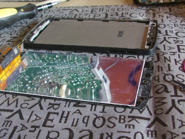

  1. How to clean a water damaged Nexus 5 Display, Separate the screen and the frame.: crwdns2935265:02crwdnd2935265:01crwdnd2935265:02crwdne2935265:0 How to clean a water damaged Nexus 5 Display, Separate the screen and the frame.: crwdns2935265:02crwdnd2935265:02crwdnd2935265:02crwdne2935265:0

    • Flex what needs to be unstick
    • The flex is strongly stuck on the frame, to remove it warm with a Heat Gun.
  2. How to clean a water damaged Nexus 5 Display, Heating the screen at 50°C.: crwdns2935265:03crwdnd2935265:01crwdnd2935265:02crwdne2935265:0 How to clean a water damaged Nexus 5 Display, Heating the screen at 50°C.: crwdns2935265:03crwdnd2935265:02crwdnd2935265:02crwdne2935265:0
    • I used a multimeter with temperature measurement; it's not exact but it works.
    • Heating the edges.

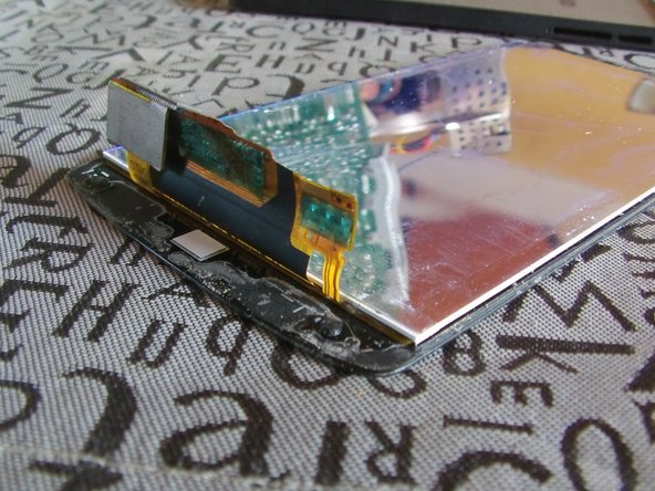

  3. How to clean a water damaged Nexus 5 Display, Separating the screen and the frame.: crwdns2935265:04crwdnd2935265:01crwdnd2935265:03crwdne2935265:0 How to clean a water damaged Nexus 5 Display, Separating the screen and the frame.: crwdns2935265:04crwdnd2935265:02crwdnd2935265:03crwdne2935265:0 How to clean a water damaged Nexus 5 Display, Separating the screen and the frame.: crwdns2935265:04crwdnd2935265:03crwdnd2935265:03crwdne2935265:0
    • Be careful with the flex!
    • If you are installing a new LCD screen you must put it on the frame and follow all the steps in reverse order.
    • With a guitar pick you can separate the screen slowly.

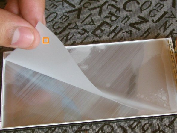

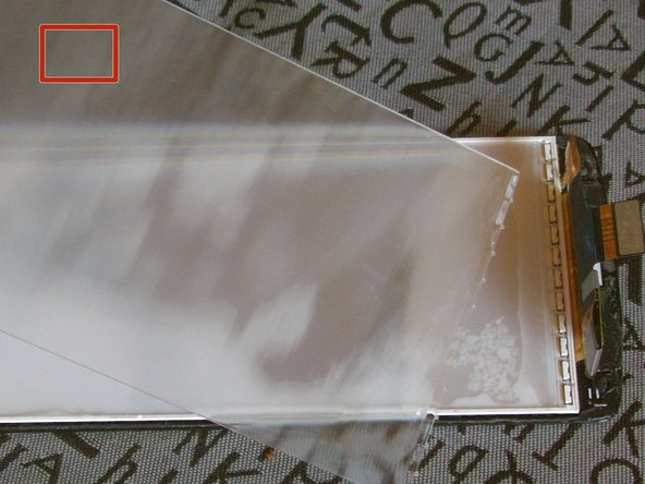

  4. How to clean a water damaged Nexus 5 Display, Removing the layers on the screen.: crwdns2935265:05crwdnd2935265:01crwdnd2935265:03crwdne2935265:0 How to clean a water damaged Nexus 5 Display, Removing the layers on the screen.: crwdns2935265:05crwdnd2935265:02crwdnd2935265:03crwdne2935265:0 How to clean a water damaged Nexus 5 Display, Removing the layers on the screen.: crwdns2935265:05crwdnd2935265:03crwdnd2935265:03crwdne2935265:0
    • I used a hair dryer with cold air to help to separate the layers.
    • The first layer we need remove.
    • The second layer still on the frame of the screen.
    • The wet layers are on the screen
  5. How to clean a water damaged Nexus 5 Display, Removing the layers on the screen pt2: crwdns2935265:06crwdnd2935265:01crwdnd2935265:03crwdne2935265:0 How to clean a water damaged Nexus 5 Display, Removing the layers on the screen pt2: crwdns2935265:06crwdnd2935265:02crwdnd2935265:03crwdne2935265:0 How to clean a water damaged Nexus 5 Display, Removing the layers on the screen pt2: crwdns2935265:06crwdnd2935265:03crwdnd2935265:03crwdne2935265:0
    • use the guitar pick to separate the layers
    • 2nd layer
    • 3rd layer
  6. How to clean a water damaged Nexus 5 Display, Dry and clean.: crwdns2935265:07crwdnd2935265:01crwdnd2935265:03crwdne2935265:0 How to clean a water damaged Nexus 5 Display, Dry and clean.: crwdns2935265:07crwdnd2935265:02crwdnd2935265:03crwdne2935265:0 How to clean a water damaged Nexus 5 Display, Dry and clean.: crwdns2935265:07crwdnd2935265:03crwdnd2935265:03crwdne2935265:0
    • 3rd layer - don't separate.
    • 4th layer - don't separate.
    • 5th layer don't remove.
    • You can dry and clean all the layers (i use electrical contact cleaner).
