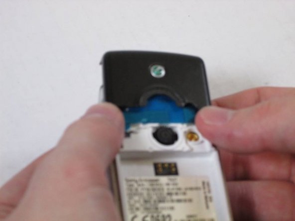

  4. How to clean Sony Ericsson QuickShare T630 joystick: crwdns2935265:04crwdnd2935265:01crwdnd2935265:02crwdne2935265:0 How to clean Sony Ericsson QuickShare T630 joystick: crwdns2935265:04crwdnd2935265:02crwdnd2935265:02crwdne2935265:0
    • Remove the rubber plug located near the camera by gently prying upward with your fingers.
    • Gently lift the camera shield after removal of the rubber plug.

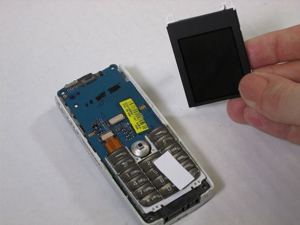

  9. How to clean Sony Ericsson QuickShare T630 joystick: crwdns2935265:09crwdnd2935265:01crwdnd2935265:03crwdne2935265:0 How to clean Sony Ericsson QuickShare T630 joystick: crwdns2935265:09crwdnd2935265:02crwdnd2935265:03crwdne2935265:0 How to clean Sony Ericsson QuickShare T630 joystick: crwdns2935265:09crwdnd2935265:03crwdnd2935265:03crwdne2935265:0
    • This step is NOT required for joystick maintenance or keypad maintenance and replacement! Continue on to step 10 if you are attempting to achieve either of these goals.
    • Slowly lift the screen to reveal the green circuit ribbon connecting the screen to the phone.
    • Gently pull the ribbon from the circuit.
    • Remove the now disconnected screen.

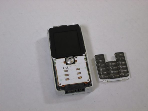

  10. How to clean Sony Ericsson QuickShare T630 joystick: crwdns2935265:010crwdnd2935265:01crwdnd2935265:03crwdne2935265:0 How to clean Sony Ericsson QuickShare T630 joystick: crwdns2935265:010crwdnd2935265:02crwdnd2935265:03crwdne2935265:0 How to clean Sony Ericsson QuickShare T630 joystick: crwdns2935265:010crwdnd2935265:03crwdnd2935265:03crwdne2935265:0
    • Remove the keyboard by slowly pulling it away from the circuit board.
    • There are no direct connections between the keyboard and phone.
    • These are all of the parts covered in this disassembly that make up the Sony Ericsson QuickShare T630.
  11. How to clean Sony Ericsson QuickShare T630 joystick, How to clean Sony Ericsson QuickShare T630 joystick: crwdns2935265:011crwdnd2935265:01crwdnd2935265:01crwdne2935265:0
    • Gently lift the white circuit board to reveal the base.
  12. How to clean Sony Ericsson QuickShare T630 joystick: crwdns2935265:012crwdnd2935265:01crwdnd2935265:01crwdne2935265:0
    • Soak cotton swab in rubbing alcohol
    • Gently work the cotton swab around the joystick, removing any waste buildup that may hinder its use.
