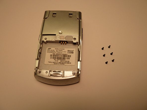

    • Locate the six (4mm) screws on the back casing of the phone.
    • Unscrew each one using a phillips head #000 screwdriver.
    • Place screws on magnetic mat.

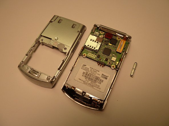

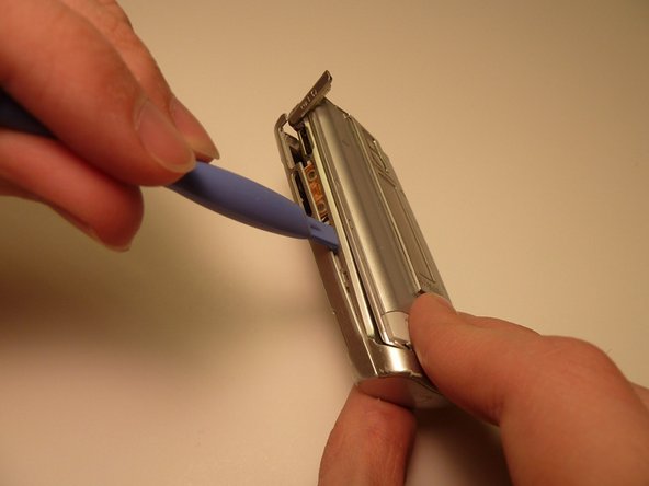

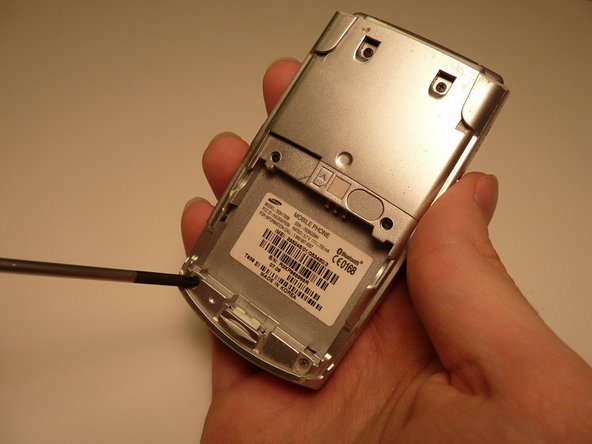

    • Starting at the top of the phone, carefully insert plastic opening device into the seam.
    • Carefully slide device along the seam and around the corners of the phone until the back is separated from the front.
    • Note: Some force must be exerted. Be careful when taking off panel. Go slow.
    • Note: The volume button may separate from the case, this is normal. It is not broken.

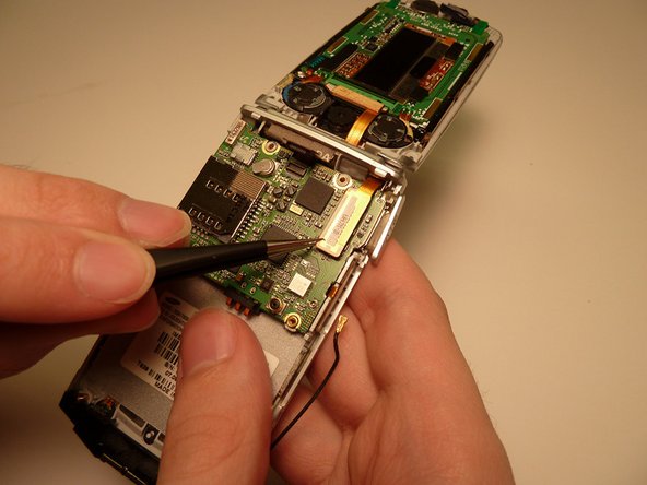

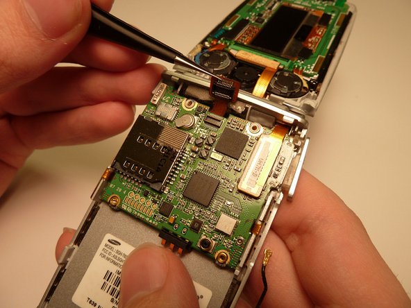

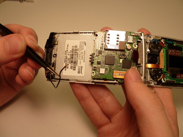

    • Locate the connection point of black wire running from the microphone to the motherboard.
    • Carefully disconnect the gold connector from the motherboard using tweezers.

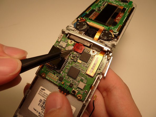

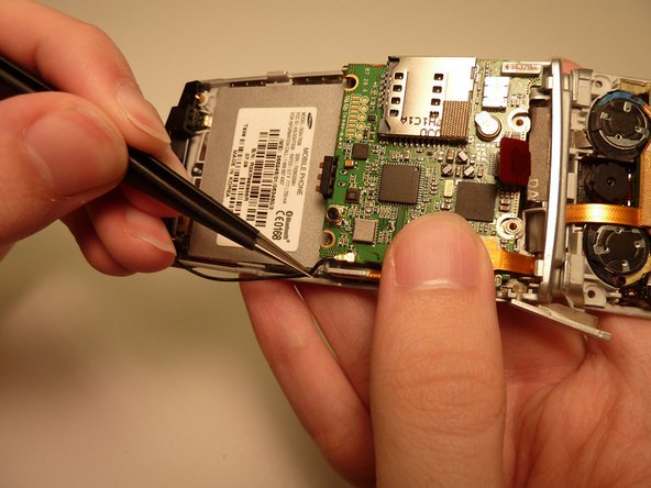

    • Locate the red connector at the top of the motherboard.
    • Carefully lift and remove the connector from the motherboard using tweezers.

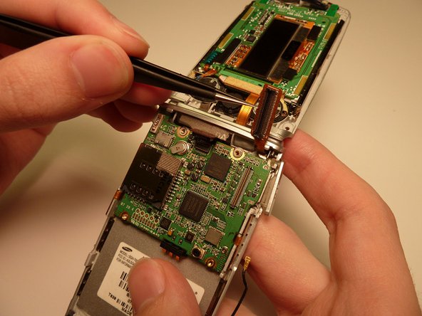

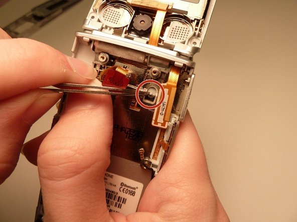

    • Locate the gold connector that connects the screen to the motherboard.
    • Carefully disconnect the connector from the motherboard using tweezers.
  8. How to clean Samsung SGH-T639 keypad: crwdns2935265:08crwdnd2935265:01crwdnd2935265:03crwdne2935265:0 How to clean Samsung SGH-T639 keypad: crwdns2935265:08crwdnd2935265:02crwdnd2935265:03crwdne2935265:0 How to clean Samsung SGH-T639 keypad: crwdns2935265:08crwdnd2935265:03crwdnd2935265:03crwdne2935265:0

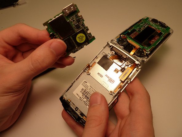

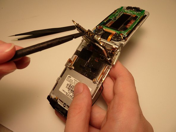

    • Start at the bottom of the motherboard and gently pry it from the back of the cell phone using the plastic opening tool.
    • Lift the motherboard from the cell phone.
  9. How to clean Samsung SGH-T639 keypad: crwdns2935265:09crwdnd2935265:01crwdnd2935265:01crwdne2935265:0
    • Remove the motherboard from the cell phone.

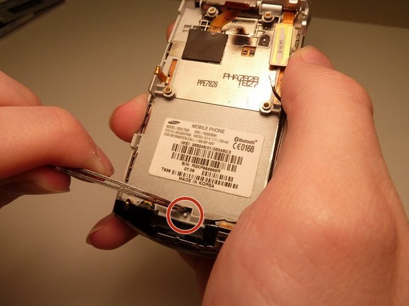

  10. How to clean Samsung SGH-T639 keypad, Keypad: crwdns2935265:010crwdnd2935265:01crwdnd2935265:02crwdne2935265:0 How to clean Samsung SGH-T639 keypad, Keypad: crwdns2935265:010crwdnd2935265:02crwdnd2935265:02crwdne2935265:0

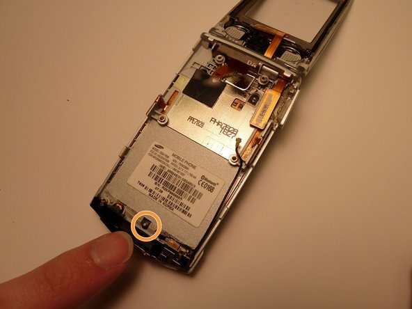

    • Locate the two black, rubber tabs near the top of the back of the phone.
    • Locate the one black, rubber tab near the base of the phone.
  11. How to clean Samsung SGH-T639 keypad: crwdns2935265:011crwdnd2935265:01crwdnd2935265:03crwdne2935265:0 How to clean Samsung SGH-T639 keypad: crwdns2935265:011crwdnd2935265:02crwdnd2935265:03crwdne2935265:0 How to clean Samsung SGH-T639 keypad: crwdns2935265:011crwdnd2935265:03crwdnd2935265:03crwdne2935265:0
    • Using tweezers, pry each of the tabs open.
    • Tuck each tab behind the white notch.
    • By tucking the tabs behind each notch. This allows improves the ease of removing the keypad.

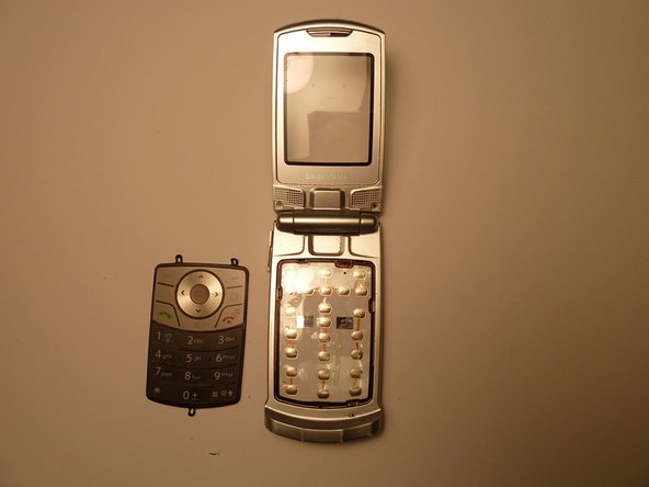

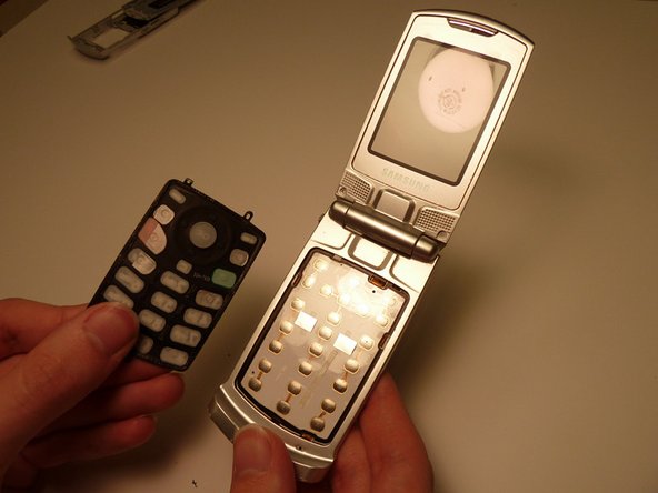

  12. How to clean Samsung SGH-T639 keypad: crwdns2935265:012crwdnd2935265:01crwdnd2935265:03crwdne2935265:0 How to clean Samsung SGH-T639 keypad: crwdns2935265:012crwdnd2935265:02crwdnd2935265:03crwdne2935265:0 How to clean Samsung SGH-T639 keypad: crwdns2935265:012crwdnd2935265:03crwdnd2935265:03crwdne2935265:0
    • Flip phone over to make the keypad visable.
    • Carefully lift keypad around the edges.
    • Remove keypad from the cell phone.

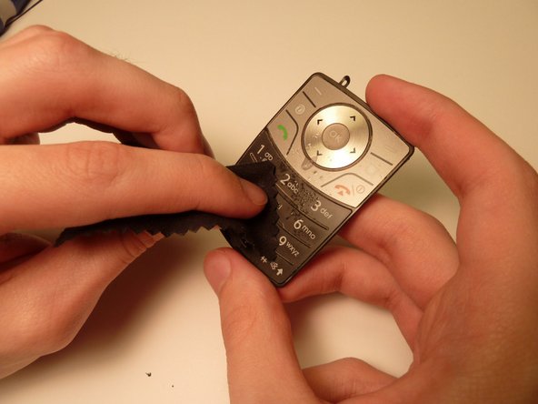

  13. How to clean Samsung SGH-T639 keypad, How to clean Samsung SGH-T639 keypad: crwdns2935265:013crwdnd2935265:01crwdnd2935265:01crwdne2935265:0
    • Obtain device cleaner and a cleaning pad.

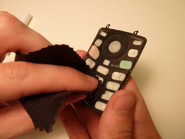

  14. How to clean Samsung SGH-T639 keypad: crwdns2935265:014crwdnd2935265:01crwdnd2935265:03crwdne2935265:0 How to clean Samsung SGH-T639 keypad: crwdns2935265:014crwdnd2935265:02crwdnd2935265:03crwdne2935265:0 How to clean Samsung SGH-T639 keypad: crwdns2935265:014crwdnd2935265:03crwdnd2935265:03crwdne2935265:0

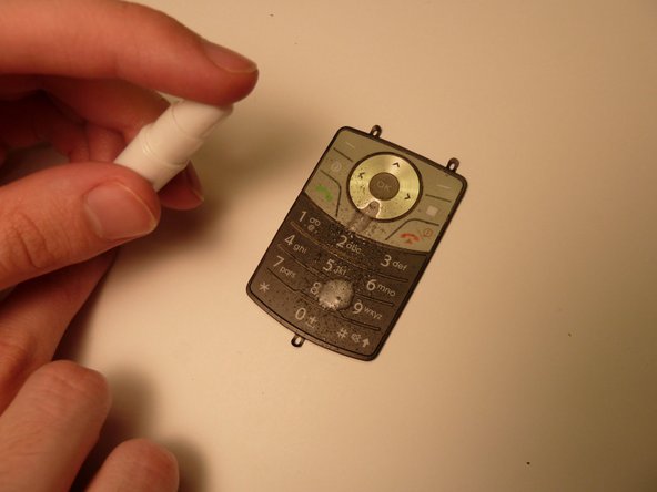

    • Spray the front of the keypad with device cleaner.
    • Clean front of keypad using cleaning cloth.
  15. How to clean Samsung SGH-T639 keypad: crwdns2935265:015crwdnd2935265:01crwdnd2935265:03crwdne2935265:0 How to clean Samsung SGH-T639 keypad: crwdns2935265:015crwdnd2935265:02crwdnd2935265:03crwdne2935265:0 How to clean Samsung SGH-T639 keypad: crwdns2935265:015crwdnd2935265:03crwdnd2935265:03crwdne2935265:0

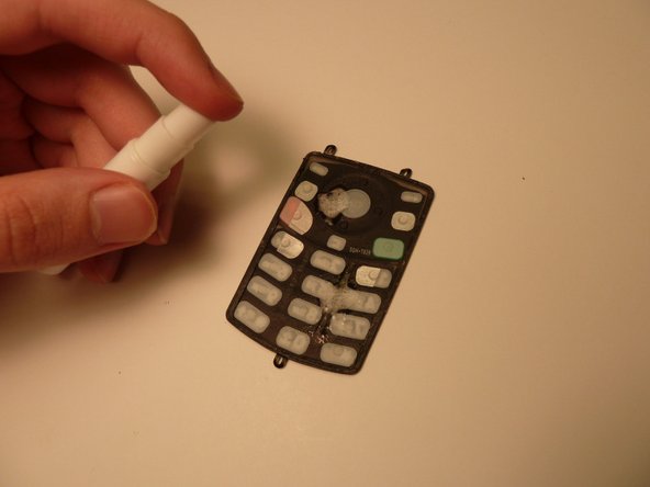

    • Flip keypad over.
    • Spray back of keypad with device cleaner.
    • Clean back of keypad with cleaning cloth.
