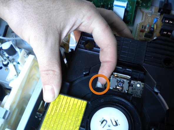

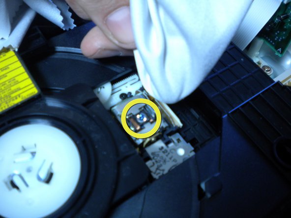

    • Before cleaning DVD lens, make sure that the front of the device is facing towards you.
    • Note that the DVD component of the device is boxed in red.
    • To access the DVD lens, spin the gear circled in image two counter-clockwise until the lens is exposed.
    • Clean the lens by GENTLY rubbing with a microfiber cloth and a cleaning solution of your choice.
