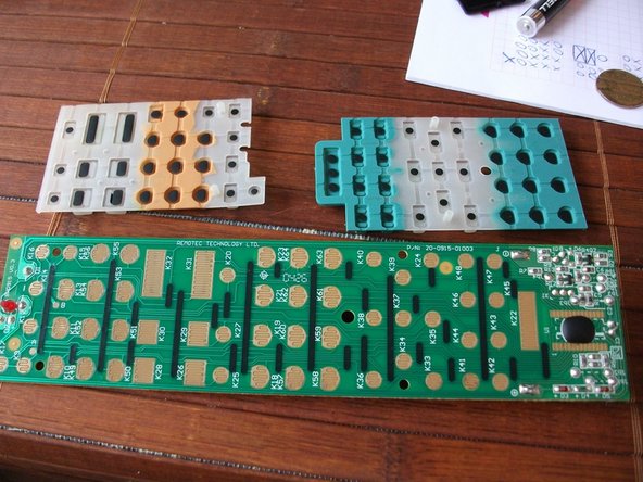

    • For later testing: X marks butttons which still work, O marks buttons that don't.
  2. How to clean Non-functoning buttons on remote: crwdns2935265:02crwdnd2935265:01crwdnd2935265:02crwdne2935265:0 How to clean Non-functoning buttons on remote: crwdns2935265:02crwdnd2935265:02crwdnd2935265:02crwdne2935265:0
    • Open battery housing and remove the batteries
    • Remove the screw located in the center of the battery housing
  3. How to clean Non-functoning buttons on remote: crwdns2935265:03crwdnd2935265:01crwdnd2935265:01crwdne2935265:0
    • Top and bottom shell of the remote are held together by 4 latches per side. The most fore and aft ones are located about 1cm from each end
    • Pry them open with a small flat head. If you're carefull that will leave only tiny scratches, but it does take some force
  4. How to clean Non-functoning buttons on remote: crwdns2935265:04crwdnd2935265:01crwdnd2935265:02crwdne2935265:0 How to clean Non-functoning buttons on remote: crwdns2935265:04crwdnd2935265:02crwdnd2935265:02crwdne2935265:0
    • Once open, remove the insides and clean them from all the drinks and what not that has been poored over the remote
    • If necessary, add contact spray or alike to the buttom of the rubber buttons
  5. How to clean Non-functoning buttons on remote: crwdns2935265:05crwdnd2935265:01crwdnd2935265:01crwdne2935265:0
    • After cleaning and before full re-assembly, you might want to try if things improved.
    • Put the cicruit board back in, add batteries and put the rubber mats onto the circuit board
    • If the repair worked, you should the red top LED flashing
    • Put it all back together again. (Don't forget the screw in the battery housing.)
    • You might need some new batteries as well

Having trouble with the latches. Can you explain the technique you used to pry them open?
Thanks!
bob - crwdns2934203:0crwdne2934203:0
Hi Bob. Force, brute force. Sorry, I don't have a better advice for you. ;-)
andre -
thanks, I fixed mine using your guide.
surfer - crwdns2934203:0crwdne2934203:0
You are a life saver, just fixed my onkyo RC-737m control with this guide... Broken a plastic clip but can't tell when it's back together. Cheers again! Leon
