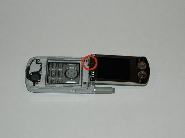

    • On the door's bottom edge, locate the gap between the external and internal screen covers.
    • Using a spudger (not shown), gently pry apart the external and internal covers until the sides start to separate.
    • Continue working your way along the edges of the phone, alternating sides, until the external cover can be easily removed.
  2. How to clean Motorola T720c screen and LCD: crwdns2935265:02crwdnd2935265:01crwdnd2935265:02crwdne2935265:0 How to clean Motorola T720c screen and LCD: crwdns2935265:02crwdnd2935265:02crwdnd2935265:02crwdne2935265:0
    • On the display housing, locate and unscrew the four corner T6 Torx screws connecting the housing and the internal cover.
  3. How to clean Motorola T720c screen and LCD: crwdns2935265:03crwdnd2935265:01crwdnd2935265:02crwdne2935265:0 How to clean Motorola T720c screen and LCD: crwdns2935265:03crwdnd2935265:02crwdnd2935265:02crwdne2935265:0
    • The fragile wire strip connecting the display housing to the circuit board is located on the left side of the inner hinge.
    • Locate the gap between the display housing and internal cover, in the same manner you would flip open the phone, use your finger (not shown) to lift the housing from the cover and set it down.
  4. How to clean Motorola T720c screen and LCD: crwdns2935265:04crwdnd2935265:01crwdnd2935265:01crwdne2935265:0
    • Using a lens cloth, wipe away any dust or debris from the display or screens.
