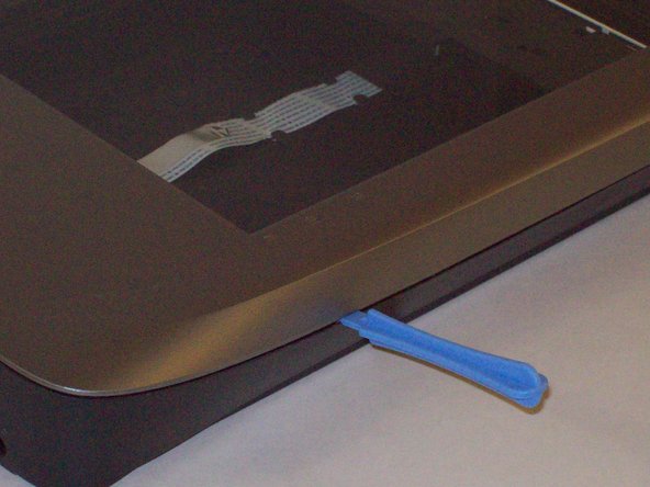

    1. How to clean Microtek ScanMaker 5900 glass, Detach plastic latches: crwdns2935265:03crwdnd2935265:01crwdnd2935265:03crwdne2935265:0 How to clean Microtek ScanMaker 5900 glass, Detach plastic latches: crwdns2935265:03crwdnd2935265:02crwdnd2935265:03crwdne2935265:0 How to clean Microtek ScanMaker 5900 glass, Detach plastic latches: crwdns2935265:03crwdnd2935265:03crwdnd2935265:03crwdne2935265:0
      • Push the plastic opening tools into the crack between the top and the bottom of the chassis.

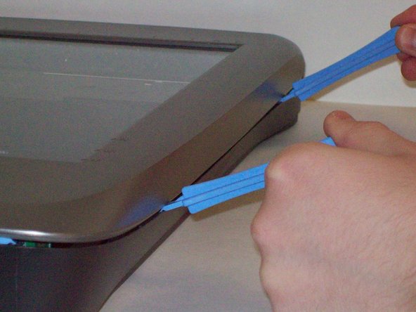

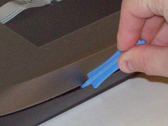

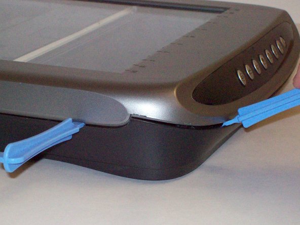

    2. How to clean Microtek ScanMaker 5900 glass, Continue latch detachment: crwdns2935265:04crwdnd2935265:01crwdnd2935265:03crwdne2935265:0 How to clean Microtek ScanMaker 5900 glass, Continue latch detachment: crwdns2935265:04crwdnd2935265:02crwdnd2935265:03crwdne2935265:0 How to clean Microtek ScanMaker 5900 glass, Continue latch detachment: crwdns2935265:04crwdnd2935265:03crwdnd2935265:03crwdne2935265:0
      • After placing one plastic opening tool into the slit, slide other plastic opening tools along the slit to detach the top from the bottom of the chassis.
      • Go all the way along the chassis until you can lift the upper lid.

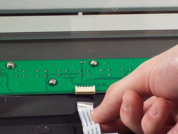

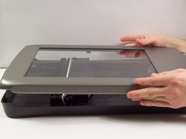

    3. How to clean Microtek ScanMaker 5900 glass, Fully remove the upper lid: crwdns2935265:05crwdnd2935265:01crwdnd2935265:03crwdne2935265:0 How to clean Microtek ScanMaker 5900 glass, Fully remove the upper lid: crwdns2935265:05crwdnd2935265:02crwdnd2935265:03crwdne2935265:0 How to clean Microtek ScanMaker 5900 glass, Fully remove the upper lid: crwdns2935265:05crwdnd2935265:03crwdnd2935265:03crwdne2935265:0
      • Do not fully remove the lid until you remove the ribbon cable attached to the front of the upper lid.
      • Do this by grabbing the upper lid from the sides and rotating it ninety degrees so it is perpendicular to the bottom lid.
      • Grab the ribbon cable and gently pull it out of its slot with your fingers.
      • The upper lid can now safely be removed from the bottom lid.
    1. How to clean Microtek ScanMaker 5900 glass, How to clean Microtek ScanMaker 5900 glass: crwdns2935265:06crwdnd2935265:01crwdnd2935265:01crwdne2935265:0
      • Using a soft lint-free cloth clean the surface glass of dust, finger prints and other debris.
