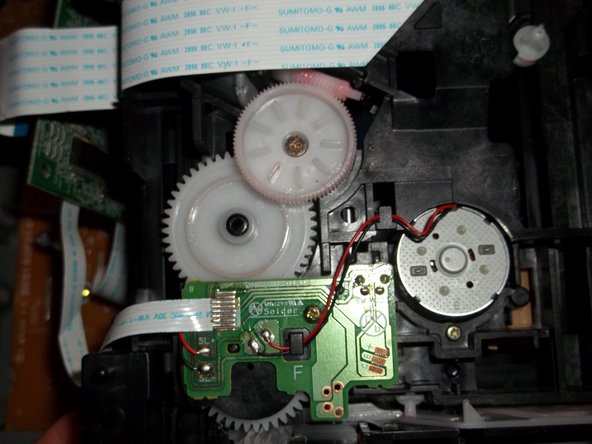

  12. How to clean Magnavox MWD200F gears, How to clean Magnavox MWD200F gears: crwdns2935265:012crwdnd2935265:01crwdnd2935265:02crwdne2935265:0 How to clean Magnavox MWD200F gears, How to clean Magnavox MWD200F gears: crwdns2935265:012crwdnd2935265:02crwdnd2935265:02crwdne2935265:0
    • Turn disc drive over so you can see the gears on the bottom.

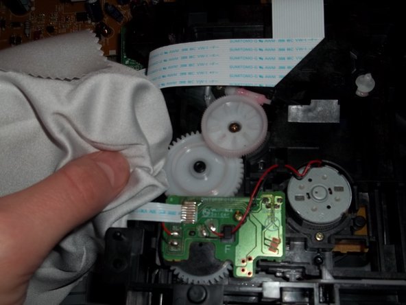

  13. How to clean Magnavox MWD200F gears: crwdns2935265:013crwdnd2935265:01crwdnd2935265:02crwdne2935265:0 How to clean Magnavox MWD200F gears: crwdns2935265:013crwdnd2935265:02crwdnd2935265:02crwdne2935265:0
    • Using a cotton swap or a cleansing cloth and alcohol, gently rub the gears ridding of any debris and dust.
    • You can also use a compressed air can as well. Just point the nozzle at the gears and spray with the compressed air.
