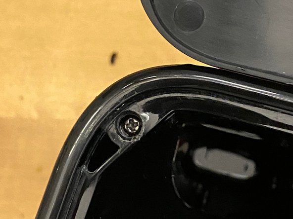

  6. How to clean Cuisinart DGB-850 grinder: crwdns2935265:08crwdnd2935265:01crwdnd2935265:02crwdne2935265:0 How to clean Cuisinart DGB-850 grinder: crwdns2935265:08crwdnd2935265:02crwdnd2935265:02crwdne2935265:0
    • Now open the water door and in the rear corners you will see at left and right rear corners a small screw plugs at each corner. Unfortunately, this will be impossible to remove without damage. So I decided to drill them out with a 1/8" drill to remove them.
    • An alternate method to remove the plugs (that I didn't try) is to try hot-melt glue a stir-stick to the top of the plug to see if you can remove it this way.
  7. How to clean Cuisinart DGB-850 grinder: crwdns2935265:010crwdnd2935265:01crwdnd2935265:01crwdne2935265:0
    • Once these are removed, then you can get to the two M2.5 self-tapping screws underneath them. Remove them.

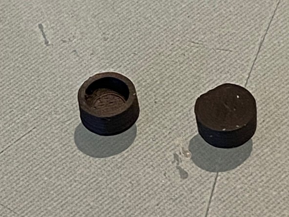

  10. How to clean Cuisinart DGB-850 grinder: crwdns2935265:013crwdnd2935265:01crwdnd2935265:02crwdne2935265:0 How to clean Cuisinart DGB-850 grinder: crwdns2935265:013crwdnd2935265:02crwdnd2935265:02crwdne2935265:0
    • because I pretty much destroyed the screw plugs, and because I have a 3D printer, I just printed some new plugs and use them to replace the ones that I destroyed.
    • If you don't have a 3D printer, you could then, when reassembling, Insert and tighten the screws. Then, hot melt glue the hole to fill it. This should work fine to avoid water ingress.
