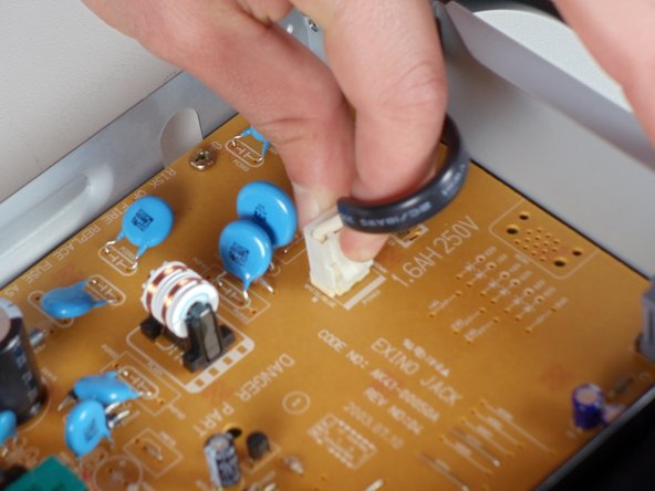

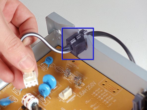

  7. How to check or clean Samsung DVD-P230 buttons, Power Cord: crwdns2935265:07crwdnd2935265:01crwdnd2935265:03crwdne2935265:0 How to check or clean Samsung DVD-P230 buttons, Power Cord: crwdns2935265:07crwdnd2935265:02crwdnd2935265:03crwdne2935265:0 How to check or clean Samsung DVD-P230 buttons, Power Cord: crwdns2935265:07crwdnd2935265:03crwdnd2935265:03crwdne2935265:0
    • Locate the white clip that attaches the cord to the motherboard
    • Grasp clip and squeeze to release
    • Lift up and remove power cord
    • Slide cord mount from outer case

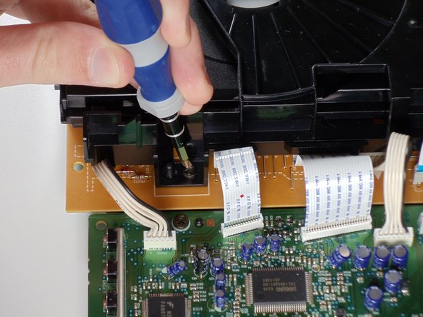

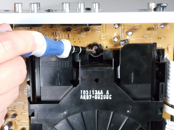

  8. How to check or clean Samsung DVD-P230 buttons, Tray: crwdns2935265:08crwdnd2935265:01crwdnd2935265:03crwdne2935265:0 How to check or clean Samsung DVD-P230 buttons, Tray: crwdns2935265:08crwdnd2935265:02crwdnd2935265:03crwdne2935265:0 How to check or clean Samsung DVD-P230 buttons, Tray: crwdns2935265:08crwdnd2935265:03crwdnd2935265:03crwdne2935265:0
    • Remove the three screws holding in the DVD tray
  9. How to check or clean Samsung DVD-P230 buttons: crwdns2935265:09crwdnd2935265:01crwdnd2935265:02crwdne2935265:0 How to check or clean Samsung DVD-P230 buttons: crwdns2935265:09crwdnd2935265:02crwdnd2935265:02crwdne2935265:0

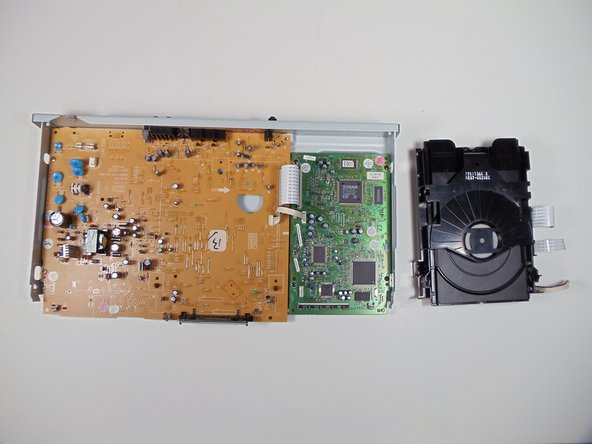

    • Remove the power cord and first two ribbons by pulling them directly out of their sockets.
  10. How to check or clean Samsung DVD-P230 buttons: crwdns2935265:010crwdnd2935265:01crwdnd2935265:02crwdne2935265:0 How to check or clean Samsung DVD-P230 buttons: crwdns2935265:010crwdnd2935265:02crwdnd2935265:02crwdne2935265:0
    • Gently lift the DVD tray off of the motherboard.
  11. How to check or clean Samsung DVD-P230 buttons, How to check or clean Samsung DVD-P230 buttons: crwdns2935265:011crwdnd2935265:01crwdnd2935265:01crwdne2935265:0
    • Use the tweezers to make sure all the buttons aren't stuck.
