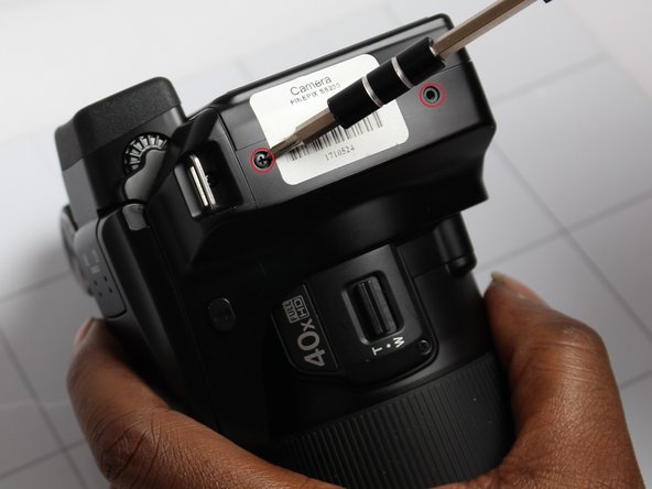

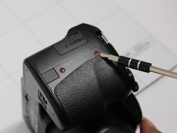

  4. How to check Fujifilm FinePix S8200 for loose LCD connection, Rear Housing Cover: crwdns2935265:04crwdnd2935265:01crwdnd2935265:03crwdne2935265:0 How to check Fujifilm FinePix S8200 for loose LCD connection, Rear Housing Cover: crwdns2935265:04crwdnd2935265:02crwdnd2935265:03crwdne2935265:0 How to check Fujifilm FinePix S8200 for loose LCD connection, Rear Housing Cover: crwdns2935265:04crwdnd2935265:03crwdnd2935265:03crwdne2935265:0
    • Remove the 4mm JIS #00 screws from the sides and bottom of the camera.
