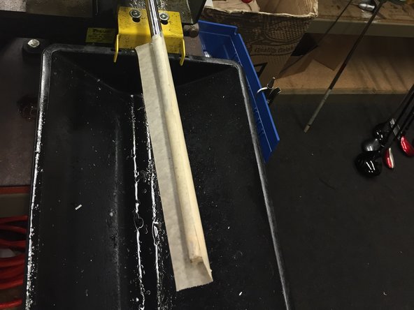

    • Tighten golf club on vice clamp. Align the golf club so that the club face is vertical.
    • Note: Make sure you place container underneath the grip to catch excess mineral spray in later steps.
  2. How to change the grips on a golf club: crwdns2935265:02crwdnd2935265:01crwdnd2935265:02crwdne2935265:0 How to change the grips on a golf club: crwdns2935265:02crwdnd2935265:02crwdnd2935265:02crwdne2935265:0
    • With the xacto knife cut the old grip off of the club.
    • Remove grip from club.
  3. How to change the grips on a golf club: crwdns2935265:03crwdnd2935265:01crwdnd2935265:02crwdne2935265:0 How to change the grips on a golf club: crwdns2935265:03crwdnd2935265:02crwdnd2935265:02crwdne2935265:0
    • Measure the amount of double-sided tape necessary to cover the area of your grip.
    • Place the tape on the club so that it is centered and an extra inch comes off the end of the club.
  4. How to change the grips on a golf club: crwdns2935265:04crwdnd2935265:01crwdnd2935265:02crwdne2935265:0 How to change the grips on a golf club: crwdns2935265:04crwdnd2935265:02crwdnd2935265:02crwdne2935265:0
    • Squirt mineral spirits on the tape.
    • Make sure you drench the tape in mineral spirits.
    • Note: it is safe to get mineral spirits on your skin, it is non-toxic.
  5. How to change the grips on a golf club: crwdns2935265:05crwdnd2935265:01crwdnd2935265:03crwdne2935265:0 How to change the grips on a golf club: crwdns2935265:05crwdnd2935265:02crwdnd2935265:03crwdne2935265:0 How to change the grips on a golf club: crwdns2935265:05crwdnd2935265:03crwdnd2935265:03crwdne2935265:0
    • While the tape still has mineral spray on it, quickly slide the grip all the way down.
  6. How to change the grips on a golf club: crwdns2935265:06crwdnd2935265:01crwdnd2935265:01crwdne2935265:0
    • Wait 1-2 hours for the mineral spray to dry.
