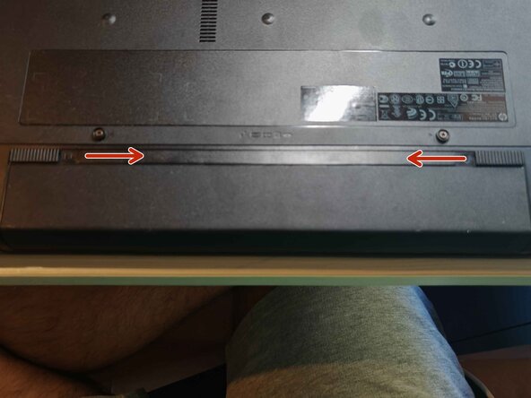

  1. How to change hp 620's keyboard, Remove the battery for safety reasons: crwdns2935265:01crwdnd2935265:01crwdnd2935265:03crwdne2935265:0 How to change hp 620's keyboard, Remove the battery for safety reasons: crwdns2935265:01crwdnd2935265:02crwdnd2935265:03crwdne2935265:0 How to change hp 620's keyboard, Remove the battery for safety reasons: crwdns2935265:01crwdnd2935265:03crwdnd2935265:03crwdne2935265:0
    • push the switches that holdes the battery
    • Push the battery out

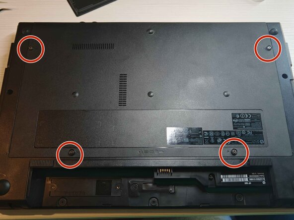

  2. How to change hp 620's keyboard, opening the back plate: crwdns2935265:02crwdnd2935265:01crwdnd2935265:02crwdne2935265:0 How to change hp 620's keyboard, opening the back plate: crwdns2935265:02crwdnd2935265:02crwdnd2935265:02crwdne2935265:0
    • To unscrew the back plate you'll need a #1 philips screwdriver
    • unscrew the 4 screws, don't worry if they don't come out, they don't have to
    • Then push the plate and it will come out
