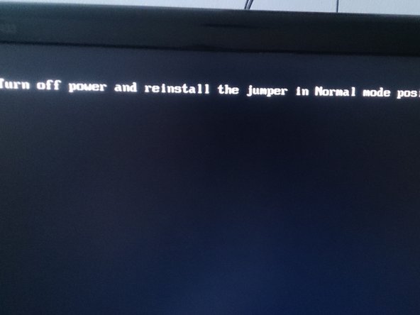

    • The beeping RAM Failure wouldn't let me boot since mainboard needs at least 128 mb of ram installed and with the "Agressive" ram setting it wouldn't see any of the RAM disks.
    • It beeped for hours without any real convetional (short battery pins or remove battery) fixes
  1. How to boot Intel Desktop Board D945PSN in Maintenance Mode, Locate CMOS Jumper and follow the instructions (adnotations on second pic): crwdns2935265:02crwdnd2935265:01crwdnd2935265:02crwdne2935265:0 How to boot Intel Desktop Board D945PSN in Maintenance Mode, Locate CMOS Jumper and follow the instructions (adnotations on second pic): crwdns2935265:02crwdnd2935265:02crwdnd2935265:02crwdne2935265:0
    • Switch jumper from normal position to "configure position" and start the system - it will go to maintenance mode.
  2. How to boot Intel Desktop Board D945PSN in Maintenance Mode: crwdns2935265:03crwdnd2935265:01crwdnd2935265:02crwdne2935265:0 How to boot Intel Desktop Board D945PSN in Maintenance Mode: crwdns2935265:03crwdnd2935265:02crwdnd2935265:02crwdne2935265:0
    • After you change the faulty settings, turn off and reinstall the jumper in Normal mode position as the Bios mentions.
    • After that see if the settings helped (i had to switch from aggressive mode to Automatic Ram management) and computer should boot up normally.
That's the guide on how to reset CMOS or enter Maintenance mode on Intel mainboard D945PSN

I keep getting that black screen (turn off and reinstall the jumper) despite having it in normal mode
