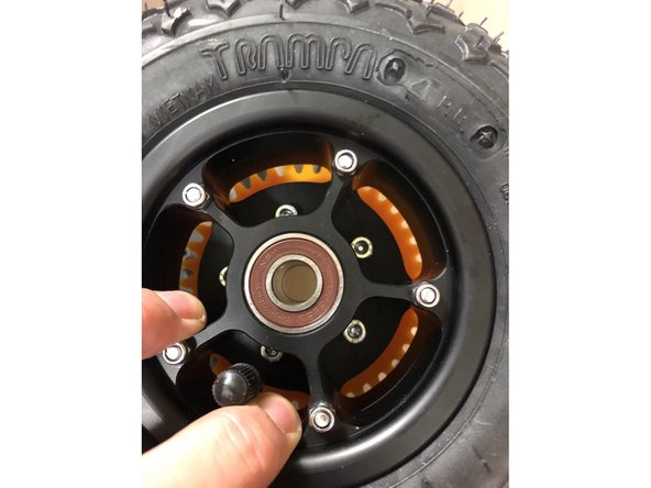

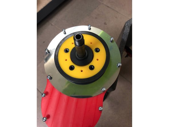

  2. How to assembly FatBoy SS Gear Drive, Attach wheel mounting plate to wheel hubs: crwdns2935265:02crwdnd2935265:01crwdnd2935265:03crwdne2935265:0 How to assembly FatBoy SS Gear Drive, Attach wheel mounting plate to wheel hubs: crwdns2935265:02crwdnd2935265:02crwdnd2935265:03crwdne2935265:0 How to assembly FatBoy SS Gear Drive, Attach wheel mounting plate to wheel hubs: crwdns2935265:02crwdnd2935265:03crwdnd2935265:03crwdne2935265:0
    • Use Provided M3 Bolts to attach wheel mounting plate to the wheel hub.
    • Nuts should face outside
  3. How to assembly FatBoy SS Gear Drive, Attach wheel mounting plate to wheel hubs: crwdns2935265:03crwdnd2935265:01crwdnd2935265:01crwdne2935265:0
    • Make sure to tighten nuts in star pattern to make sure equal tension on all bolts

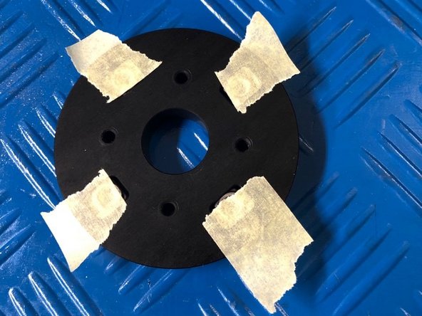

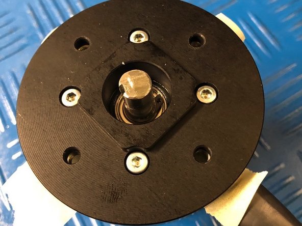

  4. How to assembly FatBoy SS Gear Drive, Preparation to install motors: crwdns2935265:04crwdnd2935265:01crwdnd2935265:03crwdne2935265:0 How to assembly FatBoy SS Gear Drive, Preparation to install motors: crwdns2935265:04crwdnd2935265:02crwdnd2935265:03crwdne2935265:0 How to assembly FatBoy SS Gear Drive, Preparation to install motors: crwdns2935265:04crwdnd2935265:03crwdnd2935265:03crwdne2935265:0
    • If you using motors longer than 90mm (80100, 63100 and etc) mount motor directly to the baseplate and skip to Step 5
    • If using 63xx motors use a masking tape to prevent nuts from falling from motor mounting plate.
    • Attach the plate and use 4 x M3 bolts to attach motor plate to the motors

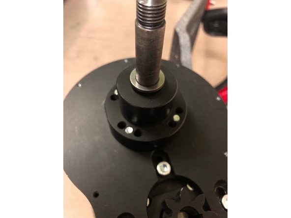

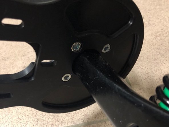

  5. How to assembly FatBoy SS Gear Drive, Mount baseplate to the hanger: crwdns2935265:05crwdnd2935265:01crwdnd2935265:02crwdne2935265:0 How to assembly FatBoy SS Gear Drive, Mount baseplate to the hanger: crwdns2935265:05crwdnd2935265:02crwdnd2935265:02crwdne2935265:0
    • Use Loctite to secure grub screws on mounting hub
    • Tighten grub screws and make sure baseplate is flat and not angled

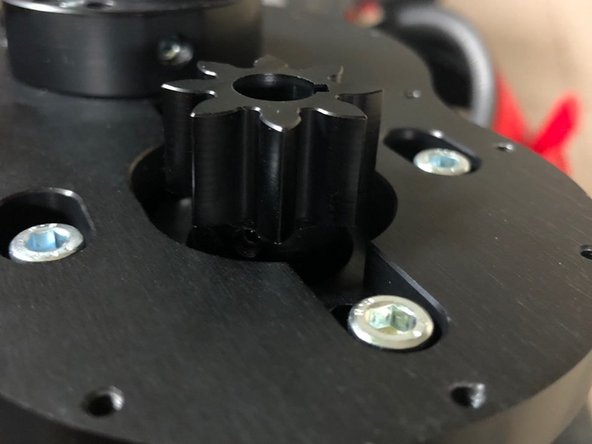

  6. How to assembly FatBoy SS Gear Drive, Attach motor gear to motor axle: crwdns2935265:06crwdnd2935265:01crwdnd2935265:01crwdne2935265:0
    • If your motor has keyway use provided keyway.
    • Use Loctite 648 to secure grub screws inside the motor gear to prevent loosening from vibrations.
    • Measure position lengthwise to stick out of baseplate
    • If motor axle sticks out of motor gear it will need cutting of as it would prevent lid from closing down.

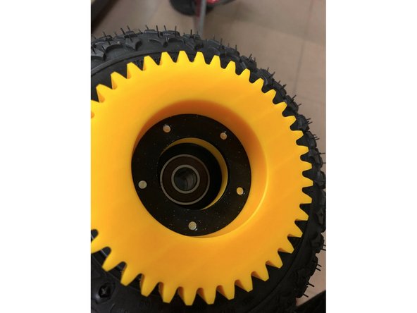

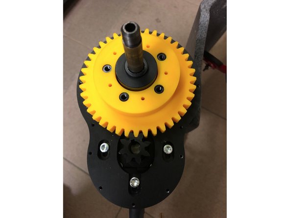

  8. How to assembly FatBoy SS Gear Drive, Attach wheel gear to the wheel for gear meshing: crwdns2935265:08crwdnd2935265:01crwdnd2935265:03crwdne2935265:0 How to assembly FatBoy SS Gear Drive, Attach wheel gear to the wheel for gear meshing: crwdns2935265:08crwdnd2935265:02crwdnd2935265:03crwdne2935265:0 How to assembly FatBoy SS Gear Drive, Attach wheel gear to the wheel for gear meshing: crwdns2935265:08crwdnd2935265:03crwdnd2935265:03crwdne2935265:0
    • Use 5 x M4 bolts to attach wheel gear to the wheel hub for gear meshing.

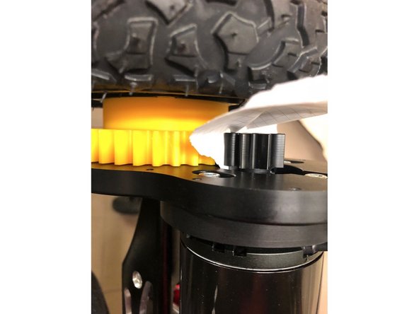

  9. How to assembly FatBoy SS Gear Drive, Mesh gears: crwdns2935265:09crwdnd2935265:01crwdnd2935265:03crwdne2935265:0 How to assembly FatBoy SS Gear Drive, Mesh gears: crwdns2935265:09crwdnd2935265:02crwdnd2935265:03crwdne2935265:0 How to assembly FatBoy SS Gear Drive, Mesh gears: crwdns2935265:09crwdnd2935265:03crwdnd2935265:03crwdne2935265:0
    • Baseplate should be parallel to the wheel otherwise wheels will mesh on angle and will cause negative effects.
    • Attach wheel to the hanger and lower down motor to prepare gear meshing.
    • Motor gear and Wheel gear should be always parallel to each in all wheel position. If gears not parallel and at angle it can cause negative effects and product more noise than necessary.
    • If wheel gear one side is pulled in or further than other sides check wheel hub bolts probably one bolt is more tighten than others or otherwise
    • If wheel gear is more inside than motor gear use washers provided to pull wheel gear away from baseplate
    • Loosen up motor bolts so that motor gear would press wheel gear.
    • Use sheet of paper to drive it through wheel gear and motor gear. Spin wheel to push paper through the gears
    • After meshing is good tighten motor bolts
