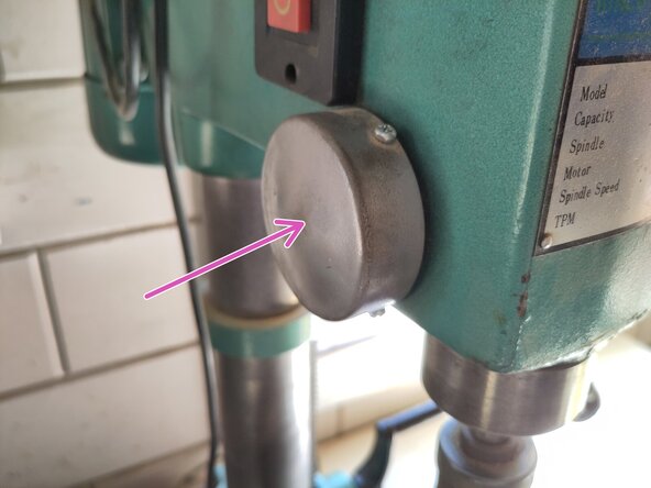

    • Remove the 3 bolts that hold the spring cover in place and remove the cover.

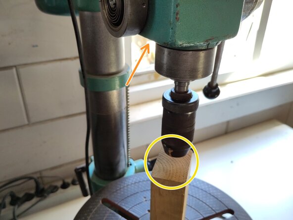

    • When tension is lifted from the spring, the quill will fall down. Put something under the quill to prevent it from falling down all the way.

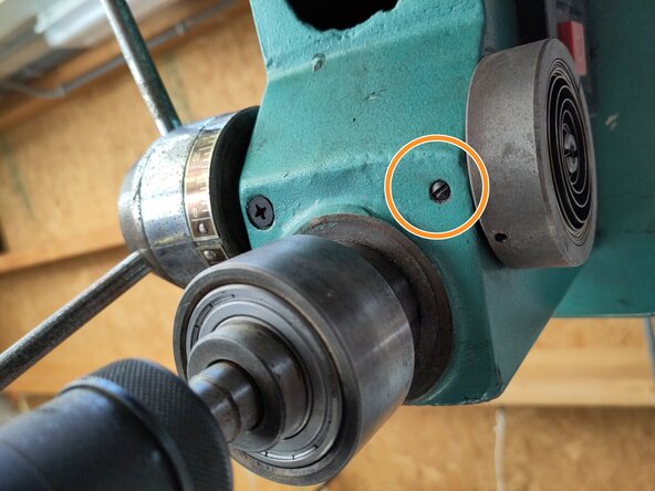

    • Turn the spring lock screw left to release the spring tension.

    • While holding the desired spring position, tighten the lock screw.
    • Finally, place back the cover and screw the bolts back in.
