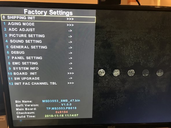

How to access hidden settings on RCA RT2806
  1. How to access hidden settings on RCA RT2806, Power: crwdns2935265:01crwdnd2935265:01crwdnd2935265:01crwdne2935265:0
    • Turn on your TV
  2. How to access hidden settings on RCA RT2806, Open the Menu: crwdns2935265:02crwdnd2935265:01crwdnd2935265:02crwdne2935265:0 How to access hidden settings on RCA RT2806, Open the Menu: crwdns2935265:02crwdnd2935265:02crwdnd2935265:02crwdne2935265:0
    • Open the menu, by pressing the menu button on the remote
  3. How to access hidden settings on RCA RT2806, NumPad Shortcut: crwdns2935265:03crwdnd2935265:01crwdnd2935265:02crwdne2935265:0 How to access hidden settings on RCA RT2806, NumPad Shortcut: crwdns2935265:03crwdnd2935265:02crwdnd2935265:02crwdne2935265:0
    • Press the following buttons quickly after opening the menu:
    • 1-1-4-7
    • This is a column of numbers on your NumPad
    • If it doesn't work, do it more quickly after opening the menu, and check your TV model number.
To close the new menu, press EXIT

You can disable the dog logo on here under General Settings.
9021007 - crwdns2934203:0crwdne2934203:0
Thank you very much. This was driving me insane
Will McCreary -
Is there any way to save settings? Some settings are permanent, but specifically the overscan settings are reset to their original values when I power the screen off, whether by the remote power button, the power button on the screen itself. or by unplugging it.
Please advise.
