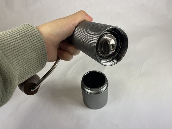

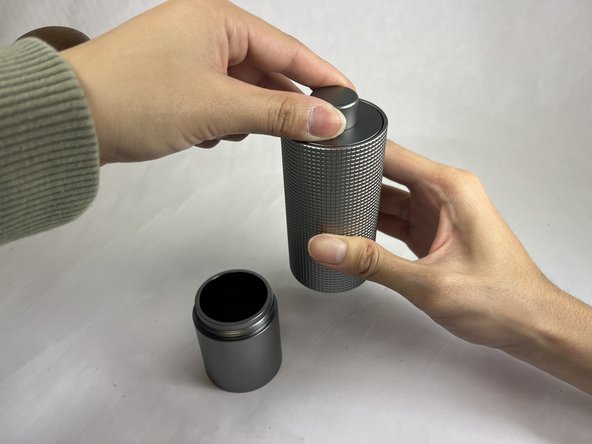

    • Unscrew the bottom of your grinder where the coffee grounds are held and remove it from the grinder's body.
  2. How to Unjam and Clean a DiseZeit Z1M: crwdns2935265:02crwdnd2935265:01crwdnd2935265:03crwdne2935265:0 How to Unjam and Clean a DiseZeit Z1M: crwdns2935265:02crwdnd2935265:02crwdnd2935265:03crwdne2935265:0 How to Unjam and Clean a DiseZeit Z1M: crwdns2935265:02crwdnd2935265:03crwdnd2935265:03crwdne2935265:0
    • Take off the cap of the grinder that has the grinding handle on it by pulling it off.
    • Empty out the grinder body.

    • Put the cap of the grinder back on to the body.
    • Hold the handle on the cap still and turn the grinder upside down so you can see the bottom of the grinder body.

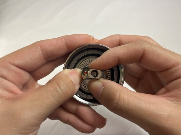

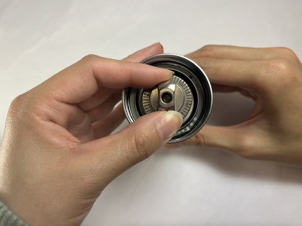

    • Look at the markings on the grinder to see which direction the dial should be turned to make the grounds finer or coarser.
  5. How to Unjam and Clean a DiseZeit Z1M: crwdns2935265:05crwdnd2935265:01crwdnd2935265:03crwdne2935265:0 How to Unjam and Clean a DiseZeit Z1M: crwdns2935265:05crwdnd2935265:02crwdnd2935265:03crwdne2935265:0 How to Unjam and Clean a DiseZeit Z1M: crwdns2935265:05crwdnd2935265:03crwdnd2935265:03crwdne2935265:0
    • Unscrew the dial towards the coarser setting until the dial becomes fully unscrewed from the grinder's body.
    • The grinder has noted counter-clockwise as the direction for coarser grounds.
    • For reassembly, see Step 12.

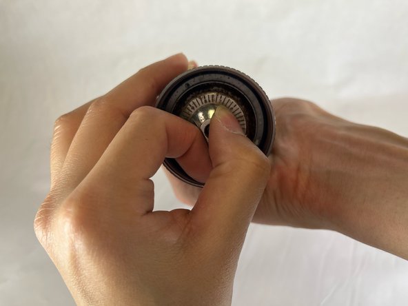

  6. How to Unjam and Clean a DiseZeit Z1M: crwdns2935265:06crwdnd2935265:01crwdnd2935265:02crwdne2935265:0 How to Unjam and Clean a DiseZeit Z1M: crwdns2935265:06crwdnd2935265:02crwdnd2935265:02crwdne2935265:0

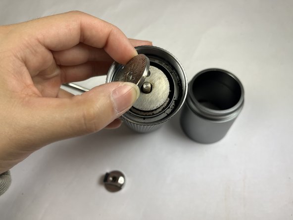

    • Pull out the metal plate from the body of the grinder.
    • For reassembly, see Step 11.

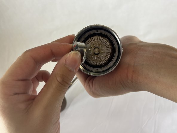

  7. How to Unjam and Clean a DiseZeit Z1M: crwdns2935265:07crwdnd2935265:01crwdnd2935265:02crwdne2935265:0 How to Unjam and Clean a DiseZeit Z1M: crwdns2935265:07crwdnd2935265:02crwdnd2935265:02crwdne2935265:0
    • Pull out the metal grinding burr.
  8. How to Unjam and Clean a DiseZeit Z1M: crwdns2935265:08crwdnd2935265:01crwdnd2935265:02crwdne2935265:0 How to Unjam and Clean a DiseZeit Z1M: crwdns2935265:08crwdnd2935265:02crwdnd2935265:02crwdne2935265:0

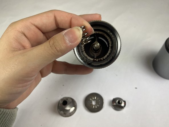

    • Pull out the spring around the shaft in the center of the grinder.

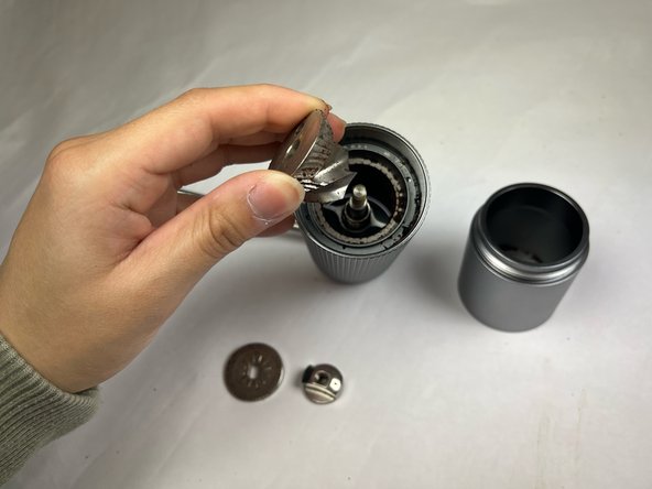

  9. How to Unjam and Clean a DiseZeit Z1M: crwdns2935265:09crwdnd2935265:01crwdnd2935265:01crwdne2935265:0
    • Check to see that the body of of the grinder has no more detachable parts in the center.
    • This image shows the parts you should have removed from the body of the grinder.

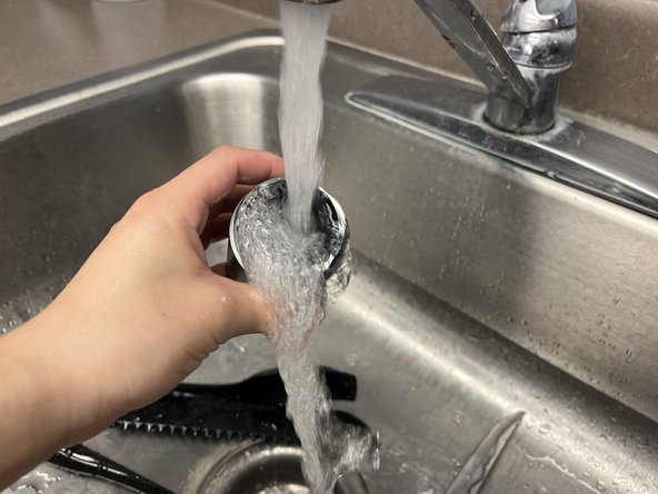

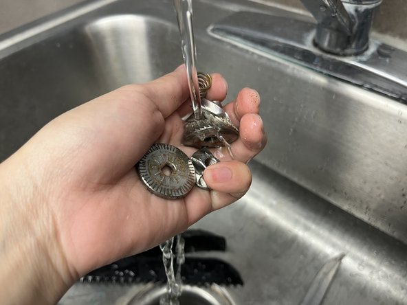

    • Gently wash the body of the grinder, the parts that were removed, and the base of the grinder that holds the coffee grounds using water and soap.
    • Make sure that all of the pieces are free of coffee bean residue before continuing.
    • Fully dry each part of the grinder before reassembling.

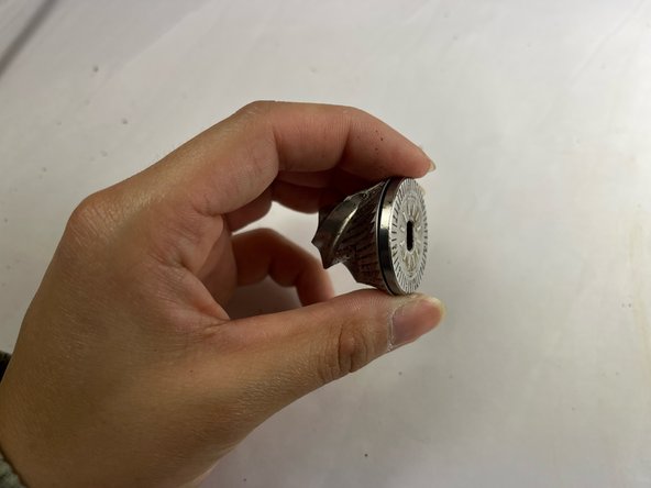

    • Put the parts of the coffee grinder back together by following steps 5 through 8 in reverse order.

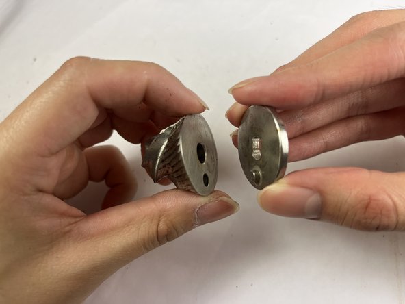

    • When putting the metal plate and the grinding burr back into the grinder, first make sure to align the hole in the grinding bur and the notch in the metal plate, put the two components together, and then put them into the grinder's body.
