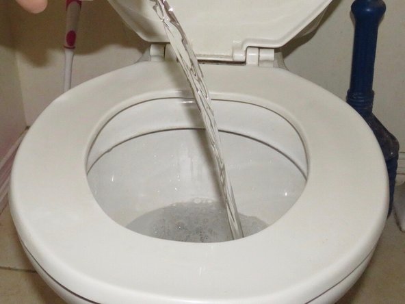

  2. How to Unclog a Toilet Without a Plunger: crwdns2935265:02crwdnd2935265:01crwdnd2935265:02crwdne2935265:0 How to Unclog a Toilet Without a Plunger: crwdns2935265:02crwdnd2935265:02crwdnd2935265:02crwdne2935265:0
    • Prepare a gallon of hot (not boiling) water.
    • The water temperature shouldn’t be too hot because it may cause the toilet bowl to crack.
  3. How to Unclog a Toilet Without a Plunger: crwdns2935265:03crwdnd2935265:01crwdnd2935265:02crwdne2935265:0 How to Unclog a Toilet Without a Plunger: crwdns2935265:03crwdnd2935265:02crwdnd2935265:02crwdne2935265:0
    • Divide the gallon of water into three separate containers.
    • Pour one portion of hot water into the toilet bowl and let it rest for about 20 minutes. Repeat for the other two portions of hot water.
