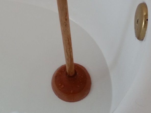

    • If you are unable to lift out the hair and larger items in your drain, consider using a plunger.
    • Cover the drain with a plunger and run the water in your bathtub or shower until it covers at least half of the plunger.
  5. How to Unclog a Shower Drain: crwdns2935265:05crwdnd2935265:01crwdnd2935265:02crwdne2935265:0 How to Unclog a Shower Drain: crwdns2935265:05crwdnd2935265:02crwdnd2935265:02crwdne2935265:0
    • Without breaking the seal of the plunger on the drain, push the plunger sharply down and up a few times.
  6. How to Unclog a Shower Drain: crwdns2935265:06crwdnd2935265:01crwdnd2935265:03crwdne2935265:0 How to Unclog a Shower Drain: crwdns2935265:06crwdnd2935265:02crwdnd2935265:03crwdne2935265:0 How to Unclog a Shower Drain: crwdns2935265:06crwdnd2935265:03crwdnd2935265:03crwdne2935265:0
    • Push down on the plunger again, but pull up sharply to break the seal.
    • This will hopefully dislodge what is clogging the drain. Any residual items may be removed as in step 3.

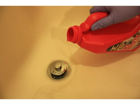

    • The chemicals in drain opener are very dangerous. Wear gloves to avoid the liquid touching your skin.
    • If you are unable to unclog your drain by hand, consider using liquid drain opener.
    • The drain opener you purchased should have instructions on the back which will tell you how much of the drain cleaner to use.
  8. How to Unclog a Shower Drain: crwdns2935265:08crwdnd2935265:01crwdnd2935265:02crwdne2935265:0 How to Unclog a Shower Drain: crwdns2935265:08crwdnd2935265:02crwdnd2935265:02crwdne2935265:0
    • Slowly pour the liquid drain opener down the drain, but avoid pouring the liquid on your shower floor and drain stopper.
    • If you were unable to remove the drain stopper, lift the stopper up as much as possible and follow the steps above.
  9. How to Unclog a Shower Drain: crwdns2935265:09crwdnd2935265:01crwdnd2935265:01crwdne2935265:0
    • Wait at least the time stated on your bottle of drain opener.
    • Different drain openers have different wait times, ranging from 10 minutes to 10 hours.
    • Regardless of the instructions, the longer you let the drain opener sit in your drain, the more effective it will be.

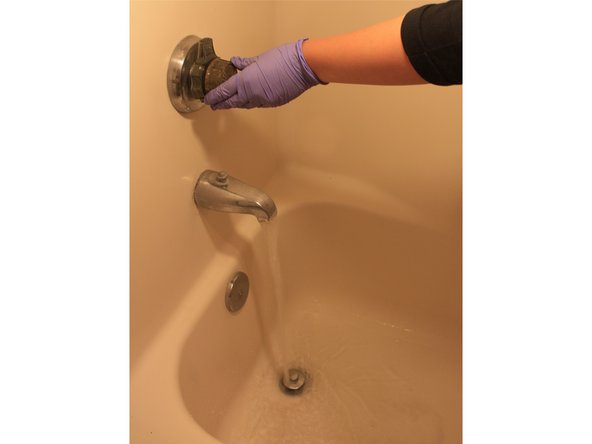

  10. How to Unclog a Shower Drain: crwdns2935265:010crwdnd2935265:01crwdnd2935265:02crwdne2935265:0 How to Unclog a Shower Drain: crwdns2935265:010crwdnd2935265:02crwdnd2935265:02crwdne2935265:0
    • After an appropriate amount of time, run hot water down the drain to flush out any remaining blockage.
To reassemble your drain stopper, follow the steps you took in step one in reverse order.
