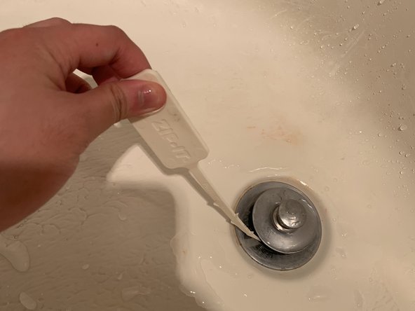

    • Remove the drain snake from it's packaging. Be sure to straighten out your drain snake as much as possible for ease of use.
    • Make sure that its edges are firm, or else it will not be able to snag the material easily.

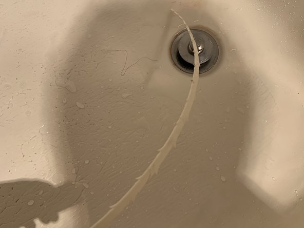

    • Stick your drain snake as deep into the drain gateway as you can. The further down you go, the greater the results. May also vary depending on status of drain.
  5. How to Unclog a Shower Drain: crwdns2935265:05crwdnd2935265:01crwdnd2935265:02crwdne2935265:0 How to Unclog a Shower Drain: crwdns2935265:05crwdnd2935265:02crwdnd2935265:02crwdne2935265:0
    • Spin and turn the drain snake around to gather as much material as you can.
    • After removing drain snake, extract all material from the snake and dispose of it in the garbage. Repeat this step until you have reached satisfactory results.

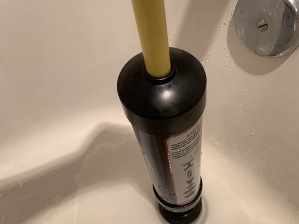

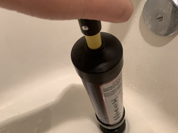

    • Take out your pump and a container full of warm water.
    • Extract water from your container and exert pressure into the drain to clean it out.
    • Repeat step a few times, and then test the status of your drain by starting up your bath tub and seeing if water flows naturally down the drain.
    • If everything goes as planned, your bath tub drain should be of good use again!
