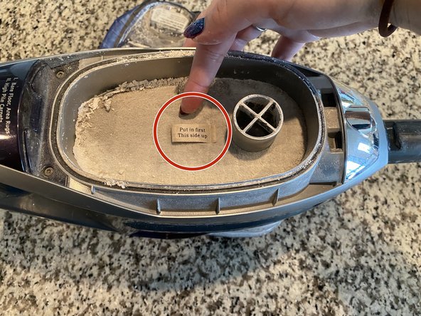

  3. How to Unclog a Shark Rocket Deluxe Pro Vacuum: crwdns2935265:03crwdnd2935265:01crwdnd2935265:02crwdne2935265:0 How to Unclog a Shark Rocket Deluxe Pro Vacuum: crwdns2935265:03crwdnd2935265:02crwdnd2935265:02crwdne2935265:0

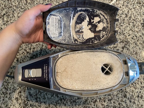

    • Pull the lever on top of the dust bin to expose the main filters.
  4. How to Unclog a Shark Rocket Deluxe Pro Vacuum: crwdns2935265:04crwdnd2935265:01crwdnd2935265:03crwdne2935265:0 How to Unclog a Shark Rocket Deluxe Pro Vacuum: crwdns2935265:04crwdnd2935265:02crwdnd2935265:03crwdne2935265:0 How to Unclog a Shark Rocket Deluxe Pro Vacuum: crwdns2935265:04crwdnd2935265:03crwdnd2935265:03crwdne2935265:0

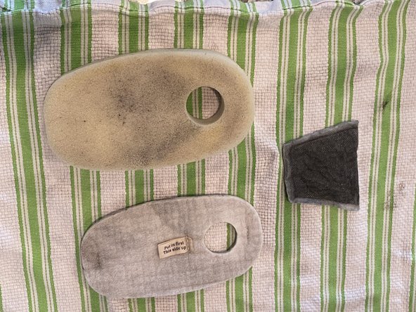

    • Carefully squeeze and remove the top filter.
    • Underneath that filter is a second filter. Pull the tab to remove it.

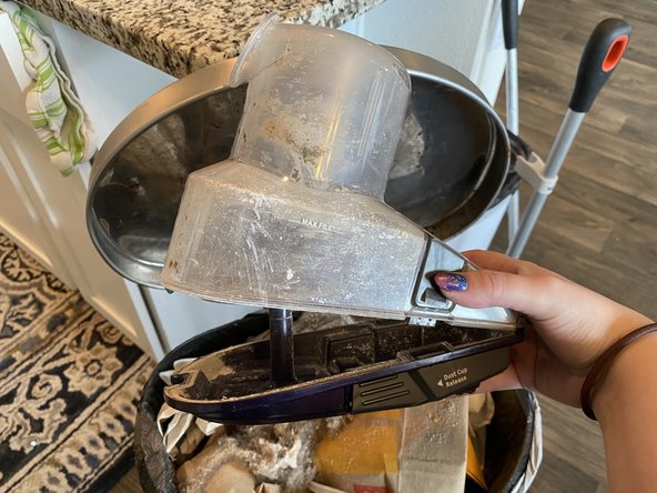

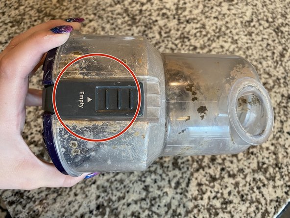

  5. How to Unclog a Shark Rocket Deluxe Pro Vacuum: crwdns2935265:05crwdnd2935265:01crwdnd2935265:03crwdne2935265:0 How to Unclog a Shark Rocket Deluxe Pro Vacuum: crwdns2935265:05crwdnd2935265:02crwdnd2935265:03crwdne2935265:0 How to Unclog a Shark Rocket Deluxe Pro Vacuum: crwdns2935265:05crwdnd2935265:03crwdnd2935265:03crwdne2935265:0

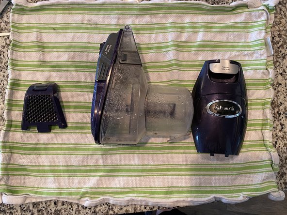

    • Squeeze the release on the bottom of the dustbin.
    • Remove the dust bin from the base.
    • Pop the lid open using the slider.
    • Empty the dust bin into the trash.

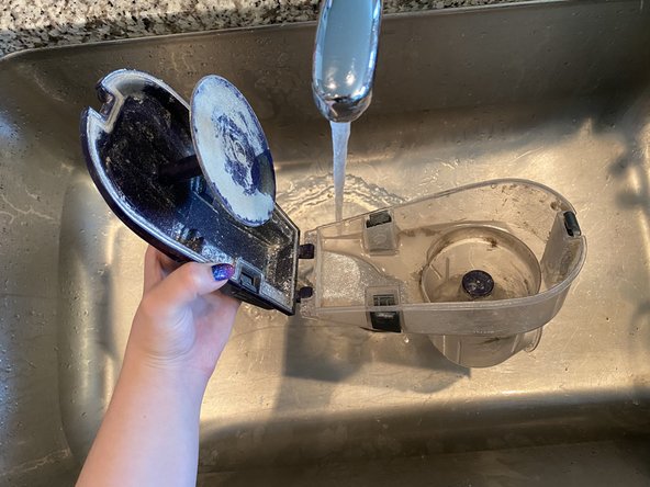

  6. How to Unclog a Shark Rocket Deluxe Pro Vacuum: crwdns2935265:06crwdnd2935265:01crwdnd2935265:03crwdne2935265:0 How to Unclog a Shark Rocket Deluxe Pro Vacuum: crwdns2935265:06crwdnd2935265:02crwdnd2935265:03crwdne2935265:0 How to Unclog a Shark Rocket Deluxe Pro Vacuum: crwdns2935265:06crwdnd2935265:03crwdnd2935265:03crwdne2935265:0
    • Rinse and wipe the plastic pieces removed earlier.
    • Do not use soap.
    • Set the pieces aside to air-dry.

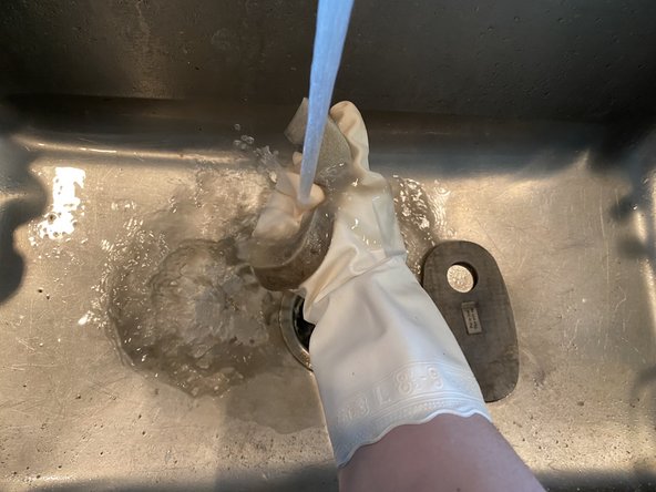

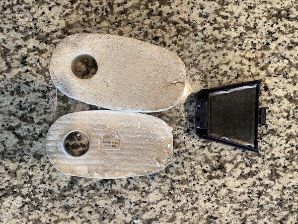

  7. How to Unclog a Shark Rocket Deluxe Pro Vacuum: crwdns2935265:07crwdnd2935265:01crwdnd2935265:03crwdne2935265:0 How to Unclog a Shark Rocket Deluxe Pro Vacuum: crwdns2935265:07crwdnd2935265:02crwdnd2935265:03crwdne2935265:0 How to Unclog a Shark Rocket Deluxe Pro Vacuum: crwdns2935265:07crwdnd2935265:03crwdnd2935265:03crwdne2935265:0
    • Place the filters in your sink and rinse out the dirt.
    • Squeeze out any excess water and allow them to air-dry overnight before reinstalling.
    • DO NOT USE SOAP.

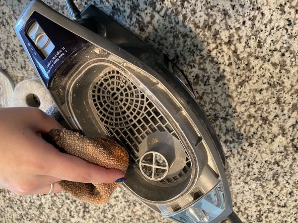

  8. How to Unclog a Shark Rocket Deluxe Pro Vacuum: crwdns2935265:08crwdnd2935265:01crwdnd2935265:03crwdne2935265:0 How to Unclog a Shark Rocket Deluxe Pro Vacuum: crwdns2935265:08crwdnd2935265:02crwdnd2935265:03crwdne2935265:0 How to Unclog a Shark Rocket Deluxe Pro Vacuum: crwdns2935265:08crwdnd2935265:03crwdnd2935265:03crwdne2935265:0

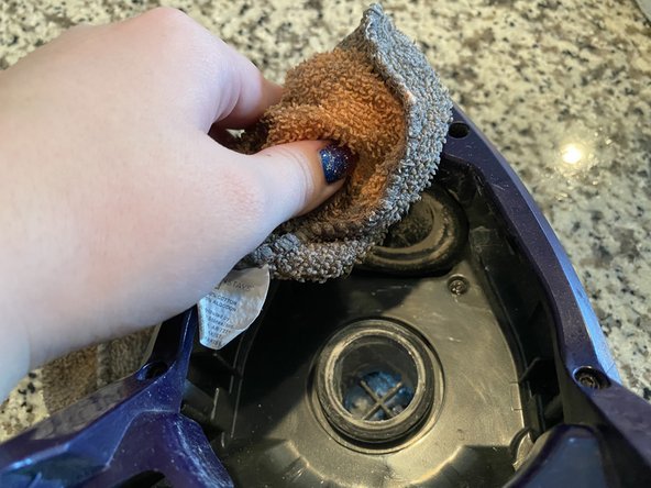

    • With a wet rag wipe out any dirt buildup on the vacuum casing.

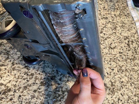

  9. How to Unclog a Shark Rocket Deluxe Pro Vacuum: crwdns2935265:09crwdnd2935265:01crwdnd2935265:03crwdne2935265:0 How to Unclog a Shark Rocket Deluxe Pro Vacuum: crwdns2935265:09crwdnd2935265:02crwdnd2935265:03crwdne2935265:0 How to Unclog a Shark Rocket Deluxe Pro Vacuum: crwdns2935265:09crwdnd2935265:03crwdnd2935265:03crwdne2935265:0

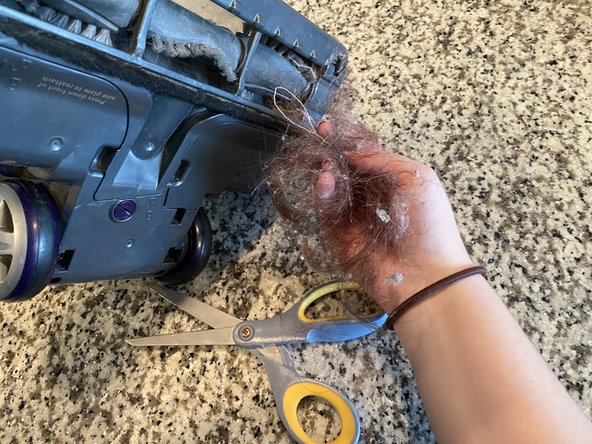

    • Turn the base of the vacuum on its side.
    • With your scissors, cut any wrapped hairs or strings that may be stuck on the rollers.

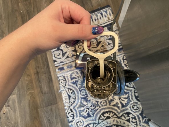

    • Lastly, insert your drain snake into the tube of the vacuum to dislodge any large stuck items.
