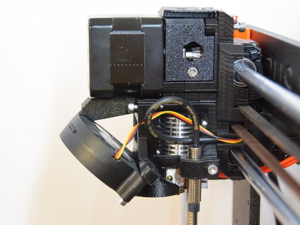

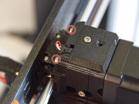

    • Remove the top right M3x14 heatsink fan screw.
    • Remove the bottom right M3x20 heatsink fan screw.
    • Loosen but do not remove the M3x14 screws located under the extruder motor.
    • Loosen but do not remove the M3x14 screws located at the top behind the extruder feeder.

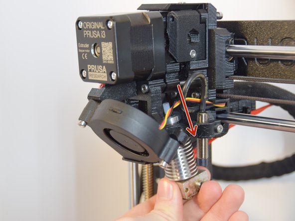

    • Ensure that the extruder motor cable has enough slack to be pulled apart.
    • With the heatsink fan screws removed, gently pull apart the extruder encasing.

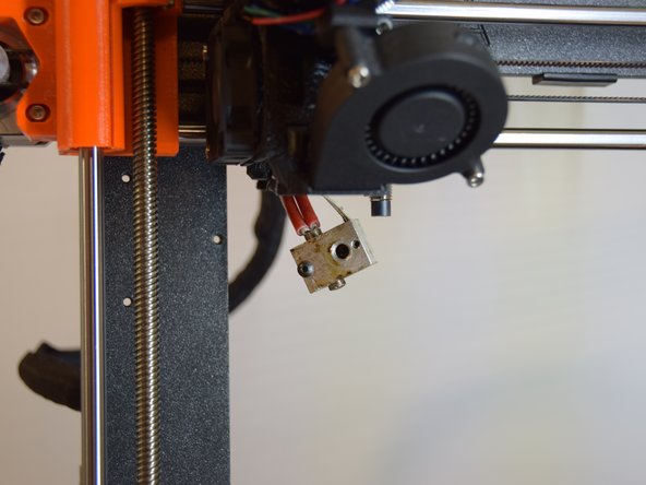

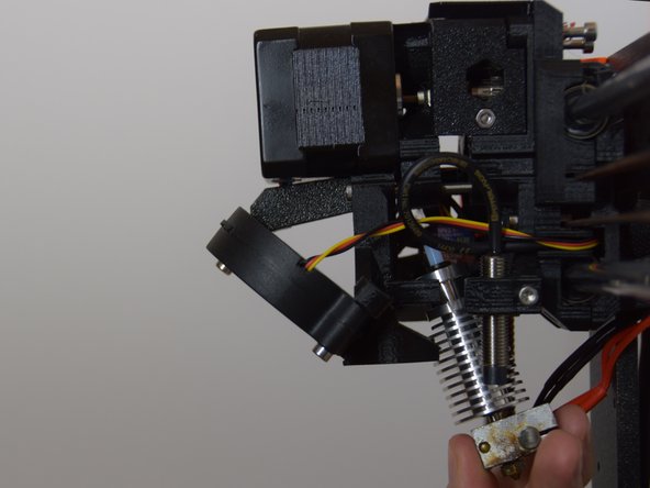

    • When the hotend is cool to the touch, gently remove it from its encasing.
  5. How to Unclog a Prusa i3 MK3 Nozzle: crwdns2935265:05crwdnd2935265:01crwdnd2935265:03crwdne2935265:0 How to Unclog a Prusa i3 MK3 Nozzle: crwdns2935265:05crwdnd2935265:02crwdnd2935265:03crwdne2935265:0 How to Unclog a Prusa i3 MK3 Nozzle: crwdns2935265:05crwdnd2935265:03crwdnd2935265:03crwdne2935265:0
    • Be careful with the cables attached to the hotend; too much stress on them can rip them off.

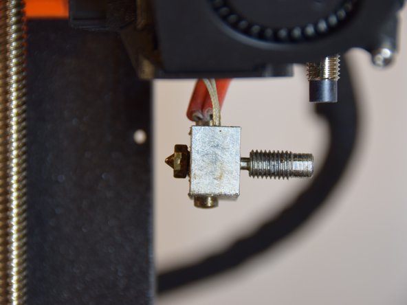

    • Unscrew and remove the heatsink from the hotend.
  6. How to Unclog a Prusa i3 MK3 Nozzle: crwdns2935265:06crwdnd2935265:01crwdnd2935265:03crwdne2935265:0 How to Unclog a Prusa i3 MK3 Nozzle: crwdns2935265:06crwdnd2935265:02crwdnd2935265:03crwdne2935265:0 How to Unclog a Prusa i3 MK3 Nozzle: crwdns2935265:06crwdnd2935265:03crwdnd2935265:03crwdne2935265:0
    • Heat up the nozzle to 285 degrees Celsius. The heat will cause the block to expand and allow you to safely remove the parts.
    • While gripping the block, unscrew the nozzle.

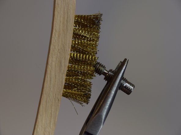

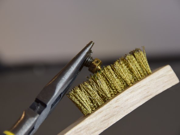

    • Watch out for the brush being used to clean the nozzle; if the metal of the brush is harder than the nozzle then it will damage the nozzle.
    • A brass brush is being used on the copper nozzle here so that no damage is caused. A brass brush will work fine for most nozzles but research your nozzle's metal to ensure that no damage is done to it.
    • Clean the nozzle with a metal brush.

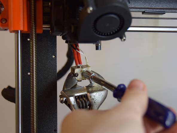

    • Grip the heatblock with the wrench.
    • Gently unscrew the heatsink thread.
    • Clean the heatsink thread with the brush.

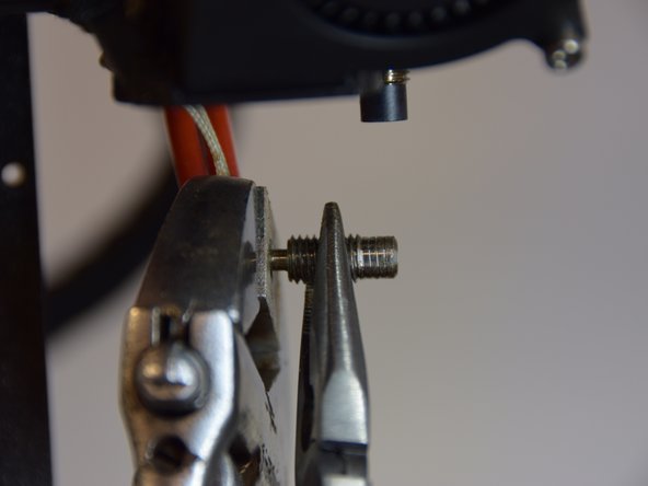

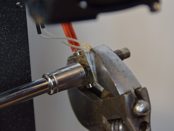

    • Heat the nozzle's temperature to 285 degrees Celsius for the heatblock to expand and grip it with a wrench.
    • Gently reattach the heatsink thread with your pliers, leaving some slack so that it is not flush with the heatblock.
    • Re-screw the cleaned nozzle but leave a gap between the nozzle and heatblock.
    • Screw the heatsink thread until it is flush with the heatblock.
    • Tighten the nozzle once again until you feel the that the nozzle's thread is touching the heatsink thread to ensure that filament does not build up in the heatblock threads.
