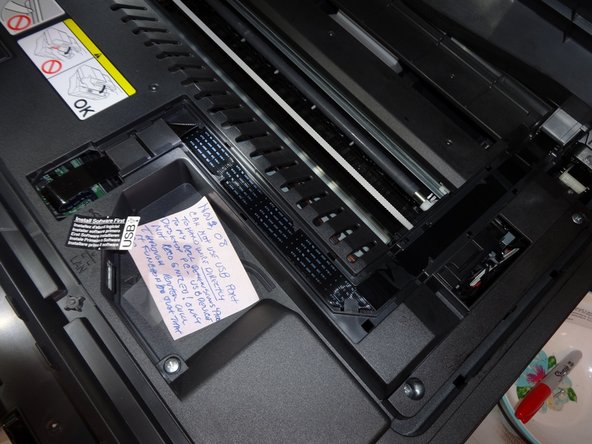

    • Tape the top part of the printer and scanner together
    • *note : I started with the paper trays already removed
  2. How to Unclog Brother Inkjet Print head Nozzles: crwdns2935265:02crwdnd2935265:01crwdnd2935265:03crwdne2935265:0 How to Unclog Brother Inkjet Print head Nozzles: crwdns2935265:02crwdnd2935265:02crwdnd2935265:03crwdne2935265:0 How to Unclog Brother Inkjet Print head Nozzles: crwdns2935265:02crwdnd2935265:03crwdnd2935265:03crwdne2935265:0

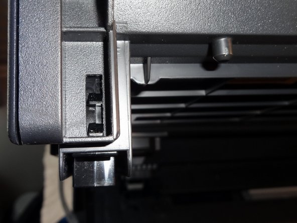

  4. How to Unclog Brother Inkjet Print head Nozzles: crwdns2935265:04crwdnd2935265:01crwdnd2935265:03crwdne2935265:0 How to Unclog Brother Inkjet Print head Nozzles: crwdns2935265:04crwdnd2935265:02crwdnd2935265:03crwdne2935265:0 How to Unclog Brother Inkjet Print head Nozzles: crwdns2935265:04crwdnd2935265:03crwdnd2935265:03crwdne2935265:0

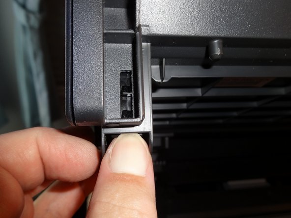

    • Remove the support arm
    • Press the tab to release the clips, then when it's out gently pull towards you to release the back
  5. How to Unclog Brother Inkjet Print head Nozzles: crwdns2935265:05crwdnd2935265:01crwdnd2935265:03crwdne2935265:0 How to Unclog Brother Inkjet Print head Nozzles: crwdns2935265:05crwdnd2935265:02crwdnd2935265:03crwdne2935265:0 How to Unclog Brother Inkjet Print head Nozzles: crwdns2935265:05crwdnd2935265:03crwdnd2935265:03crwdne2935265:0

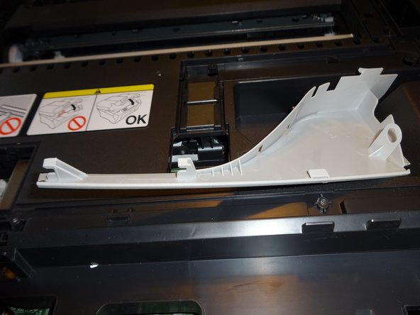

    • Remove the cover on the right side exposing the ribbon cable gently use the twizzers in the tabs to release it
    • Unplug the ribbon cable and slid it out
    • *note for reassembly: the ribbon cable placement holders can be removed to make it easier to re-thread the ribbon cable by gently pushing down the tabs with the spudger

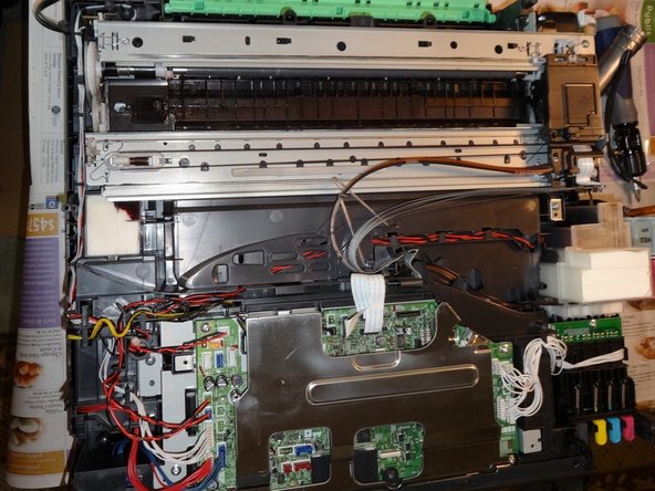

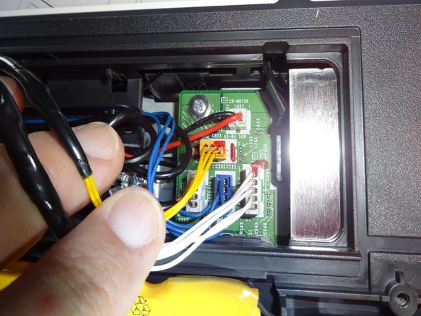

    • Remove the Panel on the left side exposing the wiring connectors for the top of the printer
    • After dissconecting the connectors remove the whole top of the printer and place it safely out of the way

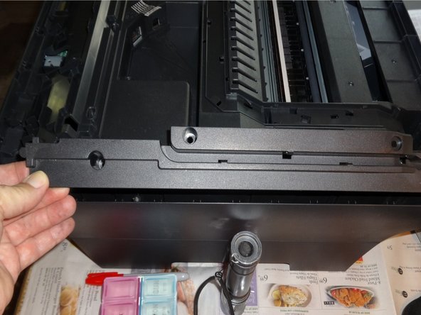

    • Remove the 15 screws to the cover
    • Remove the left and right side covers
  8. How to Unclog Brother Inkjet Print head Nozzles, Remove the front corners by gently pulling upwards: crwdns2935265:08crwdnd2935265:01crwdnd2935265:02crwdne2935265:0 How to Unclog Brother Inkjet Print head Nozzles, Remove the front corners by gently pulling upwards: crwdns2935265:08crwdnd2935265:02crwdnd2935265:02crwdne2935265:0
    • Remove the front corners by gently pulling upwards
    • Open the back paper jam cover.
  9. How to Unclog Brother Inkjet Print head Nozzles, Remove the Red conectors for the battery and speaker: crwdns2935265:09crwdnd2935265:01crwdnd2935265:02crwdne2935265:0 How to Unclog Brother Inkjet Print head Nozzles, Remove the Red conectors for the battery and speaker: crwdns2935265:09crwdnd2935265:02crwdnd2935265:02crwdne2935265:0
    • Lift off the cover and put aside out of the way
  10. How to Unclog Brother Inkjet Print head Nozzles, Release the clear print head guide wire: crwdns2935265:010crwdnd2935265:01crwdnd2935265:03crwdne2935265:0 How to Unclog Brother Inkjet Print head Nozzles, Release the clear print head guide wire: crwdns2935265:010crwdnd2935265:02crwdnd2935265:03crwdne2935265:0 How to Unclog Brother Inkjet Print head Nozzles, Release the clear print head guide wire: crwdns2935265:010crwdnd2935265:03crwdnd2935265:03crwdne2935265:0

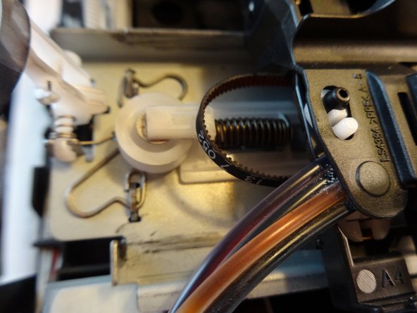

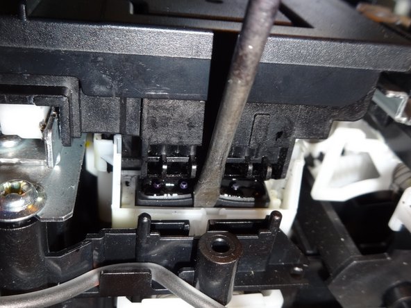

  11. How to Unclog Brother Inkjet Print head Nozzles, Releasing the print head from the carriage: crwdns2935265:011crwdnd2935265:01crwdnd2935265:03crwdne2935265:0 How to Unclog Brother Inkjet Print head Nozzles, Releasing the print head from the carriage: crwdns2935265:011crwdnd2935265:02crwdnd2935265:03crwdne2935265:0 How to Unclog Brother Inkjet Print head Nozzles, Releasing the print head from the carriage: crwdns2935265:011crwdnd2935265:03crwdnd2935265:03crwdne2935265:0
    • Using a spudger, press down on the plastic housing of the park carriage that the print head rests on.
    • Slide the print head to the left freeing it to move
  12. How to Unclog Brother Inkjet Print head Nozzles, Removing the print head from the rails: crwdns2935265:012crwdnd2935265:01crwdnd2935265:03crwdne2935265:0 How to Unclog Brother Inkjet Print head Nozzles, Removing the print head from the rails: crwdns2935265:012crwdnd2935265:02crwdnd2935265:03crwdne2935265:0 How to Unclog Brother Inkjet Print head Nozzles, Removing the print head from the rails: crwdns2935265:012crwdnd2935265:03crwdnd2935265:03crwdne2935265:0
    • Slide the print head left until it is at the end of the rail. You can feel it release (lift upwards when it aligns with the cut out notch)
    • Push the print head unit towards the back of the device and lift the unit from the back rail

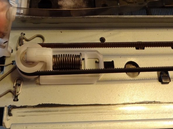

    • Using the spudger, press the spring section of the white pulley
    • Release the conveyor from the pulley while the spring is still compressed
    • Remove the conveyor from the gear on the other side of the device

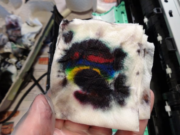

    • How to clean with paper towel
    • Tear a single sheet of paper towel in half. Fold the sheet in half several times until it is about 1/2 inch wide.
    • Put a few drops of distilled water on top of the paper towel and lay it in the trough under the print head,. Move the print head over the towel and let it sit for at least 15 minutes. This will soften the ink on the print head.
    • Move print head assembly back to its resting position. You will probably notice that the paper towel now has one big black blob of ink on it. (There is so much excess ink on the print head that all the colors are mixing to make black.)
    • If you cannot clearly see individual colors, then dampen another spot on the paper towel and move the print head back over the newly dampened spot on the paper towel. Continue repeating this until you see all the individual colors.
    • *note: when reassembling be certain to move the print head back to its resting position (the extreme right side above the park carriage)

Thanks for the guide. But I don't think you need to tear apart the printer to do that, just start a print cycle and when the printhead moves, plug the printer off. then you can freely move the printhead and put the paper towel under it.
Filipe Silva - crwdns2934203:0crwdne2934203:0
Thank you! Thank you! I was getting no magenta ink at all - I tried this, took me 2 minutes and viola! It works perfectly now! Thank you!!!!!
Kris Smith -
Yes! Best comment ever! Saved me so much work. Let it sit 15 mins, instant success did 1 Cleaning and perfect printing.
