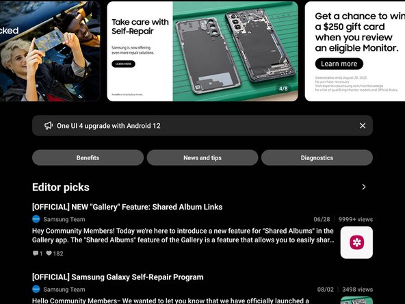

How to Test Your Samsung Device After a Repair
    1. How to Test Your Samsung Device After a Repair, Download the app: crwdns2935265:01crwdnd2935265:01crwdnd2935265:02crwdne2935265:0 How to Test Your Samsung Device After a Repair, Download the app: crwdns2935265:01crwdnd2935265:02crwdnd2935265:02crwdne2935265:0
      • Download the Samsung Members app on the Play Store or the Galaxy Store
      • Select the Samsung Members app.
    2. How to Test Your Samsung Device After a Repair, Agree to the terms and conditions: crwdns2935265:02crwdnd2935265:01crwdnd2935265:02crwdne2935265:0 How to Test Your Samsung Device After a Repair, Agree to the terms and conditions: crwdns2935265:02crwdnd2935265:02crwdnd2935265:02crwdne2935265:0
      • Select "Agree to all" to fill in the agreement checkmarks.
      • Select "Continue"
    3. How to Test Your Samsung Device After a Repair, Navigate to the test screen: crwdns2935265:03crwdnd2935265:01crwdnd2935265:02crwdne2935265:0 How to Test Your Samsung Device After a Repair, Navigate to the test screen: crwdns2935265:03crwdnd2935265:02crwdnd2935265:02crwdne2935265:0

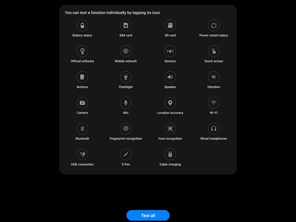

      • Select the "Diagnostics" tab near the top right of the screen.
    4. How to Test Your Samsung Device After a Repair, Select the test: crwdns2935265:04crwdnd2935265:01crwdnd2935265:02crwdne2935265:0 How to Test Your Samsung Device After a Repair, Select the test: crwdns2935265:04crwdnd2935265:02crwdnd2935265:02crwdne2935265:0
      • Depending on your device, you may have different tests available.
      • Select the test you would like to perform.
      • If you want to perform all of the tests, select "Test all"

Alternatively if the app is not supported or you don't want to sign in with a Samsung account, you can dial *#0*#
