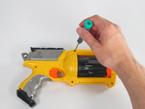

    • Use your hands/tools in each shot to demonstrate the action being performed.
    • Shoot in a first-person perspective. Try to set up each shot so that it matches what your readers will see.

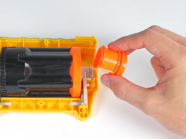

    • Zoom in to get detailed shots of actions, especially when performing smaller or more intricate tasks.
    • If you zoom in too far, your readers may lose track of what they're looking at. Try to leave enough reference points in the photo so that readers can orient themselves.
    • In this example, the black "bullet" chamber is a good reference point. Without it, the action is still clear, but the location is not.

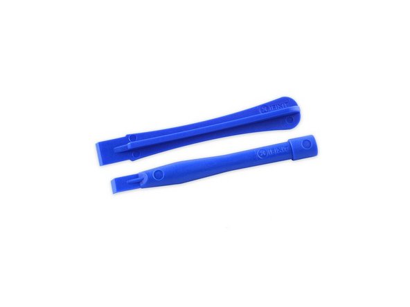

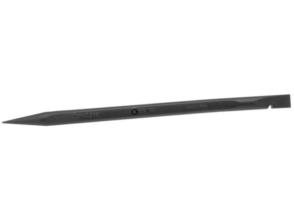

    • Don't use metal prying tools in your guides except as a last resort.
    • The nylon spudger and plastic opening tools included in your toolkit are ESD-safe and are less likely to cause cosmetic damage.
    • Only instruct your readers to use a metal spudger when safer tools aren't up to the task. Never use a screwdriver to pry open your device.
