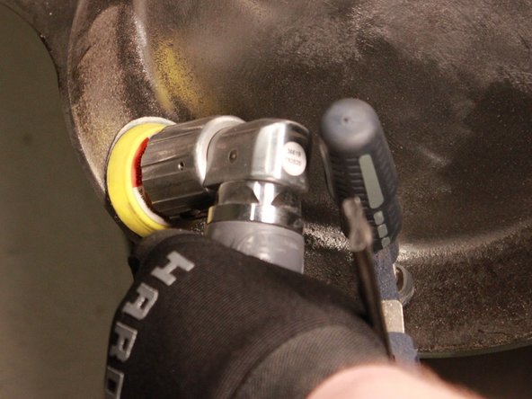

  2. How to Strip and Recoat a Cast Iron Skillet: crwdns2935265:02crwdnd2935265:01crwdnd2935265:03crwdne2935265:0 How to Strip and Recoat a Cast Iron Skillet: crwdns2935265:02crwdnd2935265:02crwdnd2935265:03crwdne2935265:0 How to Strip and Recoat a Cast Iron Skillet: crwdns2935265:02crwdnd2935265:03crwdnd2935265:03crwdne2935265:0
    • Grind off the black coating of the entire surface to expose the shiny bare metal.
    • Make sure to have on all your safety equipment for this process.
  3. How to Strip and Recoat a Cast Iron Skillet: crwdns2935265:03crwdnd2935265:01crwdnd2935265:03crwdne2935265:0 How to Strip and Recoat a Cast Iron Skillet: crwdns2935265:03crwdnd2935265:02crwdnd2935265:03crwdne2935265:0 How to Strip and Recoat a Cast Iron Skillet: crwdns2935265:03crwdnd2935265:03crwdnd2935265:03crwdne2935265:0
    • Sand the entire surface of the cast iron skillet to smooth any rough spots left.

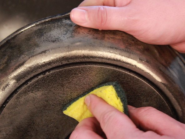

    • Rinse the cast iron skillet with water.
    • Scrub the cast iron skillet with a sponge to remove any excess metal shavings.

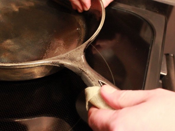

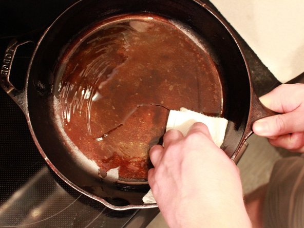

  5. How to Strip and Recoat a Cast Iron Skillet: crwdns2935265:05crwdnd2935265:01crwdnd2935265:02crwdne2935265:0 How to Strip and Recoat a Cast Iron Skillet: crwdns2935265:05crwdnd2935265:02crwdnd2935265:02crwdne2935265:0
    • Apply an even coating of high heat oil to every part of your cast iron skillet.

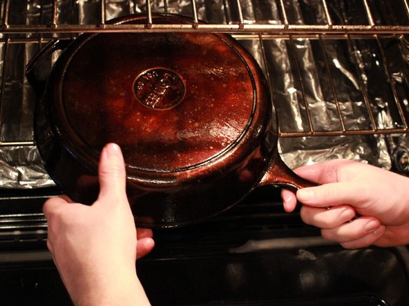

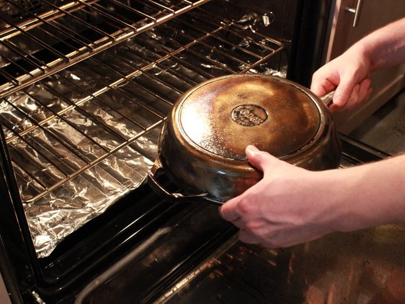

    • Wrap the bottom rack of the oven with aluminum foil.
    • Place the cast iron skillet upside down on the rack above the foil.
    • Bake for 1 hour in a preheated oven of 500°F (260°C) or whatever the highest temperature your oven reaches.
    • Let the cast iron skillet cool completely after baking.
