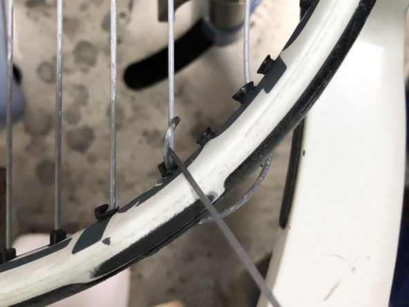

    2. How to String a Tennis Racket, Place the frame into a stringing machine: crwdns2935265:02crwdnd2935265:01crwdnd2935265:01crwdne2935265:0
      • Place the frame into a stringing machine by screwing in the four main screws and pulling the racket tight.
    3. How to String a Tennis Racket, Insert the main vertical string into the head of the racquet: crwdns2935265:03crwdnd2935265:01crwdnd2935265:03crwdne2935265:0 How to String a Tennis Racket, Insert the main vertical string into the head of the racquet: crwdns2935265:03crwdnd2935265:02crwdnd2935265:03crwdne2935265:0 How to String a Tennis Racket, Insert the main vertical string into the head of the racquet: crwdns2935265:03crwdnd2935265:03crwdnd2935265:03crwdne2935265:0
      • Insert the main vertical string into the head of the racket, and thread it down to the neck of the racket and back to the head.
      • Pull and tighten the first main string into a tension rod.
      • The strings should always go under the racquet.
    4. How to String a Tennis Racket, Secure and tighten the end of the string: crwdns2935265:04crwdnd2935265:01crwdnd2935265:02crwdne2935265:0 How to String a Tennis Racket, Secure and tighten the end of the string: crwdns2935265:04crwdnd2935265:02crwdnd2935265:02crwdne2935265:0
      • Secure and tighten the end of the string by attaching it to the clamp and moving the rod into the horizontal position.
      • Fix the second string utilizing the second clamp and release the first string.
      • Continue threading the main strings and clamping the strings until all holes have been strung.
      • The stringing pattern: Insert and tighten the string, secure the next string with the clamp, and release the previous string.
    5. How to String a Tennis Racket, Knot the main string: crwdns2935265:05crwdnd2935265:01crwdnd2935265:02crwdne2935265:0 How to String a Tennis Racket, Knot the main string: crwdns2935265:05crwdnd2935265:02crwdnd2935265:02crwdne2935265:0
      • Knot the main string after you have secured all the main strings.
      • Release the tension rod and cut off the remaining string.
    6. How to String a Tennis Racket, Horizontal cross strings: crwdns2935265:06crwdnd2935265:01crwdnd2935265:01crwdne2935265:0
      • Insert the horizontal cross strings from the left to the right and back to the left.
      • Secure and tighten the end of the string by attaching it to the clamp and moving the rod into the vertical position.
      • Continue threading the cross strings and clamping the strings until all holes have been strung by applying the stringing pattern.
      • Weave the cross strings by going over and under repeatedly through the main strings.
    7. How to String a Tennis Racket, Knot all the cross strings: crwdns2935265:07crwdnd2935265:01crwdnd2935265:01crwdne2935265:0
      • Knot all of the cross strings after you have secured them.
