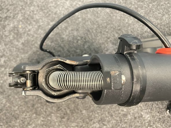

    • Slide the locking clip out from the base of the stem.
    • Unlock the clamp on the stem.

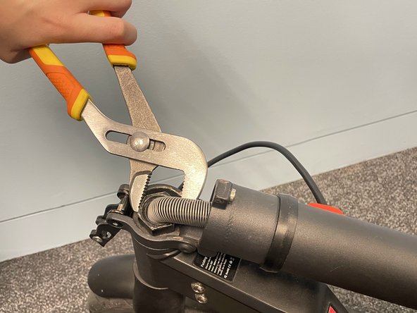

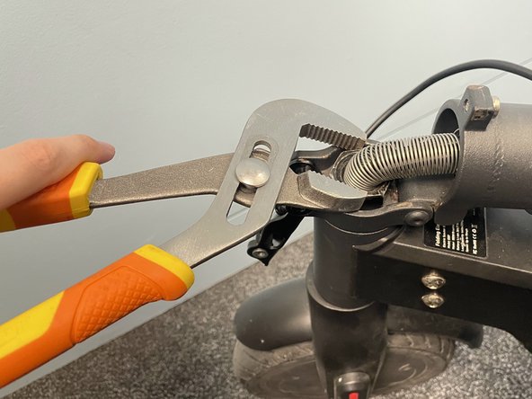

    • Using an adjustable wrench, carefully tighten the bolt at the base of the stem.
    • This will make the stem stable.
    • Do not use the wrench on the spring between the stem and the bolt as it may damage the wires beneath.

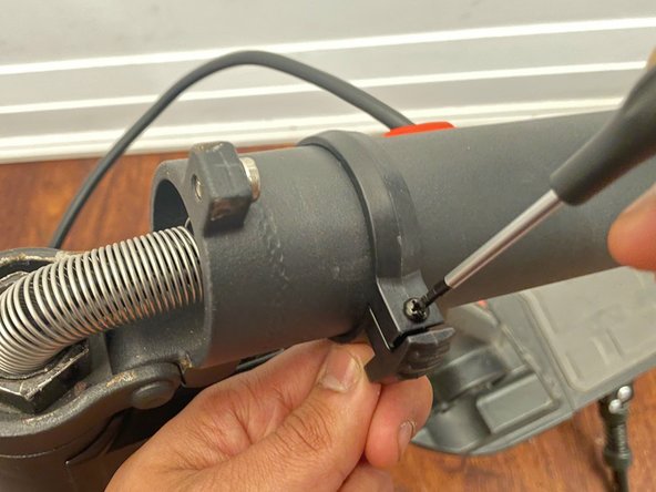

    • Using a slotted/flathead screwdriver, carefully tighten the screw on the clamp.
    • This will prevent the clamp from popping open.

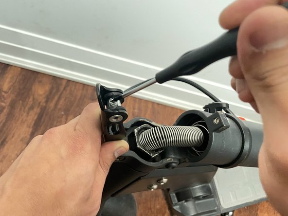

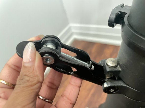

  6. How to Stabilize the Stem of a Longwise ES06 E-Scooter: crwdns2935265:06crwdnd2935265:01crwdnd2935265:02crwdne2935265:0 How to Stabilize the Stem of a Longwise ES06 E-Scooter: crwdns2935265:06crwdnd2935265:02crwdnd2935265:02crwdne2935265:0
    • Use a Phillips #0 to tighten the screw on the locking clip.
    • This helps the clamp to stay in place and prevent it from popping open.
