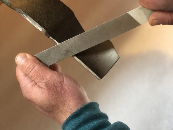

    • Secure the blade in a vise.
  7. How to Sharpen Troy-Bilt TB110 Lawnmower Blades: crwdns2935265:07crwdnd2935265:01crwdnd2935265:02crwdne2935265:0 How to Sharpen Troy-Bilt TB110 Lawnmower Blades: crwdns2935265:07crwdnd2935265:02crwdnd2935265:02crwdne2935265:0
    • Sharpen the blade with a file or with a grinder. Follow the angle that is already established and move the file along until the edge becomes sharp.
    • Be carful when checking for sharpness. You can very gently run your finger along the edge to check.
    • The blade does not need to be as sharp as a razor blade. Try to make it as sharp as pair of scissors. Check the lawnmower for specific details.
