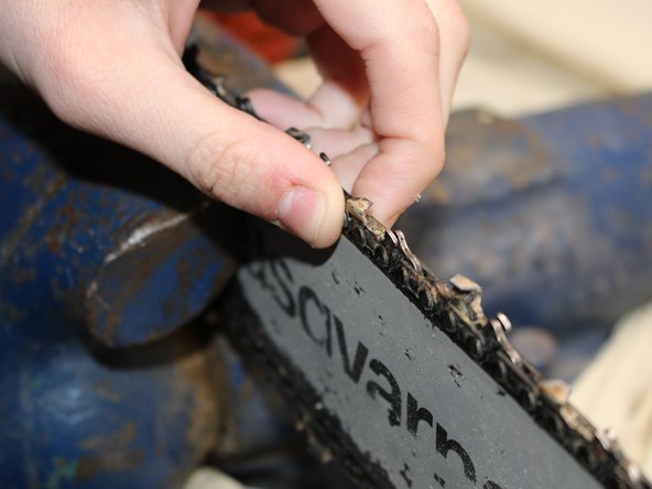

    • Remove the drill-bit from the drill and insert the file in its place.
    • Tighten the file in place by spinning the drill's head near the base of the file.
  2. How to Sharpen Chainsaw Teeth: crwdns2935265:02crwdnd2935265:01crwdnd2935265:03crwdne2935265:0 How to Sharpen Chainsaw Teeth: crwdns2935265:02crwdnd2935265:02crwdnd2935265:03crwdne2935265:0 How to Sharpen Chainsaw Teeth: crwdns2935265:02crwdnd2935265:03crwdnd2935265:03crwdne2935265:0
    • Stabilize the chainsaw using a mounted clamp.
    • Tighten the clamp until you no longer need to stabilize the chainsaw yourself.

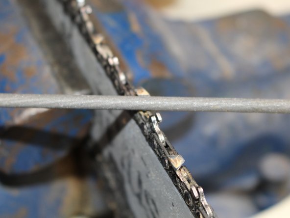

  3. How to Sharpen Chainsaw Teeth: crwdns2935265:03crwdnd2935265:01crwdnd2935265:03crwdne2935265:0 How to Sharpen Chainsaw Teeth: crwdns2935265:03crwdnd2935265:02crwdnd2935265:03crwdne2935265:0 How to Sharpen Chainsaw Teeth: crwdns2935265:03crwdnd2935265:03crwdnd2935265:03crwdne2935265:0

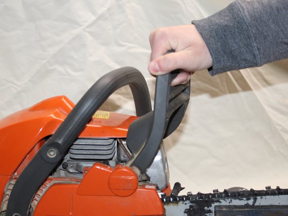

    • Inspect the tooth and determine which angle to position the file for sharpening. Make sure that the whole tooth of the blade is flat against the file.
    • Pull the clutch down to lock the chain in place.
    • Doing this will prevent it from moving when the chain is being sharpened.

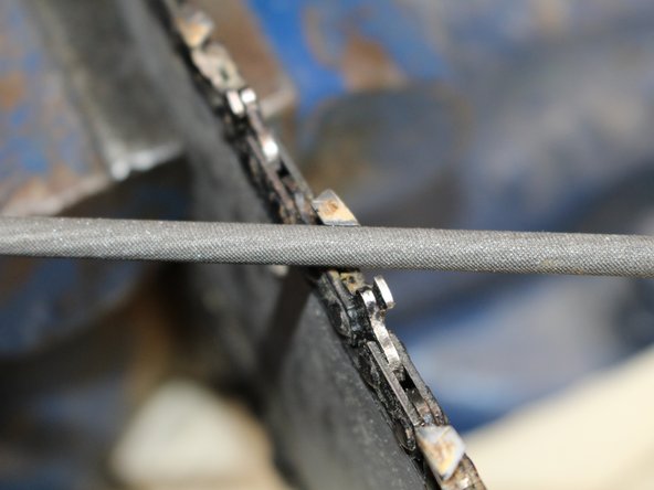

    • Use the power drill to spin the file, and slowly move the file along the edge of the tooth. Make sure that light pressure is placed against the tooth. File until sharp.
  4. How to Sharpen Chainsaw Teeth: crwdns2935265:05crwdnd2935265:01crwdnd2935265:03crwdne2935265:0 How to Sharpen Chainsaw Teeth: crwdns2935265:05crwdnd2935265:02crwdnd2935265:03crwdne2935265:0 How to Sharpen Chainsaw Teeth: crwdns2935265:05crwdnd2935265:03crwdnd2935265:03crwdne2935265:0
    • Unlock the clutch and position the chain of the blade so that the next tooth can be sharpened. Redo steps 4 and 5.
    • Do this for all teeth facing that side.
