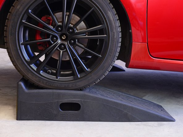

    • Slide the first ramp directly in front of the vehicle's front, driver-side wheel, until it touches the rubber of the tire.
  3. How to Safely Raise a Vehicle Using Ramps: crwdns2935265:03crwdnd2935265:01crwdnd2935265:01crwdne2935265:0
    • Put the second ramp into position directly in front of the vehicle's front, passenger-side wheel.
  4. How to Safely Raise a Vehicle Using Ramps: crwdns2935265:04crwdnd2935265:01crwdnd2935265:01crwdne2935265:0
    • Make sure each ramp is centered in the path of the tire so that once the vehicle moves forward, both wheels will stay completely supported by the ramps.

    • Continue driving slowly up the ramps until your vehicle levels out, and then stop immediately.
    • You can either find the correct place to stop purely by feel, or you can have a friend spot you from outside the vehicle.
    • Most automotive ramps have a slight dip at the top, or a bump stop, or both, to help stabilize the vehicle with the wheels in the correct position.
    • If you don't make it all the way up the ramps on the first try, that's okay—it can take several tries to get a feel for how the vehicle responds on the ramps. Let it roll back down, stop at the bottom, reposition the ramps and try again.

    • Chock the rear wheels to prevent the vehicle from rolling backwards down the ramps.
When your repair is complete, remove the wheel chocks and any other tools/obstructions before carefully backing your vehicle down and off the ramps.

What ramps are being used in the pictures?
Andrew Morgan - crwdns2934203:0crwdne2934203:0
