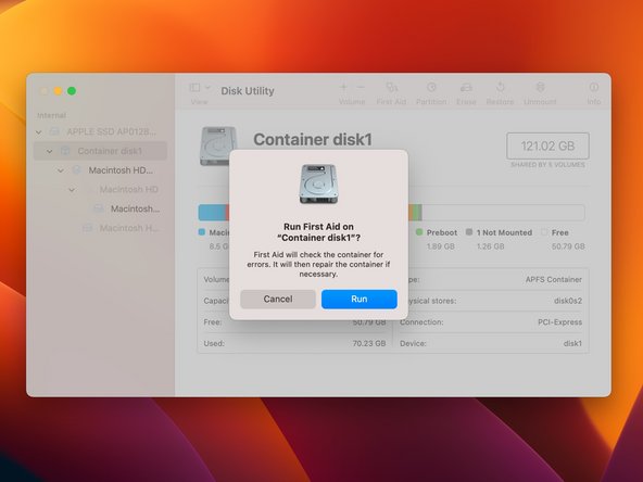

How to Run First Aid with Disk Utility
First Aid is a great tool for helping fix various issues relating to replacing parts on a Mac.

      • Click on the First Aid button at the top of the window.
      • A dialogue box will appear asking if you would like to run First Aid.
      • Click "Run".
      • A second dialogue box will pop up prompting for acknowledgement that verifying your startup disk will cause it to be non-responsive.
      • Click “Continue”.
    5. How to Run First Aid with Disk Utility: crwdns2935265:05crwdnd2935265:01crwdnd2935265:03crwdne2935265:0 How to Run First Aid with Disk Utility: crwdns2935265:05crwdnd2935265:02crwdnd2935265:03crwdne2935265:0 How to Run First Aid with Disk Utility: crwdns2935265:05crwdnd2935265:03crwdnd2935265:03crwdne2935265:0
      • This procedure will take a few minutes to complete. The machine may freeze up, or lock up during this procedure.
      • Patience is key here.
      • Disk repair may fail, or give an error message. Restart your machine and run it again if this is the case, it may repair further issues.
      • Once completed, click done.
      • Pro Tip: To see the entire process including corrected errors, click on the arrow next to 'Show Details'.
      • Repeat this on all items in the Disk Utility list for your internal drive. Move upward through the list. Order of operations is all volumes first, then the container and finally the disk itself.
    6. How to Run First Aid with Disk Utility: crwdns2935265:06crwdnd2935265:01crwdnd2935265:01crwdne2935265:0
      • If you continue to receive errors, repeat this process using the Disk Utility function in Internet Recovery.
Close Disk Utility, and the internal drive should be ready to go.
