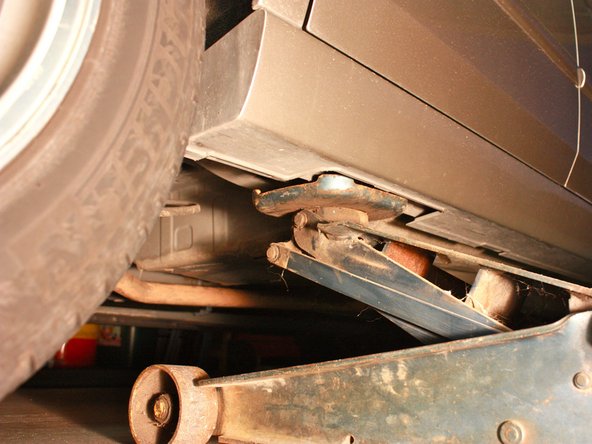

    1. How to Rotate Your Tires, Using a Floor Jack: crwdns2935265:01crwdnd2935265:01crwdnd2935265:02crwdne2935265:0 How to Rotate Your Tires, Using a Floor Jack: crwdns2935265:01crwdnd2935265:02crwdnd2935265:02crwdne2935265:0
      • Place the hydraulic floor jack under the vehicle until the saddle is directly under the crossmember.
      • The crossmember is the long metal support beam that runs underneath from the front fender to the rear fender on both sides of the car.
      • The saddle is the round metal part of the jack that moves upward as you pump the jack up.
    2. How to Rotate Your Tires, Using floor jack to lift car.: crwdns2935265:02crwdnd2935265:01crwdnd2935265:01crwdne2935265:0
      • Push downward on the jack's lever to lift the saddle upward so that it contacts the crossmember. Continue pushing downward on the lever to lift the car upward.

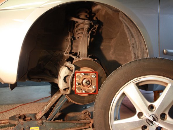

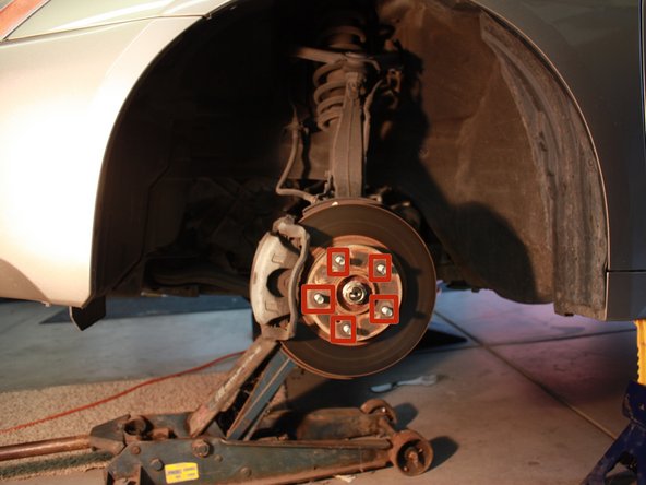

    1. How to Rotate Your Tires, How to Rotate Your Tires: crwdns2935265:05crwdnd2935265:01crwdnd2935265:01crwdne2935265:0
      • Once the car is raised, remove the lug nuts with the ratchet attached to a 3/4'' socket.
      • It may be a good idea to initially loosen the lug nuts while the wheels are still on the ground, that way you'll get plenty of leverage without the wheel spinning.
    2. How to Rotate Your Tires: crwdns2935265:06crwdnd2935265:01crwdnd2935265:03crwdne2935265:0 How to Rotate Your Tires: crwdns2935265:06crwdnd2935265:02crwdnd2935265:03crwdne2935265:0 How to Rotate Your Tires: crwdns2935265:06crwdnd2935265:03crwdnd2935265:03crwdne2935265:0
      • Remove the tire off the wheel studs and place it aside.
      • The wheel studs are the metal bolts sticking out of the wheel hub in the center.
