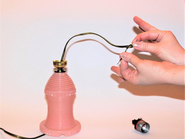

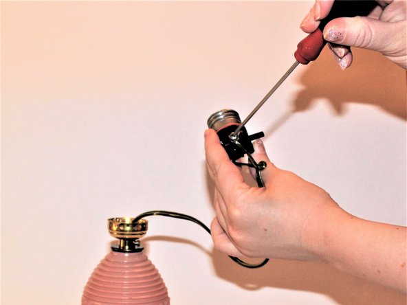

  5. How to Rewire a Lamp: crwdns2935265:05crwdnd2935265:01crwdnd2935265:03crwdne2935265:0 How to Rewire a Lamp: crwdns2935265:05crwdnd2935265:02crwdnd2935265:03crwdne2935265:0 How to Rewire a Lamp: crwdns2935265:05crwdnd2935265:03crwdnd2935265:03crwdne2935265:0
    • By hand, tie an underwriters knot in the cord.
    • Also by hand, connect the wires by wrapping them clockwise around the screws and tighten and connect the neutral wire to the silver screw.
    • An underwriter's knot prevents the wires from pulling out of the screw terminals when cord is tugged. ( The entire process of tying an underwriter knot can be done by hand . Form a loop using the first wire. Then, form a loop around the first wire and pass the tail through its loop. The strain on the cable is now taken by the knot.)
  6. How to Rewire a Lamp: crwdns2935265:06crwdnd2935265:01crwdnd2935265:03crwdne2935265:0 How to Rewire a Lamp: crwdns2935265:06crwdnd2935265:02crwdnd2935265:03crwdne2935265:0 How to Rewire a Lamp: crwdns2935265:06crwdnd2935265:03crwdnd2935265:03crwdne2935265:0
    • By hand, pull the excess cord down through the lamp.
    • Still using your hand, slip the insulation sleeve and socket shell over the socket and snap the shell into the base.
