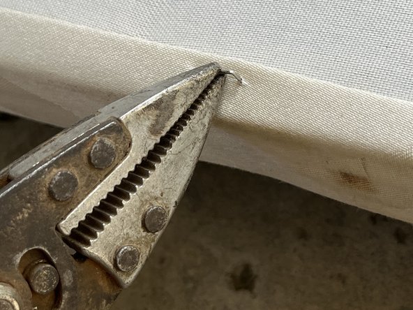

    • Lift the staples with the flathead screwdriver before going in with the pliers.
  3. How to Reupholster a Bench Cushion: crwdns2935265:03crwdnd2935265:01crwdnd2935265:03crwdne2935265:0 How to Reupholster a Bench Cushion: crwdns2935265:03crwdnd2935265:02crwdnd2935265:03crwdne2935265:0 How to Reupholster a Bench Cushion: crwdns2935265:03crwdnd2935265:03crwdnd2935265:03crwdne2935265:0

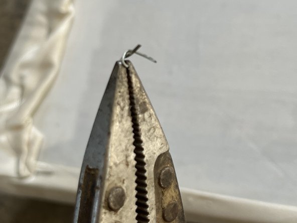

    • Use a pair of pliers to grip the staples.
    • Twist and pull the staples to remove them from the bench.

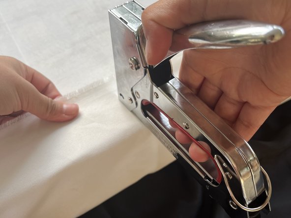

  5. How to Reupholster a Bench Cushion: crwdns2935265:05crwdnd2935265:01crwdnd2935265:03crwdne2935265:0 How to Reupholster a Bench Cushion: crwdns2935265:05crwdnd2935265:02crwdnd2935265:03crwdne2935265:0 How to Reupholster a Bench Cushion: crwdns2935265:05crwdnd2935265:03crwdnd2935265:03crwdne2935265:0
    • Keep the safety lock closed when not using the staple gun.
    • When ready to use the staple gun, pull the safety lock down.
    • Insert the staples into the stapler.

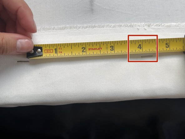

    • Pull the fabric taut and staple every 4 inches.
