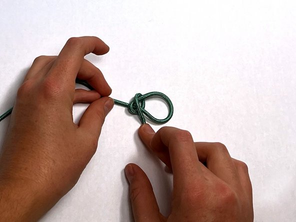

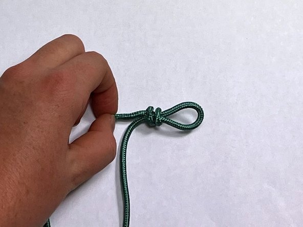

    • Prep the nylon strings for the pocket with a poachers knot.
    • Create this knot at one end of each nylon.
    • There are two nylons for this stringing instruction.

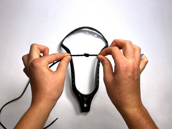

    • Tie a double knot on a sidewall string.
    • Make sure the lacrosse head is face down.

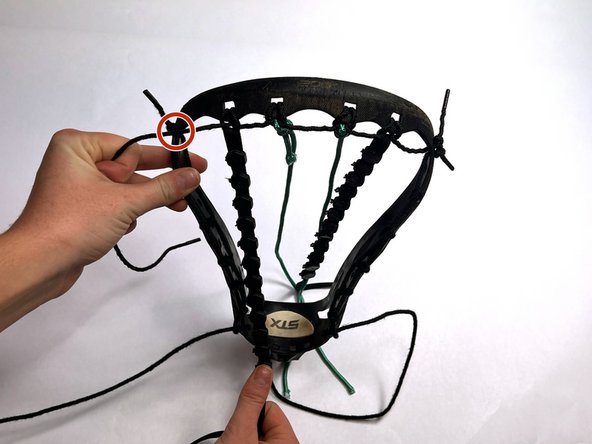

  6. How to Restring a Women's Lacrosse Head: crwdns2935265:06crwdnd2935265:01crwdnd2935265:02crwdne2935265:0 How to Restring a Women's Lacrosse Head: crwdns2935265:06crwdnd2935265:02crwdnd2935265:02crwdne2935265:0
    • Knot the top-string on one end.
    • Thread the top-string through the topmost sidewall hole with the sidewall-string knot.
