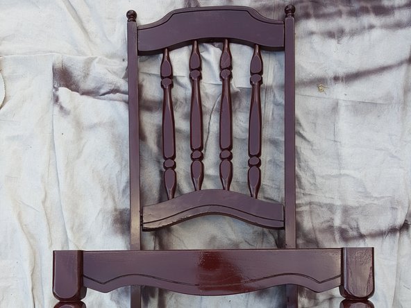

    • Begin with an old chair frame.
    • For frames in good condition, continue to step 5.
    • Using your sandpaper, rub any marks or scuffs off the wood.
    • Always rub with the grain of the wood.
  2. How to Restore a Dining Chair: crwdns2935265:02crwdnd2935265:01crwdnd2935265:02crwdne2935265:0 How to Restore a Dining Chair: crwdns2935265:02crwdnd2935265:02crwdnd2935265:02crwdne2935265:0
    • Use the cleaning cloth to wipe off any excess dirt and dust.
  3. How to Restore a Dining Chair: crwdns2935265:03crwdnd2935265:01crwdnd2935265:03crwdne2935265:0 How to Restore a Dining Chair: crwdns2935265:03crwdnd2935265:02crwdnd2935265:03crwdne2935265:0 How to Restore a Dining Chair: crwdns2935265:03crwdnd2935265:03crwdnd2935265:03crwdne2935265:0

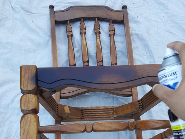

    • Holding the spray paint 6-12 inches away from the chair, apply a light coat of paint.
    • Allow it to dry for about 5 minutes.
    • Apply a second light coat over the front of the chair and allow it to dry for 10 minutes.
  4. How to Restore a Dining Chair: crwdns2935265:04crwdnd2935265:01crwdnd2935265:02crwdne2935265:0 How to Restore a Dining Chair: crwdns2935265:04crwdnd2935265:02crwdnd2935265:02crwdne2935265:0

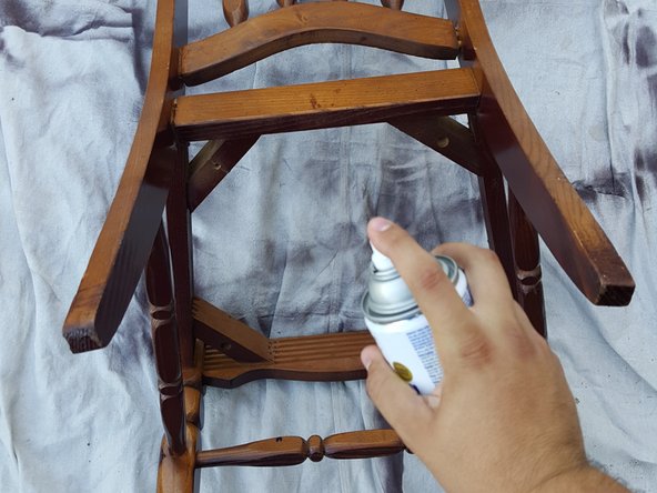

    • Flip the chair over.
    • Repeat step 3 for the back side.
  5. How to Restore a Dining Chair: crwdns2935265:05crwdnd2935265:01crwdnd2935265:03crwdne2935265:0 How to Restore a Dining Chair: crwdns2935265:05crwdnd2935265:02crwdnd2935265:03crwdne2935265:0 How to Restore a Dining Chair: crwdns2935265:05crwdnd2935265:03crwdnd2935265:03crwdne2935265:0

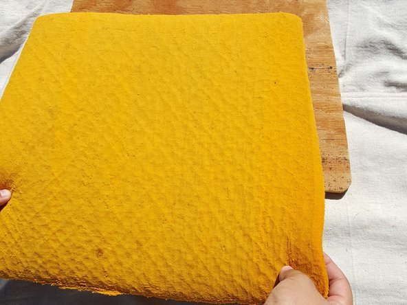

    • While the paint dries, work on the seat.

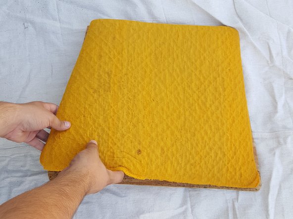

    • Grab the wood board and set it down.
    • Grab the desired cushion and rest it on top of the board.
    • Make sure to align all four corners of the wood to the corners of the cushion.

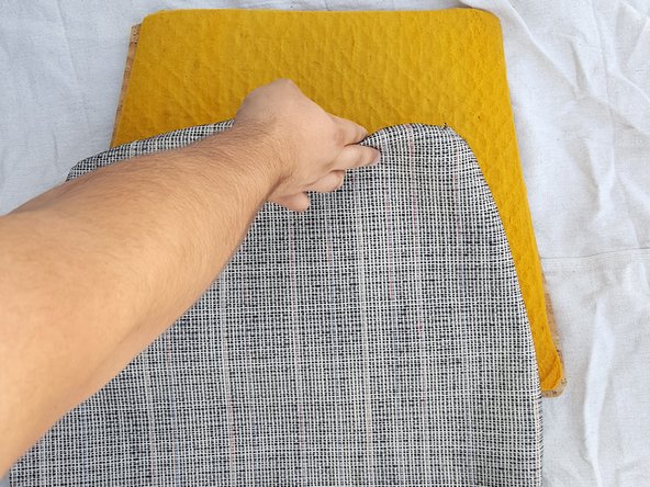

  6. How to Restore a Dining Chair: crwdns2935265:06crwdnd2935265:01crwdnd2935265:03crwdne2935265:0 How to Restore a Dining Chair: crwdns2935265:06crwdnd2935265:02crwdnd2935265:03crwdne2935265:0 How to Restore a Dining Chair: crwdns2935265:06crwdnd2935265:03crwdnd2935265:03crwdne2935265:0

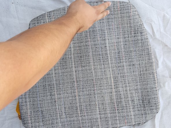

    • Now grab the cushion cover.
    • You may use fabric (cut to size) instead of a cushion cover.
    • Place your cover on top of the cushion, aligning all four corners.
  7. How to Restore a Dining Chair: crwdns2935265:07crwdnd2935265:01crwdnd2935265:03crwdne2935265:0 How to Restore a Dining Chair: crwdns2935265:07crwdnd2935265:02crwdnd2935265:03crwdne2935265:0 How to Restore a Dining Chair: crwdns2935265:07crwdnd2935265:03crwdnd2935265:03crwdne2935265:0

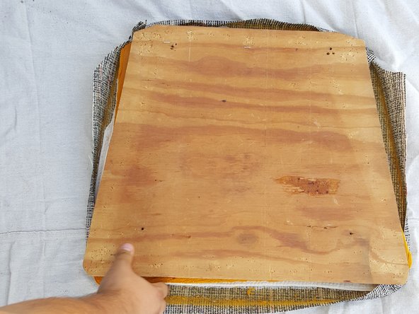

    • Grab the stack of wood, cushion and cover and flip it over.
    • Align them so they stack up evenly.
    • Fragments of the cushion cover may stick out a little.

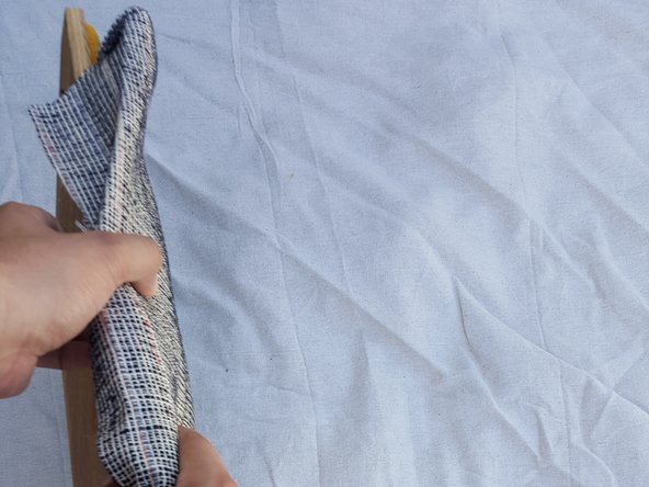

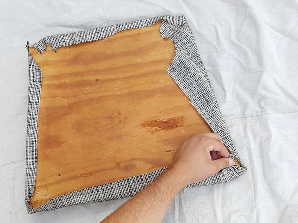

  8. How to Restore a Dining Chair: crwdns2935265:08crwdnd2935265:01crwdnd2935265:03crwdne2935265:0 How to Restore a Dining Chair: crwdns2935265:08crwdnd2935265:02crwdnd2935265:03crwdne2935265:0 How to Restore a Dining Chair: crwdns2935265:08crwdnd2935265:03crwdnd2935265:03crwdne2935265:0

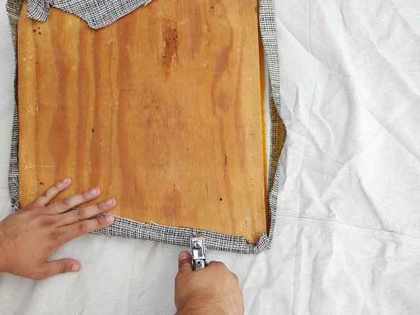

    • Fold the sides of the cover over the board and cushion keeping them as close to the center of the board as possible.
    • Select a side to start on.
    • With the staple gun, staple the end of the cushion cover you are holding into the board.
    • Rotate the board and staple down the other side.
    • Continue to staple down the sides, placing staples about 1 inch apart.
    • Fold the corners in and staple them onto the board.

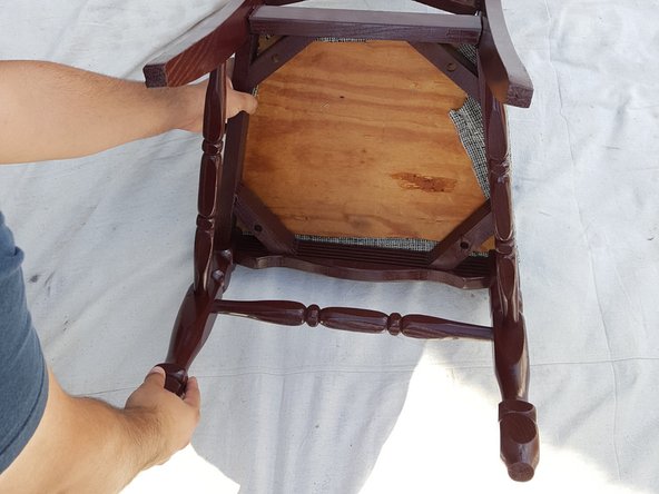

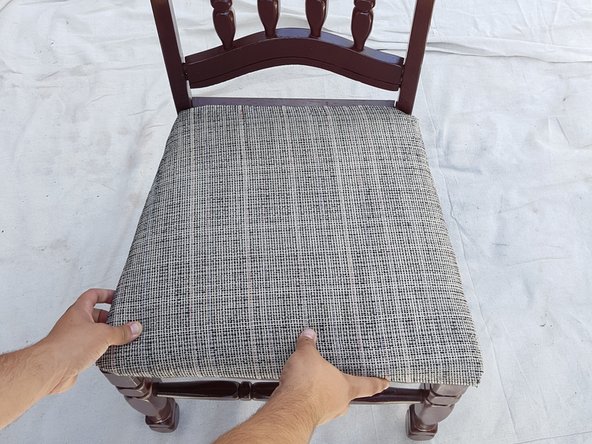

  9. How to Restore a Dining Chair: crwdns2935265:09crwdnd2935265:01crwdnd2935265:03crwdne2935265:0 How to Restore a Dining Chair: crwdns2935265:09crwdnd2935265:02crwdnd2935265:03crwdne2935265:0 How to Restore a Dining Chair: crwdns2935265:09crwdnd2935265:03crwdnd2935265:03crwdne2935265:0
    • Make sure that the paint on the chair frame has completely dried up.
    • Grab your newly covered cushion and place it on the seat of the chair frame.
    • Holding on to both the cushion and the frame, flip the chair over.
  10. How to Restore a Dining Chair: crwdns2935265:010crwdnd2935265:01crwdnd2935265:03crwdne2935265:0 How to Restore a Dining Chair: crwdns2935265:010crwdnd2935265:02crwdnd2935265:03crwdne2935265:0 How to Restore a Dining Chair: crwdns2935265:010crwdnd2935265:03crwdnd2935265:03crwdne2935265:0
    • Place the screws in the screw holes.
    • Tighten the screws with the philips screw driver.
    • To avoid the wood from cracking, do not apply to much force when turning screwdriver.
  11. How to Restore a Dining Chair: crwdns2935265:011crwdnd2935265:01crwdnd2935265:01crwdne2935265:0
    • Make good use of your brand new chair.
