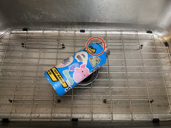

    • Empty your Hydro Flask water bottle and clean the exterior.
    • You may want to remove stickers around the dent to see the damage more clearly.
  2. How to Restore a Dented Hydro Flask: crwdns2935265:02crwdnd2935265:01crwdnd2935265:01crwdne2935265:0
    • Boil enough water to pour over the dent.
  3. How to Restore a Dented Hydro Flask: crwdns2935265:03crwdnd2935265:01crwdnd2935265:02crwdne2935265:0 How to Restore a Dented Hydro Flask: crwdns2935265:03crwdnd2935265:02crwdnd2935265:02crwdne2935265:0
    • Prepare an ice bath by filling a bin with water and ice in a small tub.
  4. How to Restore a Dented Hydro Flask: crwdns2935265:04crwdnd2935265:01crwdnd2935265:03crwdne2935265:0 How to Restore a Dented Hydro Flask: crwdns2935265:04crwdnd2935265:02crwdnd2935265:03crwdne2935265:0 How to Restore a Dented Hydro Flask: crwdns2935265:04crwdnd2935265:03crwdnd2935265:03crwdne2935265:0
    • Place your Hydro Flask in an empty sink.
    • Pour the boiling water directly onto the dented area for about 10 seconds.
    • Boiling water can cause burns to the skin, protective gloves are suggested.
  5. How to Restore a Dented Hydro Flask: crwdns2935265:05crwdnd2935265:01crwdnd2935265:01crwdne2935265:0
    • Immediately submerge the dented area into the prepared ice bath for about 10 seconds.
    • Handle the bottle with caution as it may still be hot from the previous step. Use protective gloves as suggested.
  6. How to Restore a Dented Hydro Flask: crwdns2935265:06crwdnd2935265:01crwdnd2935265:01crwdne2935265:0
    • Use a wooden spoon to reach inside the Hydro Flask and push out the dent.
    • Any solid object long enough to reach the dent will also work.
