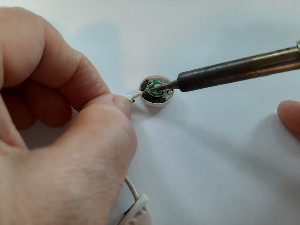

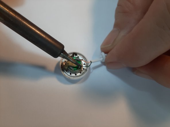

    • Use your soldering iron to gently touch the solder on the circuit board that is attached to one of the wires. Once the solder melts, twist the cable so that the wire is released from the circuit board. Repeat with the other remaining wire still attached to the circuit board.
    • Repeat the above step with the other sound driver.
    • Place your sound driver aside and away from any strong magnets.

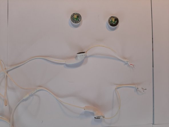

    • You are left with your old cables with the earbud housing still attached.
    • Untie the knot on both sides of the cable, and remove the housings from the cable. Set aside the housings, and discard the old, damaged cable.

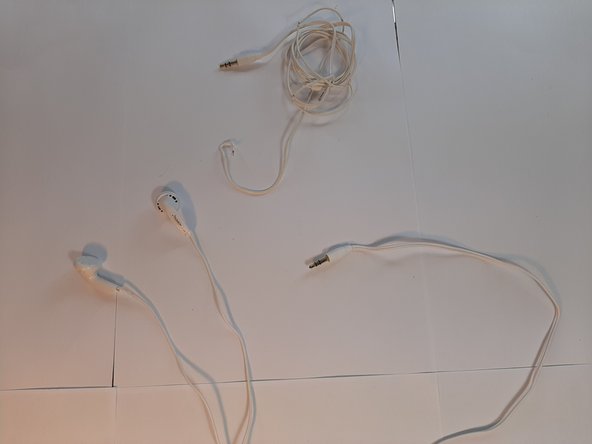

  6. How to Replace your Earbud's Cable: crwdns2935265:06crwdnd2935265:01crwdnd2935265:01crwdne2935265:0
    • Run the left side of your new cable through the left earbud housing. Tie a knot that is roughly 1.5 cm away from the tip of the exposed wire. Repeat with the right side of the new cable.
    • For most cables, the left side has green/copper wires, while the right side has red/copper wires.

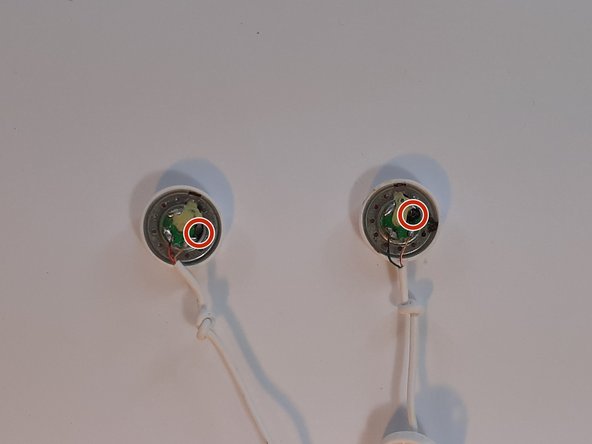

    • Refer to the picture taken previously to know which solder points to connect your wires to.
    • Choose a sound driver and put it in front of you on your work surface.
    • Hold onto your soldering iron with one hand and the wire with the other. Bring the soldering iron tip to touch the solder point that is marked with a Sharpie or paint.
    • Once the solder point liquefies, bring the left cable so that the copper colored wire touches the liquid solder. The copper colored wire will sink into the solder point and some solder will envelop the tip of the wire. Put down your soldering iron and let the solder point cool down to solidify.
    • Repeat the above step but with the green wire and on the other remaining solder point.
    • For the right side, repeat the above two steps. The copper colored wire goes to the side marked with sharpie/paint, and the red wire goes to the other solder point.

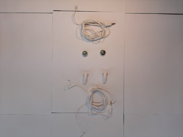

    • Refer to your photo taken previously to align the rotation of the driver. If your driver is rotated upside down, your music will be upside down!
    • This step is optional. Apply a thin layer of adhesive on the outer edge of the left earbud housing. Depending on the type of adhesive, you may have to work quickly.
    • Slide the housing onto the driver, then pinch the housing and sound driver together to attach them. Wipe off any excess adhesive, if using.
    • If it does not snap together, you will have to follow the above step and hold the sound driver and the earbud housing together until the adhesive dries.
    • Repeat with right side of the earbuds.
Plug in your headphones into a device and play some music! If any problem persists, start back from Step 2 and check the integrity of your soldered connections.
