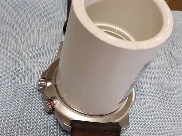

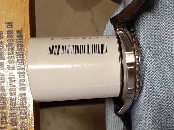

    • Once you have the back plate in the proper orientation it needs to be pressed into place. I found it impossible to perform this by hand. Eventually I found a short length of 3/4" PVC pipe.
    • Align the pipe with the back plate.
    • Place the watch and pipe in a vise. (Soft cloth used to protect the watch face). Slowly tighten the vise and you'll hear a pop when the back plate snaps into place.
With the watch reassembled, verify that it is functioning to your satisfaction.

I had no need for the PVC pipe, I was able to pop my watch face back in by hand.
It is useful for applying equal pressure and ensuring the watch remains waterproof
Darius - crwdns2934203:0crwdne2934203:0
Excellent guide, I was able to replace the battery in 20 mins. I didn’t use the PVC pipe but a flat end of my 5 lb dumb bell, there rubber on the dumb bell so the back plate is not scratched.
