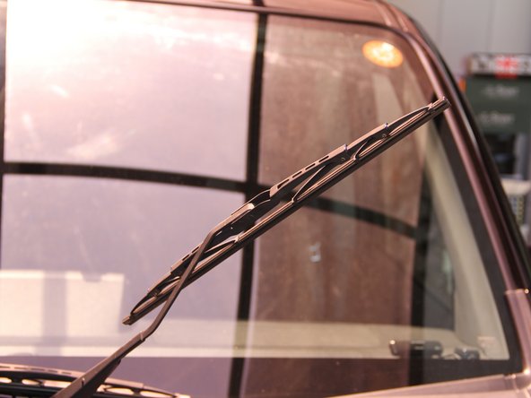

  1. How to Replace the Windshield Wiper Blade for Honda Spike 2006, Lift the Wiper Arm: crwdns2935265:01crwdnd2935265:01crwdnd2935265:02crwdne2935265:0 How to Replace the Windshield Wiper Blade for Honda Spike 2006, Lift the Wiper Arm: crwdns2935265:01crwdnd2935265:02crwdnd2935265:02crwdne2935265:0
    • Grab the windshield wiper at the base and lift in a counter-clockwise motion around the hinge, lifting the blade from the window.

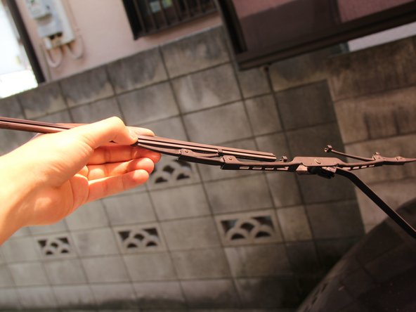

  2. How to Replace the Windshield Wiper Blade for Honda Spike 2006, Rotate the Blade Assembly: crwdns2935265:02crwdnd2935265:01crwdnd2935265:02crwdne2935265:0 How to Replace the Windshield Wiper Blade for Honda Spike 2006, Rotate the Blade Assembly: crwdns2935265:02crwdnd2935265:02crwdnd2935265:02crwdne2935265:0
    • Rotate the wiper blade assembly so the replaceable blade faces outward.

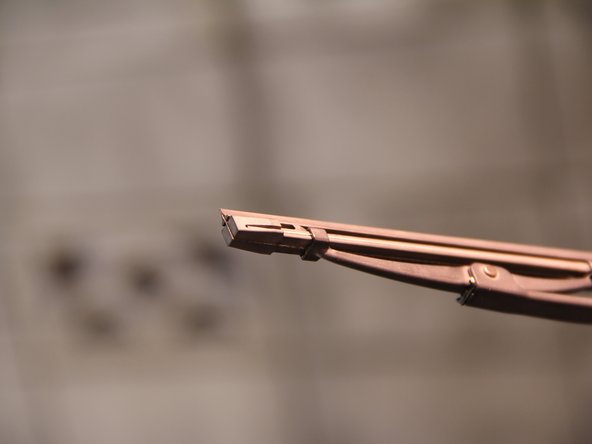

  3. How to Replace the Windshield Wiper Blade for Honda Spike 2006, Remove the Retaining Clasp: crwdns2935265:03crwdnd2935265:01crwdnd2935265:02crwdne2935265:0 How to Replace the Windshield Wiper Blade for Honda Spike 2006, Remove the Retaining Clasp: crwdns2935265:03crwdnd2935265:02crwdnd2935265:02crwdne2935265:0
    • Remove the retaining clasp on the right edge of the blade.
    • The clasp is always on the rightmost edge of each blade.

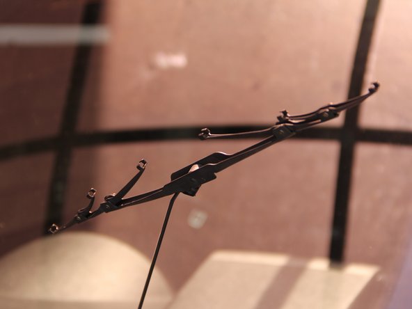

  4. How to Replace the Windshield Wiper Blade for Honda Spike 2006, Removing the Wiper Blade: crwdns2935265:04crwdnd2935265:01crwdnd2935265:03crwdne2935265:0 How to Replace the Windshield Wiper Blade for Honda Spike 2006, Removing the Wiper Blade: crwdns2935265:04crwdnd2935265:02crwdnd2935265:03crwdne2935265:0 How to Replace the Windshield Wiper Blade for Honda Spike 2006, Removing the Wiper Blade: crwdns2935265:04crwdnd2935265:03crwdnd2935265:03crwdne2935265:0
    • After removing the clasp, pull the blade from the wiper arm.

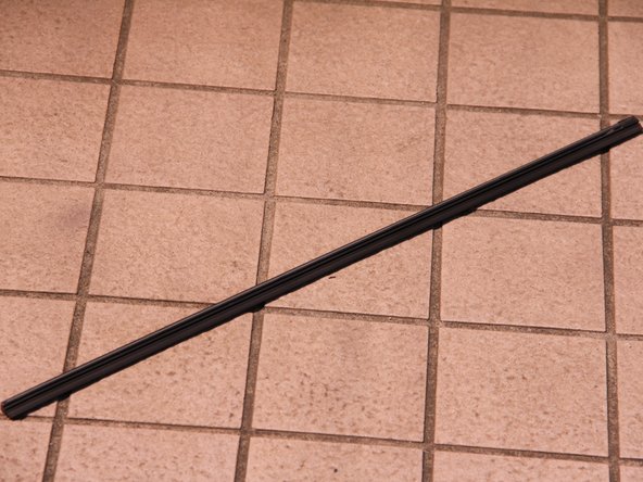

  5. How to Replace the Windshield Wiper Blade for Honda Spike 2006, Insert the Wiper Blade: crwdns2935265:05crwdnd2935265:01crwdnd2935265:02crwdne2935265:0 How to Replace the Windshield Wiper Blade for Honda Spike 2006, Insert the Wiper Blade: crwdns2935265:05crwdnd2935265:02crwdnd2935265:02crwdne2935265:0
    • Insert the new blade by sliding it back into the slots on the wiper arm.
  6. How to Replace the Windshield Wiper Blade for Honda Spike 2006, Reattach the Retaining Clip: crwdns2935265:06crwdnd2935265:01crwdnd2935265:01crwdne2935265:0
    • Reattach the clasp by sliding it back over the edge of the wiper blade.

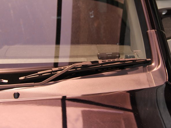

  8. How to Replace the Windshield Wiper Blade for Honda Spike 2006, Lower the Wiper Arm: crwdns2935265:08crwdnd2935265:01crwdnd2935265:02crwdne2935265:0 How to Replace the Windshield Wiper Blade for Honda Spike 2006, Lower the Wiper Arm: crwdns2935265:08crwdnd2935265:02crwdnd2935265:02crwdne2935265:0
    • Rotate the wiper arm clockwise around the hinge until it rests on the windshield.
