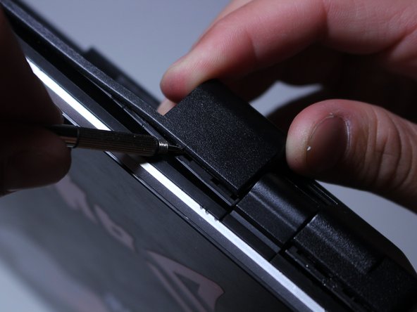

  2. How to Replace the Wi-Fi Card for a Samsung NP300V5A-A08US Laptop: crwdns2935265:02crwdnd2935265:01crwdnd2935265:03crwdne2935265:0 How to Replace the Wi-Fi Card for a Samsung NP300V5A-A08US Laptop: crwdns2935265:02crwdnd2935265:02crwdnd2935265:03crwdne2935265:0 How to Replace the Wi-Fi Card for a Samsung NP300V5A-A08US Laptop: crwdns2935265:02crwdnd2935265:03crwdnd2935265:03crwdne2935265:0

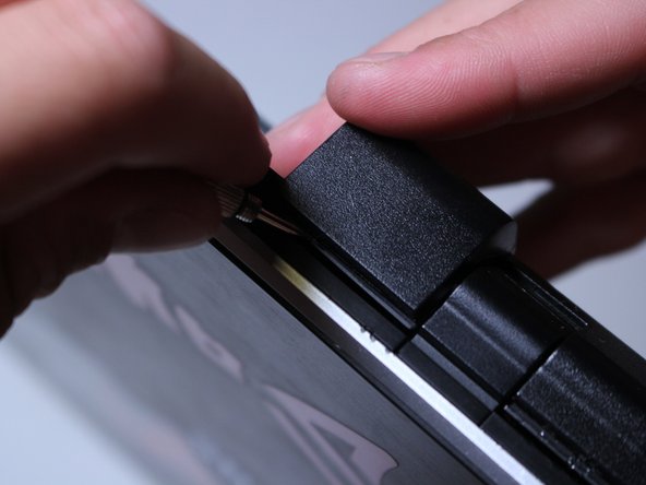

    • Pry apart the plastic clips near the screw hole using a plastic opening tool.
    • Use your finger and the opening tool to pry up the plastic cover.
    • It is normal to hear noises similar to that of plastic snapping when prying up the plastic cover.

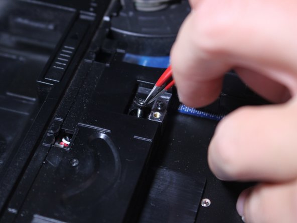

  3. How to Replace the Wi-Fi Card for a Samsung NP300V5A-A08US Laptop: crwdns2935265:03crwdnd2935265:01crwdnd2935265:02crwdne2935265:0 How to Replace the Wi-Fi Card for a Samsung NP300V5A-A08US Laptop: crwdns2935265:03crwdnd2935265:02crwdnd2935265:02crwdne2935265:0
    • Pry off the rubber pads on the remaining three corners of the computer using the tip of the opening tool.
    • Adhesive glue is used to hold the rubber pads on. It may take more effort to take these off.

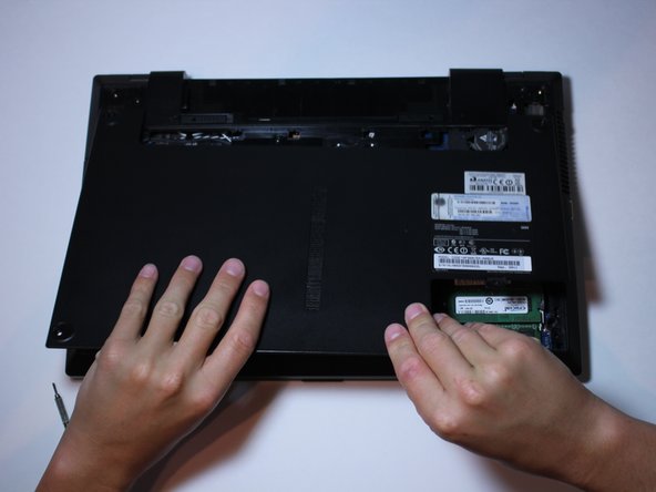

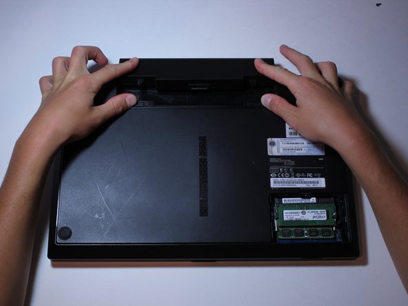

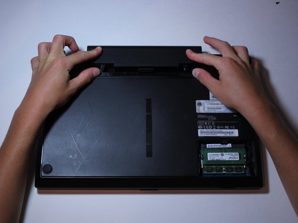

  6. How to Replace the Wi-Fi Card for a Samsung NP300V5A-A08US Laptop: crwdns2935265:06crwdnd2935265:01crwdnd2935265:03crwdne2935265:0 How to Replace the Wi-Fi Card for a Samsung NP300V5A-A08US Laptop: crwdns2935265:06crwdnd2935265:02crwdnd2935265:03crwdne2935265:0 How to Replace the Wi-Fi Card for a Samsung NP300V5A-A08US Laptop: crwdns2935265:06crwdnd2935265:03crwdnd2935265:03crwdne2935265:0
    • Put your hands on the back panel and use pressure to slide the panel down a few millimeters (as shown in the photo).
    • Slide the back panel down and then lift it off.

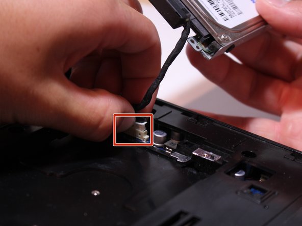

  9. How to Replace the Wi-Fi Card for a Samsung NP300V5A-A08US Laptop: crwdns2935265:09crwdnd2935265:01crwdnd2935265:03crwdne2935265:0 How to Replace the Wi-Fi Card for a Samsung NP300V5A-A08US Laptop: crwdns2935265:09crwdnd2935265:02crwdnd2935265:03crwdne2935265:0 How to Replace the Wi-Fi Card for a Samsung NP300V5A-A08US Laptop: crwdns2935265:09crwdnd2935265:03crwdnd2935265:03crwdne2935265:0
    • Take note of how the wire harness is routed around the motherboard and the plastic casing.
    • Gently pull on the wire harness to get it out of the crevasse.
    • Carefully wiggle the white plastic connector on the computer back and forth until you are able to disconnect the wire harness.
    • Be careful to not pull on the wires themselves, as they may become disconnected from the white plastic connector.

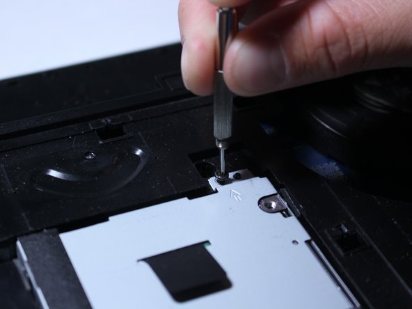

  10. How to Replace the Wi-Fi Card for a Samsung NP300V5A-A08US Laptop: crwdns2935265:010crwdnd2935265:01crwdnd2935265:01crwdne2935265:0
    • Using a Philips #00 screwdriver, remove the 6.5mm screw located next to the "ODD" print as indicated in the photo.

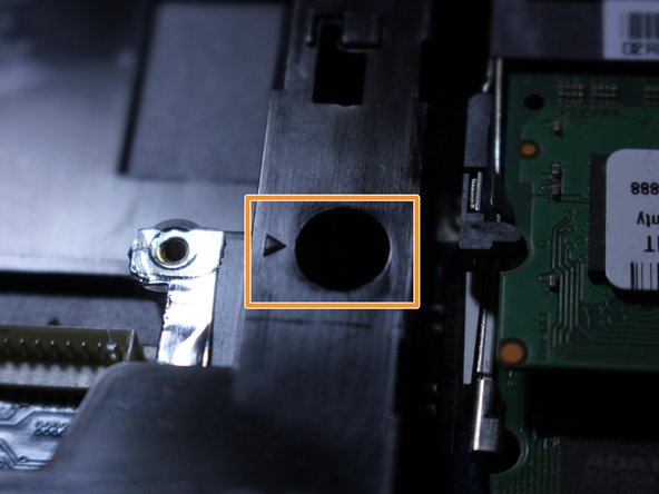

  12. How to Replace the Wi-Fi Card for a Samsung NP300V5A-A08US Laptop: crwdns2935265:012crwdnd2935265:01crwdnd2935265:03crwdne2935265:0 How to Replace the Wi-Fi Card for a Samsung NP300V5A-A08US Laptop: crwdns2935265:012crwdnd2935265:02crwdnd2935265:03crwdne2935265:0 How to Replace the Wi-Fi Card for a Samsung NP300V5A-A08US Laptop: crwdns2935265:012crwdnd2935265:03crwdnd2935265:03crwdne2935265:0
    • Using a Phillips #00, remove the thirteen 6.5mm screws.
    • Each screw location is designated by an arrow icon as shown in the second picture.
    • Use your tweezers to remove loosened screws.

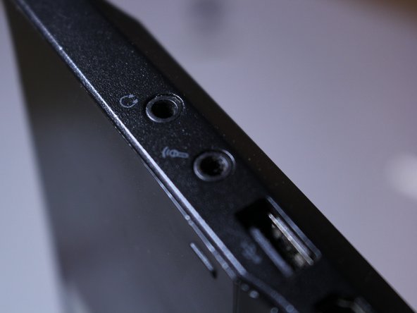

    • Locate the discrete line between the two pieces of plastic on the side of the keyboard.
    • Starting near the headphone jack, use a plastic opening tool to pry apart the two pieces of plastic.
    • A popping or snapping sound in the next couple steps is normal.

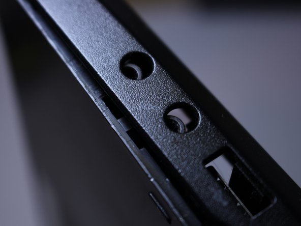

  14. How to Replace the Wi-Fi Card for a Samsung NP300V5A-A08US Laptop: crwdns2935265:014crwdnd2935265:01crwdnd2935265:03crwdne2935265:0 How to Replace the Wi-Fi Card for a Samsung NP300V5A-A08US Laptop: crwdns2935265:014crwdnd2935265:02crwdnd2935265:03crwdne2935265:0 How to Replace the Wi-Fi Card for a Samsung NP300V5A-A08US Laptop: crwdns2935265:014crwdnd2935265:03crwdnd2935265:03crwdne2935265:0
    • Slowly start making your way around the edge of the keyboard, prying the two pieces apart.

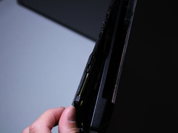

  16. How to Replace the Wi-Fi Card for a Samsung NP300V5A-A08US Laptop: crwdns2935265:016crwdnd2935265:01crwdnd2935265:02crwdne2935265:0 How to Replace the Wi-Fi Card for a Samsung NP300V5A-A08US Laptop: crwdns2935265:016crwdnd2935265:02crwdnd2935265:02crwdne2935265:0
    • You also have to get the skinny area where the battery port is.
    • This is easiest to get to by closing the computer shut.
    • When you start to get most of the two plastic pieces disconnected, you can just use your hands to pop-it apart.

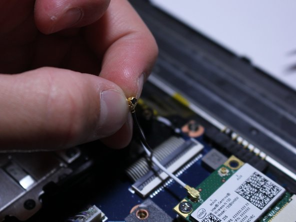

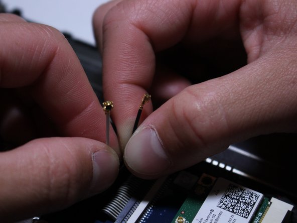

  21. How to Replace the Wi-Fi Card for a Samsung NP300V5A-A08US Laptop: crwdns2935265:021crwdnd2935265:01crwdnd2935265:03crwdne2935265:0 How to Replace the Wi-Fi Card for a Samsung NP300V5A-A08US Laptop: crwdns2935265:021crwdnd2935265:02crwdnd2935265:03crwdne2935265:0 How to Replace the Wi-Fi Card for a Samsung NP300V5A-A08US Laptop: crwdns2935265:021crwdnd2935265:03crwdnd2935265:03crwdne2935265:0
    • Remove the snap-on cables from the Wi-Fi card using the tips of your fingernails and the assistance of your tweezers.
    • Take note which snap-on cable goes where on the Wi-Fi card.
