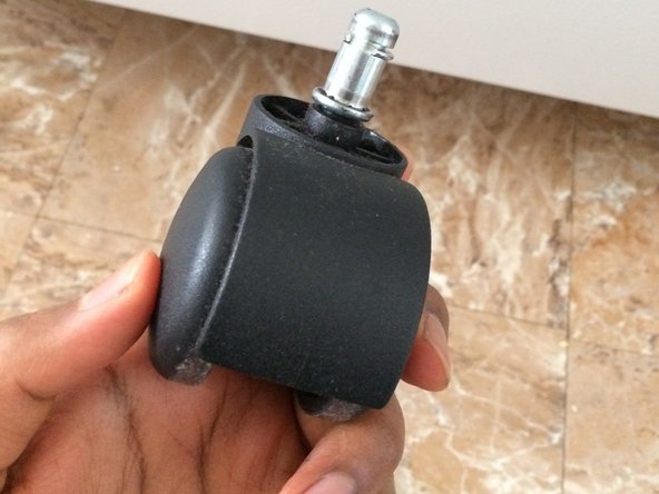

    • Wipe the stem of the caster with a rag or paper towel to remove any dust or debris.

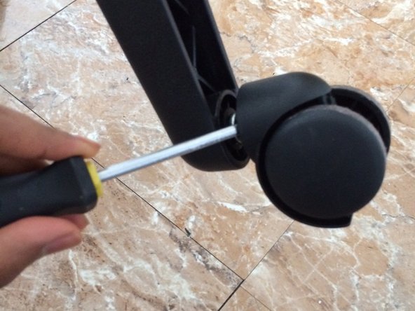

    • Use a flathead screwdriver in between the caster and the base of the chair to pry the wheel out of the socket.
    • Turn the screwdriver gently until the caster starts to move upwards away from the chair.
    • Try rotating the screwdriver at different angles if the caster won't come out.

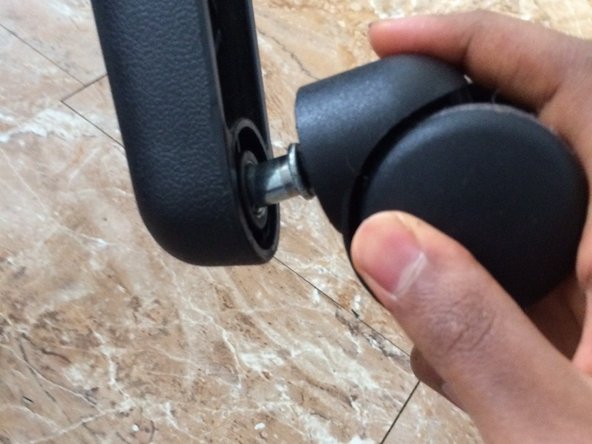

    • Use a prying tool that is big enough to fit between the caster and over the stem.
    • Gently pull on the caster upwards and it should come off.

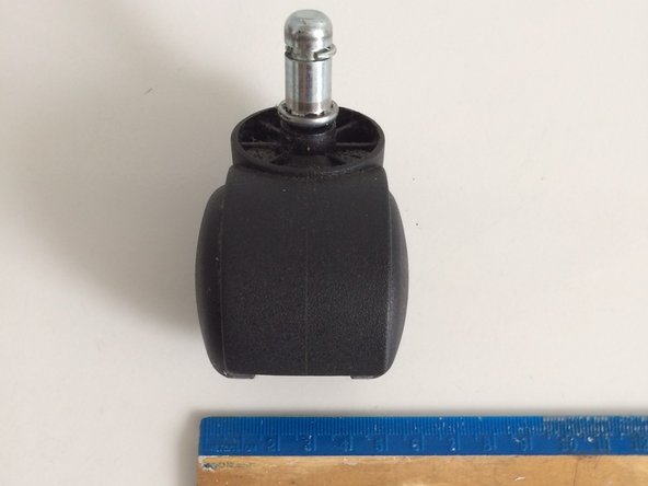

    • Measure the wheel's height and length.
    • Once you've done that, purchase your new casters.
    • Large casters(about 3"), are more durable and versatile. Twin-wheel casters are usually used in office settings.
