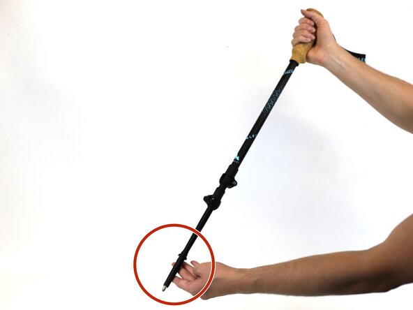

How to Replace the Tip of a Hiking Pole

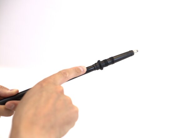

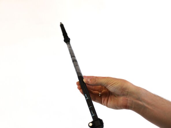

  1. How to Replace the Tip of a Hiking Pole, Identify the repair area: crwdns2935265:01crwdnd2935265:01crwdnd2935265:02crwdne2935265:0 How to Replace the Tip of a Hiking Pole, Identify the repair area: crwdns2935265:01crwdnd2935265:02crwdnd2935265:02crwdne2935265:0
    • Prepare all the tools needed for the repair and locate the tip of the hiking pole that needs to be fixed.

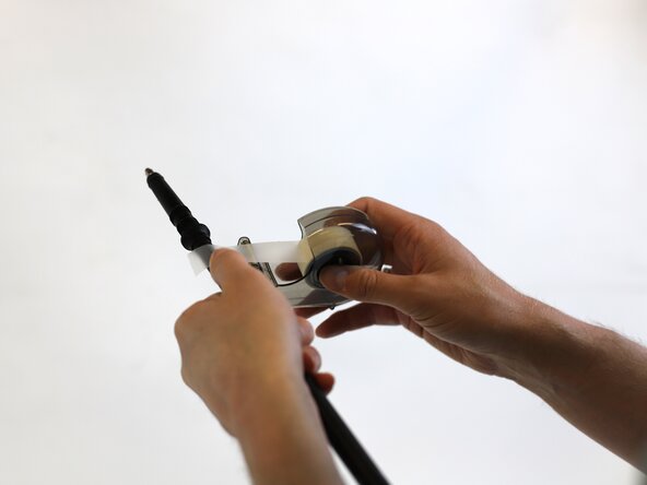

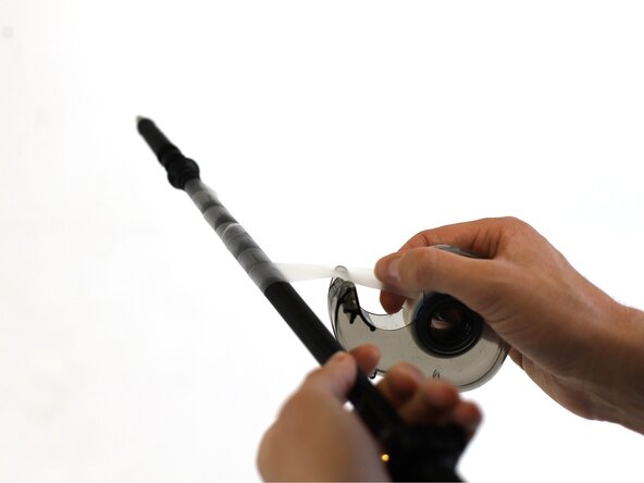

  2. How to Replace the Tip of a Hiking Pole, Prepare the hiking pole: crwdns2935265:02crwdnd2935265:01crwdnd2935265:03crwdne2935265:0 How to Replace the Tip of a Hiking Pole, Prepare the hiking pole: crwdns2935265:02crwdnd2935265:02crwdnd2935265:03crwdne2935265:0 How to Replace the Tip of a Hiking Pole, Prepare the hiking pole: crwdns2935265:02crwdnd2935265:03crwdnd2935265:03crwdne2935265:0
    • In order to protect the pole from scratching, secure it with scotch tape.

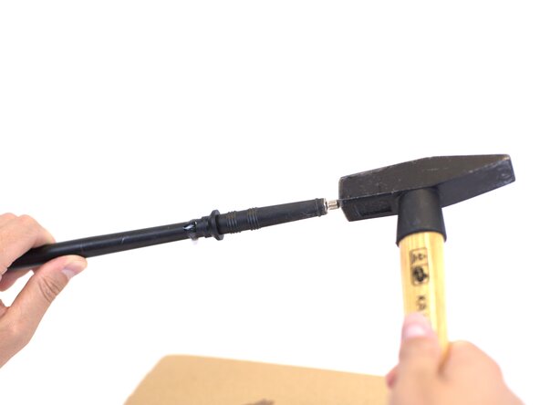

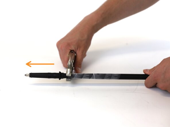

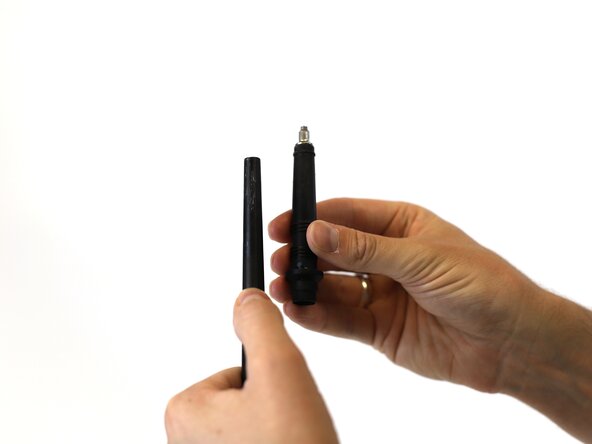

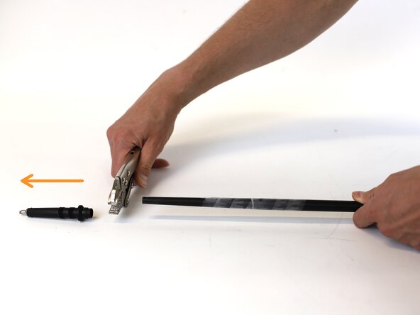

  3. How to Replace the Tip of a Hiking Pole, Remove the tip: crwdns2935265:03crwdnd2935265:01crwdnd2935265:03crwdne2935265:0 How to Replace the Tip of a Hiking Pole, Remove the tip: crwdns2935265:03crwdnd2935265:02crwdnd2935265:03crwdne2935265:0 How to Replace the Tip of a Hiking Pole, Remove the tip: crwdns2935265:03crwdnd2935265:03crwdnd2935265:03crwdne2935265:0
    • Following the direction of the orange arrows, use an adjustable wrench to slide it fast along the hiking pole and push the tip outwards.

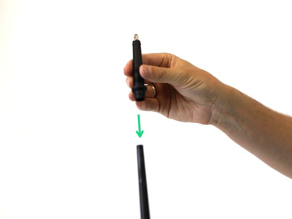

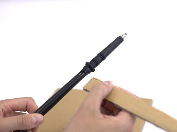

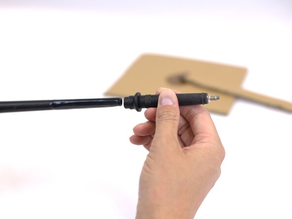

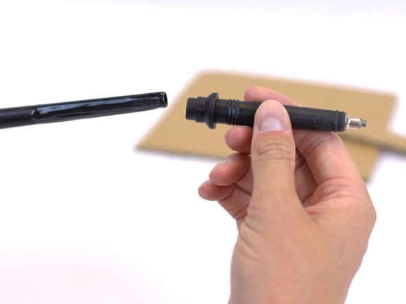

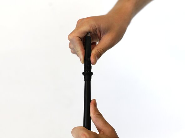

  4. How to Replace the Tip of a Hiking Pole, Insert the new tip: crwdns2935265:04crwdnd2935265:01crwdnd2935265:03crwdne2935265:0 How to Replace the Tip of a Hiking Pole, Insert the new tip: crwdns2935265:04crwdnd2935265:02crwdnd2935265:03crwdne2935265:0 How to Replace the Tip of a Hiking Pole, Insert the new tip: crwdns2935265:04crwdnd2935265:03crwdnd2935265:03crwdne2935265:0
    • Insert the replacement tip manually by pushing it inwards.

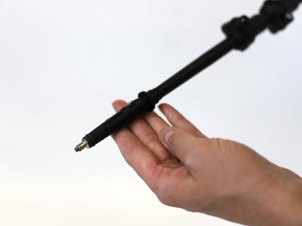

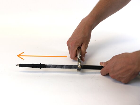

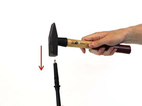

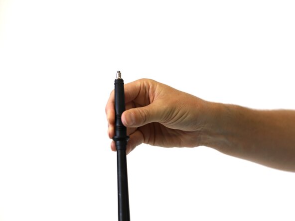

  5. How to Replace the Tip of a Hiking Pole, Set the new tip in place: crwdns2935265:05crwdnd2935265:01crwdnd2935265:03crwdne2935265:0 How to Replace the Tip of a Hiking Pole, Set the new tip in place: crwdns2935265:05crwdnd2935265:02crwdnd2935265:03crwdne2935265:0 How to Replace the Tip of a Hiking Pole, Set the new tip in place: crwdns2935265:05crwdnd2935265:03crwdnd2935265:03crwdne2935265:0
    • Use a hammer to secure the tip in its new position.
    • Note: only hit it once or twice with a hard tap.

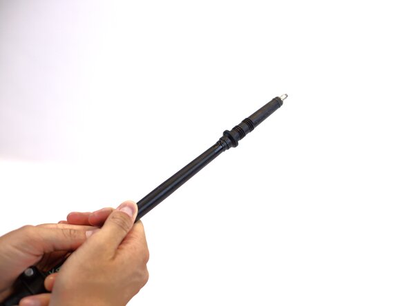

  6. How to Replace the Tip of a Hiking Pole, Finished and ready!: crwdns2935265:06crwdnd2935265:01crwdnd2935265:01crwdne2935265:0
    • 🛠️🏆👏 Congratulations! The repair is complete, and you're ready to go!
    • ...However if you need a reinforced fix, please continue on the next steps.

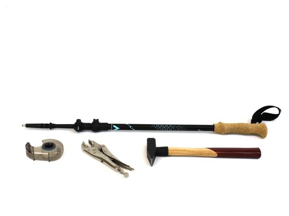

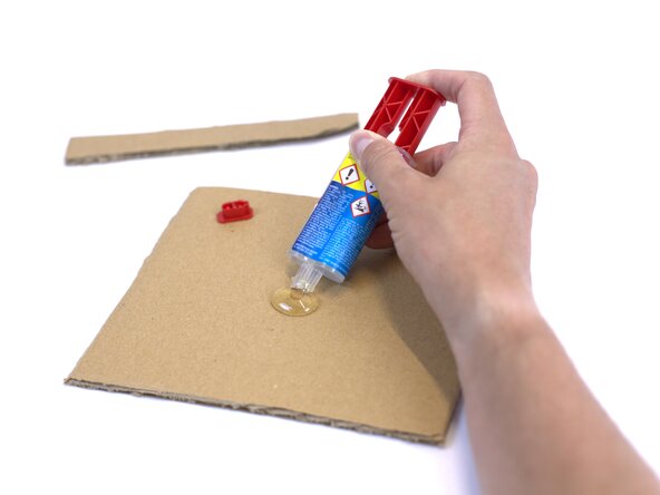

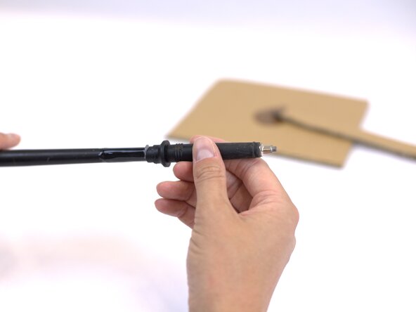

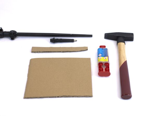

  7. How to Replace the Tip of a Hiking Pole, Collect the extra tools: crwdns2935265:07crwdnd2935265:01crwdnd2935265:03crwdne2935265:0 How to Replace the Tip of a Hiking Pole, Collect the extra tools: crwdns2935265:07crwdnd2935265:02crwdnd2935265:03crwdne2935265:0 How to Replace the Tip of a Hiking Pole, Collect the extra tools: crwdns2935265:07crwdnd2935265:03crwdnd2935265:03crwdne2935265:0
    • Collect the tools needed for the reinforced fix.
    • Mix the two-component glue and continue on the next step.

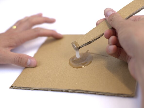

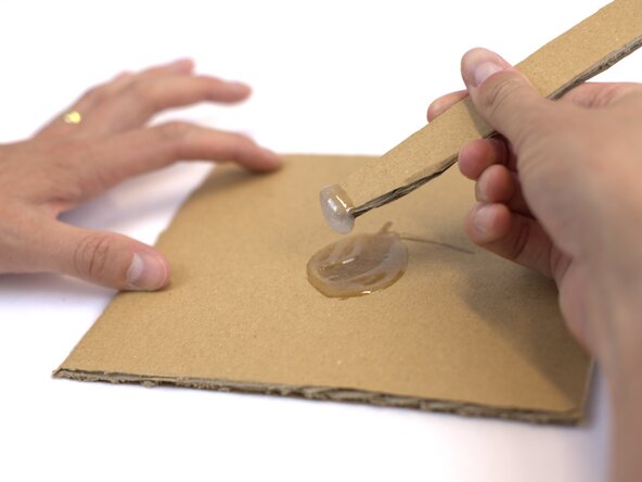

  8. How to Replace the Tip of a Hiking Pole, Prepare the glue: crwdns2935265:08crwdnd2935265:01crwdnd2935265:03crwdne2935265:0 How to Replace the Tip of a Hiking Pole, Prepare the glue: crwdns2935265:08crwdnd2935265:02crwdnd2935265:03crwdne2935265:0 How to Replace the Tip of a Hiking Pole, Prepare the glue: crwdns2935265:08crwdnd2935265:03crwdnd2935265:03crwdne2935265:0
    • Keep mixing the glue until you notice it starts to change texture.
    • The texture should be "thick" and the color should change from transparent to white.

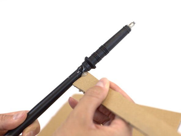

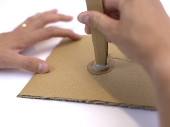

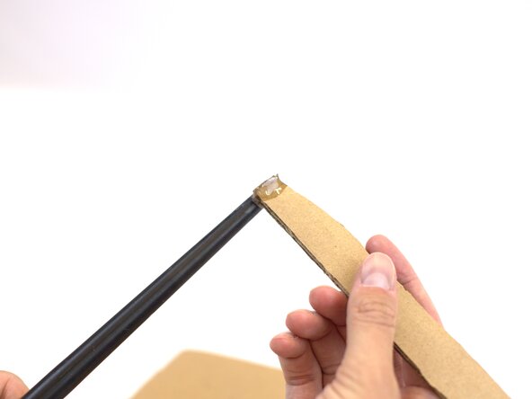

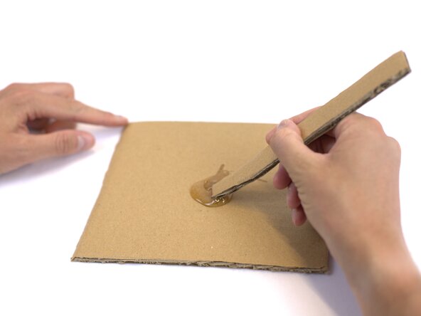

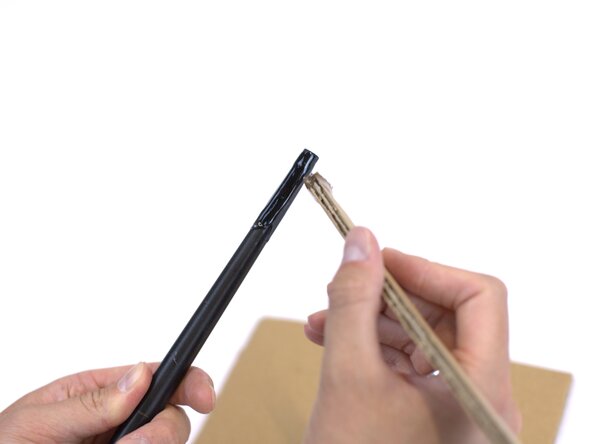

  9. How to Replace the Tip of a Hiking Pole, Apply the glue: crwdns2935265:09crwdnd2935265:01crwdnd2935265:03crwdne2935265:0 How to Replace the Tip of a Hiking Pole, Apply the glue: crwdns2935265:09crwdnd2935265:02crwdnd2935265:03crwdne2935265:0 How to Replace the Tip of a Hiking Pole, Apply the glue: crwdns2935265:09crwdnd2935265:03crwdnd2935265:03crwdne2935265:0
    • Use a piece of cardboard to apply the mixed glue on the top of the tip of the hiking pole.
    • Spread the glue evenly over the surface of the tip.

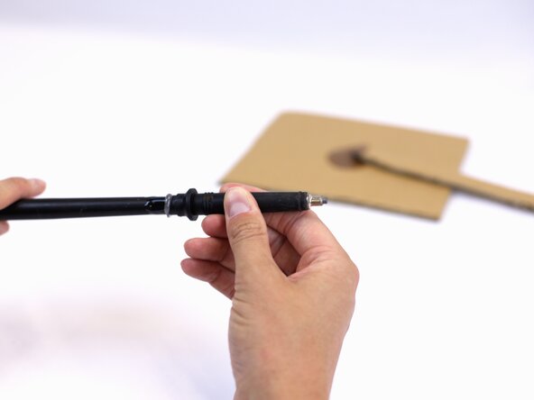

  10. How to Replace the Tip of a Hiking Pole, Insert the tip: crwdns2935265:010crwdnd2935265:01crwdnd2935265:03crwdne2935265:0 How to Replace the Tip of a Hiking Pole, Insert the tip: crwdns2935265:010crwdnd2935265:02crwdnd2935265:03crwdne2935265:0 How to Replace the Tip of a Hiking Pole, Insert the tip: crwdns2935265:010crwdnd2935265:03crwdnd2935265:03crwdne2935265:0
    • Like in "Step 4", insert the replacement tip manually by pushing it inwards.

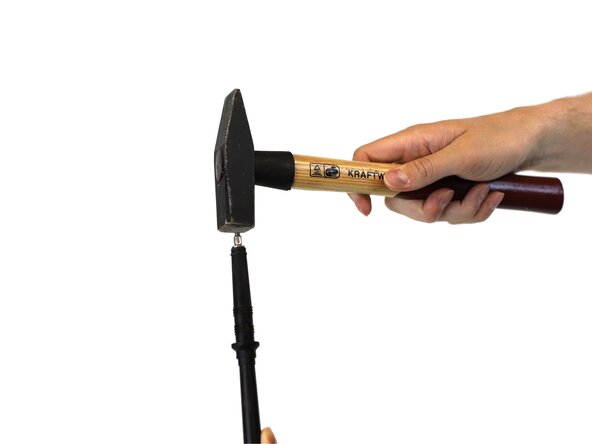

  11. How to Replace the Tip of a Hiking Pole, Secure the tip: crwdns2935265:011crwdnd2935265:01crwdnd2935265:03crwdne2935265:0 How to Replace the Tip of a Hiking Pole, Secure the tip: crwdns2935265:011crwdnd2935265:02crwdnd2935265:03crwdne2935265:0 How to Replace the Tip of a Hiking Pole, Secure the tip: crwdns2935265:011crwdnd2935265:03crwdnd2935265:03crwdne2935265:0
    • Like in "Step 5", use a hammer to secure the tip in its new position.
    • Clean the excess glue with a spare piece of cardboard.
