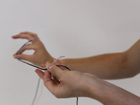

  2. How to Replace the Tent Poles Elastic, Prepare the elastic cord: crwdns2935265:02crwdnd2935265:01crwdnd2935265:03crwdne2935265:0 How to Replace the Tent Poles Elastic, Prepare the elastic cord: crwdns2935265:02crwdnd2935265:02crwdnd2935265:03crwdne2935265:0 How to Replace the Tent Poles Elastic, Prepare the elastic cord: crwdns2935265:02crwdnd2935265:03crwdnd2935265:03crwdne2935265:0
    • Locate the start of the cord and cut the tip with a pair of scissors.
    • Note: remember that although the cord is over extended, there still might be some tension between the poles. For this reason, keep holding the end of the cord, even after cutting the tip.

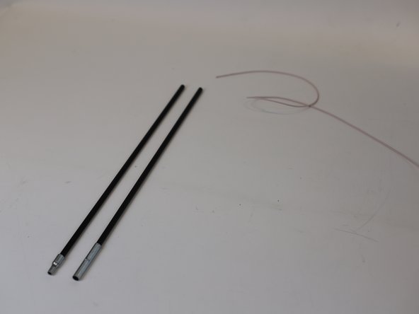

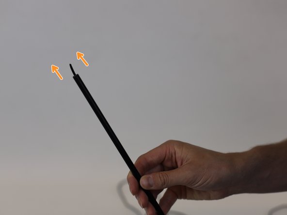

  3. How to Replace the Tent Poles Elastic, Remove the old cord: crwdns2935265:03crwdnd2935265:01crwdnd2935265:03crwdne2935265:0 How to Replace the Tent Poles Elastic, Remove the old cord: crwdns2935265:03crwdnd2935265:02crwdnd2935265:03crwdne2935265:0 How to Replace the Tent Poles Elastic, Remove the old cord: crwdns2935265:03crwdnd2935265:03crwdnd2935265:03crwdne2935265:0
    • Follow the direction of the orange arrows to gently slide the poles out of the cord.

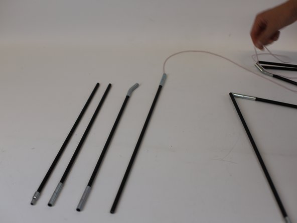

  4. How to Replace the Tent Poles Elastic, Keep removing the cord: crwdns2935265:04crwdnd2935265:01crwdnd2935265:03crwdne2935265:0 How to Replace the Tent Poles Elastic, Keep removing the cord: crwdns2935265:04crwdnd2935265:02crwdnd2935265:03crwdne2935265:0 How to Replace the Tent Poles Elastic, Keep removing the cord: crwdns2935265:04crwdnd2935265:03crwdnd2935265:03crwdne2935265:0
    • Continue to remove the cord.
    • Each time you take a new pole, place it orderly next to the previous pole.
    • Tip: we recommend to place them aside on the same order they were before. This will make the reassembling part easier.

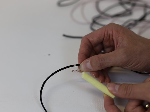

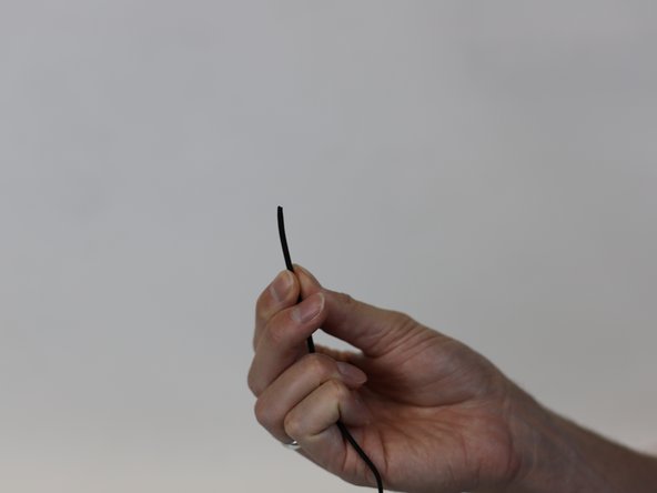

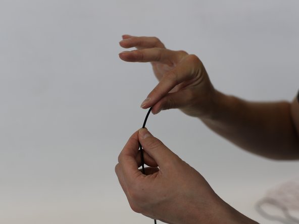

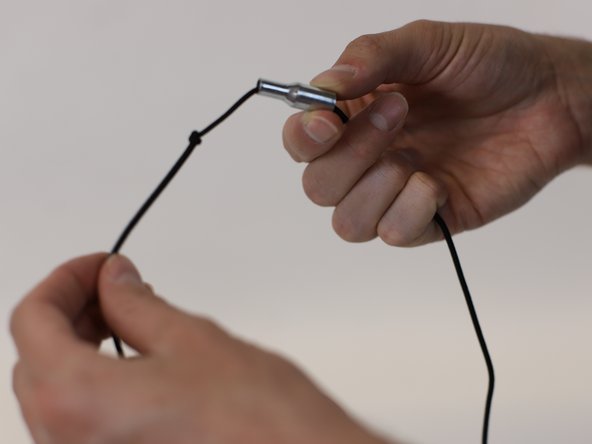

    • Pick the other end of the cord to "round" the tip.
    • Use a lighter to slightly melt it.
    • Tip: The flame does not need to touch the cord directly, only to melt the fibres through indirect heat.
    • While the tip is still semi-melted, press it together with your fingers while twisting gently to create a thin, rounded ending.

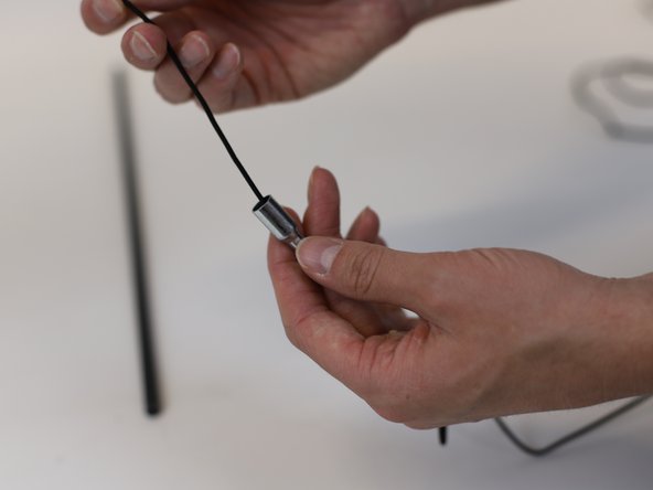

    • Begin to reassemble the tent pole by inserting the first metal tip and sliding it all the way back to the knot.
  10. How to Replace the Tent Poles Elastic, Continue to reassemble: crwdns2935265:010crwdnd2935265:01crwdnd2935265:03crwdne2935265:0 How to Replace the Tent Poles Elastic, Continue to reassemble: crwdns2935265:010crwdnd2935265:02crwdnd2935265:03crwdne2935265:0 How to Replace the Tent Poles Elastic, Continue to reassemble: crwdns2935265:010crwdnd2935265:03crwdnd2935265:03crwdne2935265:0
    • Once you have inserted the first metal tip, you should insert the pole that follows.
    • Note: remember to insert the poles and the metal tips, separately.
    • Remove the metal tip first and then insert the cord through the pole hole.

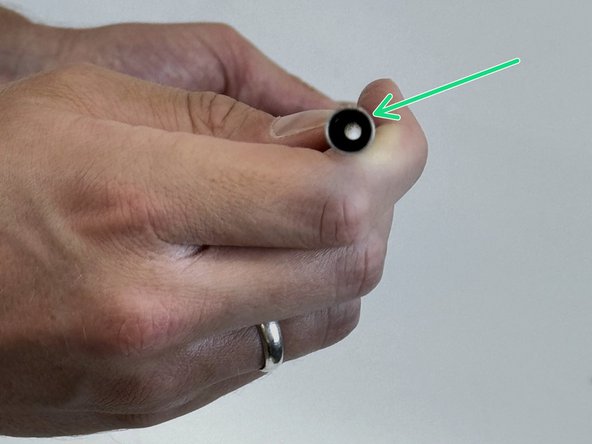

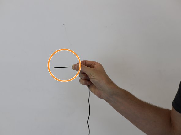

  12. How to Replace the Tent Poles Elastic, Check the metal tips of the poles: crwdns2935265:012crwdnd2935265:01crwdnd2935265:03crwdne2935265:0 How to Replace the Tent Poles Elastic, Check the metal tips of the poles: crwdns2935265:012crwdnd2935265:02crwdnd2935265:03crwdne2935265:0 How to Replace the Tent Poles Elastic, Check the metal tips of the poles: crwdns2935265:012crwdnd2935265:03crwdnd2935265:03crwdne2935265:0
    • Some metal tips might be stuck and you won't be able to remove them.
    • If this is the case, you must insert the cord directly into the hole of the metal tip (green arrow).
    • To make it easier, the tip of the cord must be in a straight horizontal line (orange circle).
