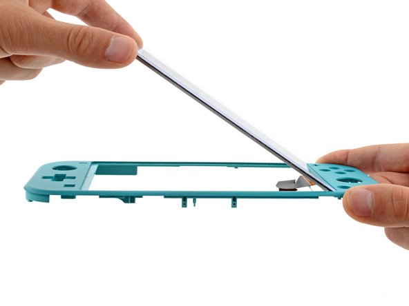

    • Apply high concentration (90% or greater) isopropyl alcohol to the old screen adhesive on the frame.
    • Wait one minute to allow the alcohol to penetrate the adhesive.
  2. How to Replace the Screen Adhesive on Your Switch Lite, Remove the old adhesive: crwdns2935265:02crwdnd2935265:01crwdnd2935265:03crwdne2935265:0 How to Replace the Screen Adhesive on Your Switch Lite, Remove the old adhesive: crwdns2935265:02crwdnd2935265:02crwdnd2935265:03crwdne2935265:0 How to Replace the Screen Adhesive on Your Switch Lite, Remove the old adhesive: crwdns2935265:02crwdnd2935265:03crwdnd2935265:03crwdne2935265:0
    Microfiber Cleaning Cloths
    $3.99
    • Use the flat end of a spudger to scrape all the old adhesive from the frame.
    • Use a microfiber cloth to clean the frame.

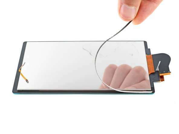

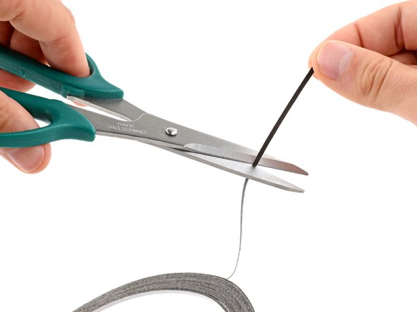

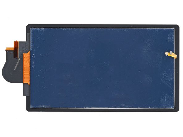

    • Measure and cut four strips of 2 mm‑wide Tesa tape for the back of the screen:
    • Two strips for the long edges
    • Two strips for the short edges
    • You can use other adhesives, but make sure the strips are no wider than 3 mm.

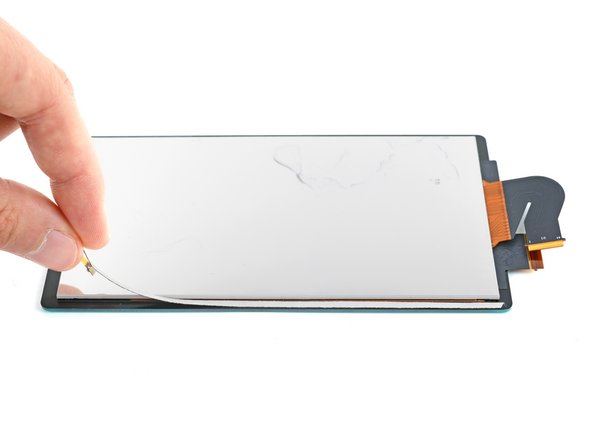

  4. How to Replace the Screen Adhesive on Your Switch Lite, Apply the adhesive: crwdns2935265:04crwdnd2935265:01crwdnd2935265:03crwdne2935265:0 How to Replace the Screen Adhesive on Your Switch Lite, Apply the adhesive: crwdns2935265:04crwdnd2935265:02crwdnd2935265:03crwdne2935265:0 How to Replace the Screen Adhesive on Your Switch Lite, Apply the adhesive: crwdns2935265:04crwdnd2935265:03crwdnd2935265:03crwdne2935265:0
    • Apply the adhesive strips sticky side down to the back of the screen, making sure the tape goes under the screen and digitizer cables.

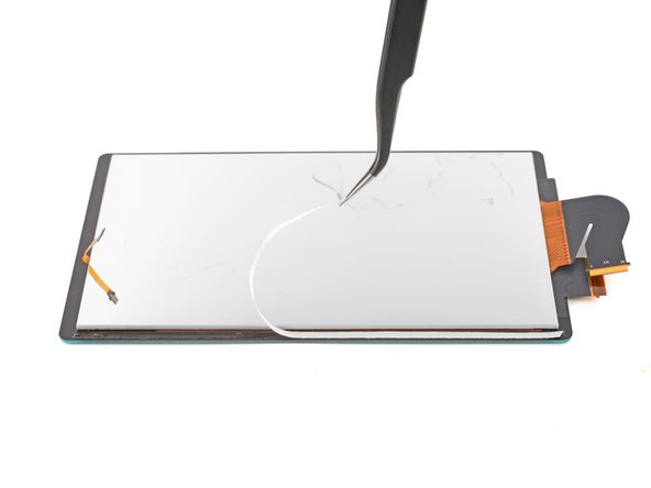

  5. How to Replace the Screen Adhesive on Your Switch Lite: crwdns2935265:05crwdnd2935265:01crwdnd2935265:02crwdne2935265:0 How to Replace the Screen Adhesive on Your Switch Lite: crwdns2935265:05crwdnd2935265:02crwdnd2935265:02crwdne2935265:0
    • Use tweezers to remove the liners from the adhesive strips.

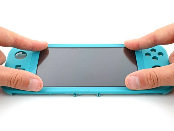

  7. How to Replace the Screen Adhesive on Your Switch Lite, Place the screen on the frame: crwdns2935265:07crwdnd2935265:01crwdnd2935265:02crwdne2935265:0 How to Replace the Screen Adhesive on Your Switch Lite, Place the screen on the frame: crwdns2935265:07crwdnd2935265:02crwdnd2935265:02crwdne2935265:0
    • Lay the right edge of the screen on the frame at a downward angle, making sure its cables go under the frame.
  8. How to Replace the Screen Adhesive on Your Switch Lite: crwdns2935265:08crwdnd2935265:01crwdnd2935265:02crwdne2935265:0 How to Replace the Screen Adhesive on Your Switch Lite: crwdns2935265:08crwdnd2935265:02crwdnd2935265:02crwdne2935265:0
    • Lay the left edge of the screen onto the frame, making sure the small cable goes under the frame.

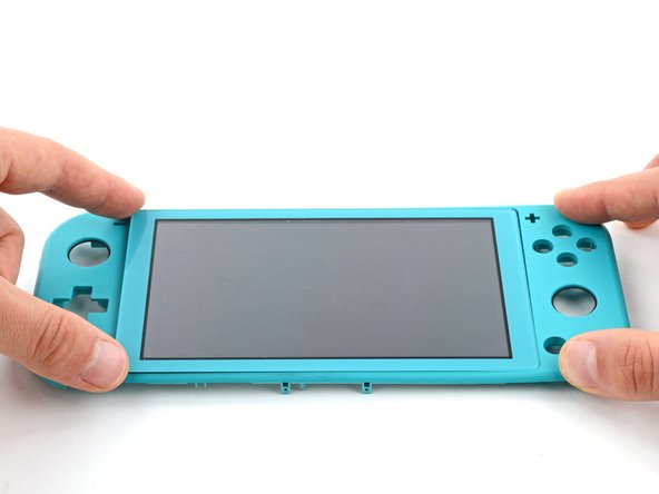

  9. How to Replace the Screen Adhesive on Your Switch Lite, Secure the new screen: crwdns2935265:09crwdnd2935265:01crwdnd2935265:02crwdne2935265:0 How to Replace the Screen Adhesive on Your Switch Lite, Secure the new screen: crwdns2935265:09crwdnd2935265:02crwdnd2935265:02crwdne2935265:0
    • Press down firmly around the perimeter of the screen to adhere it to the frame.
    • Make sure the top of the screen is flush with the frame.
