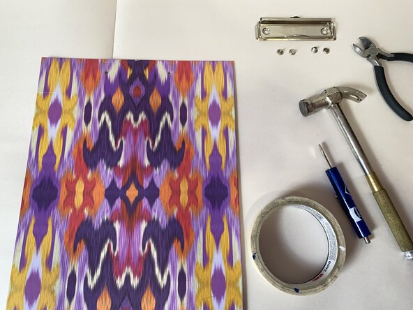

How to Replace the Rivets in a Clipboard
  1. How to Replace the Rivets in a Clipboard, Rivets in a Clipboard Clip: crwdns2935265:01crwdnd2935265:01crwdnd2935265:03crwdne2935265:0 How to Replace the Rivets in a Clipboard, Rivets in a Clipboard Clip: crwdns2935265:01crwdnd2935265:02crwdnd2935265:03crwdne2935265:0 How to Replace the Rivets in a Clipboard, Rivets in a Clipboard Clip: crwdns2935265:01crwdnd2935265:03crwdnd2935265:03crwdne2935265:0

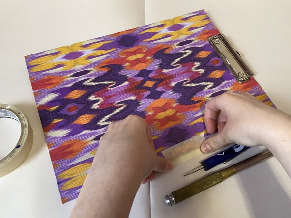

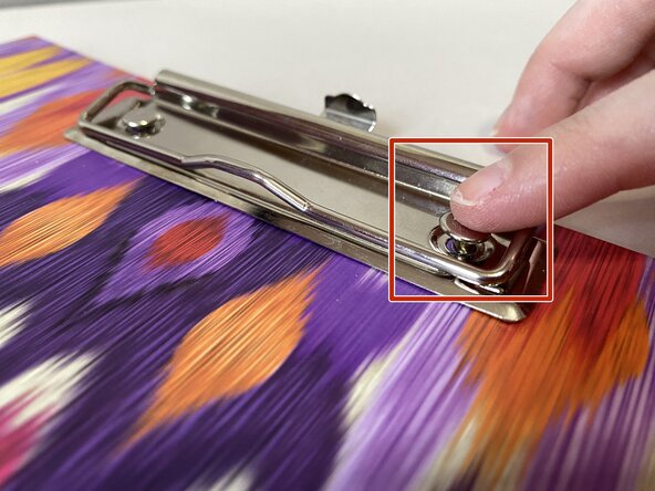

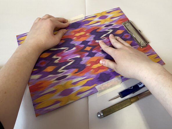

    • Use masking tape to secure the clipboard on a hard, flat surface.

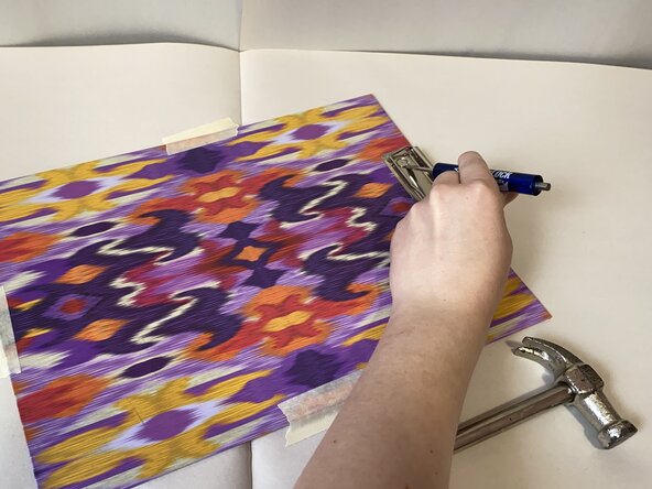

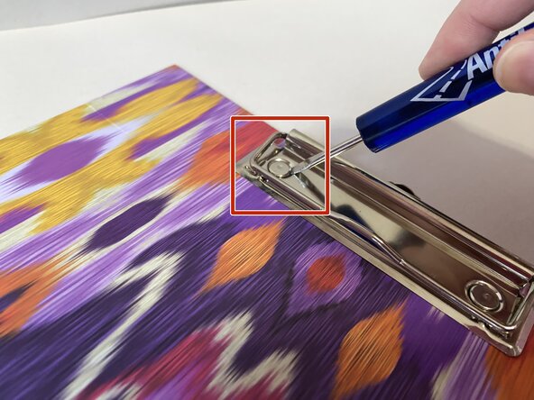

  2. How to Replace the Rivets in a Clipboard: crwdns2935265:02crwdnd2935265:01crwdnd2935265:03crwdne2935265:0 How to Replace the Rivets in a Clipboard: crwdns2935265:02crwdnd2935265:02crwdnd2935265:03crwdne2935265:0 How to Replace the Rivets in a Clipboard: crwdns2935265:02crwdnd2935265:03crwdnd2935265:03crwdne2935265:0

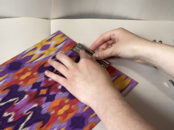

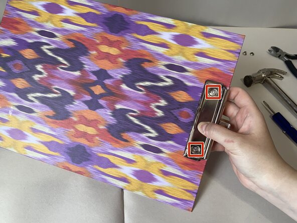

    • Wedge a screwdriver head under the rivets that need to be replaced.
    • Use a hammer to tap down on the handle of the screwdriver and pop the rivet heads upward and off the rivet backs.
    • Caution: Make sure to angle the hammer away from your fingers to avoid injury.

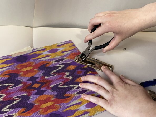

  3. How to Replace the Rivets in a Clipboard: crwdns2935265:03crwdnd2935265:01crwdnd2935265:02crwdne2935265:0 How to Replace the Rivets in a Clipboard: crwdns2935265:03crwdnd2935265:02crwdnd2935265:02crwdne2935265:0
    • If necessary, use pliers to remove tricky rivet heads.

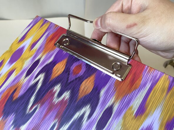

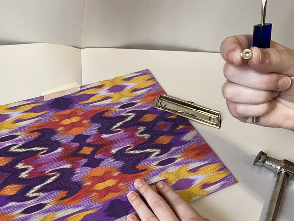

  4. How to Replace the Rivets in a Clipboard: crwdns2935265:04crwdnd2935265:01crwdnd2935265:02crwdne2935265:0 How to Replace the Rivets in a Clipboard: crwdns2935265:04crwdnd2935265:02crwdnd2935265:02crwdne2935265:0

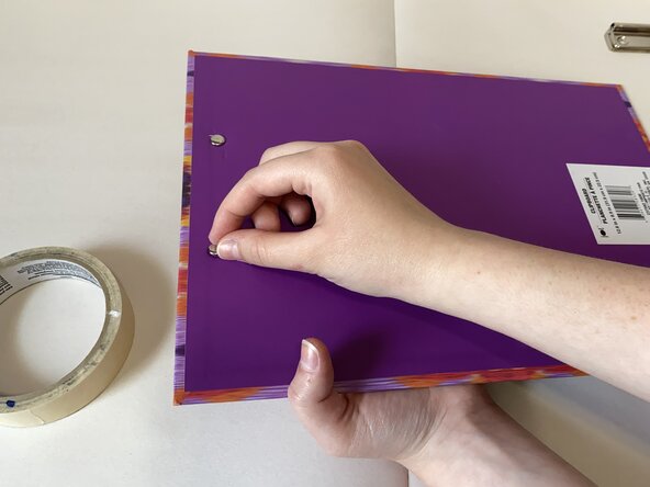

    • Remove the tape from the clipboard.
    • Pull the backs of the old rivets from the cutout holes in the clipboard.
    • Set aside the old rivet pieces and the detached metal clip.

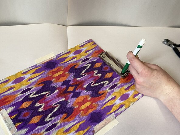

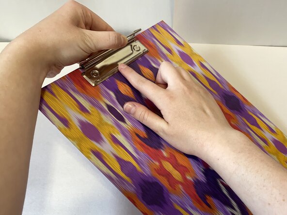

  5. How to Replace the Rivets in a Clipboard: crwdns2935265:05crwdnd2935265:01crwdnd2935265:03crwdne2935265:0 How to Replace the Rivets in a Clipboard: crwdns2935265:05crwdnd2935265:02crwdnd2935265:03crwdne2935265:0 How to Replace the Rivets in a Clipboard: crwdns2935265:05crwdnd2935265:03crwdnd2935265:03crwdne2935265:0

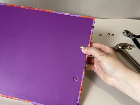

    • Place the metal clip on the board, aligning its cutout holes with those in the board.
    • Thread the new rivet backs through the cutout holes in the wooden board and those in the metal clip.

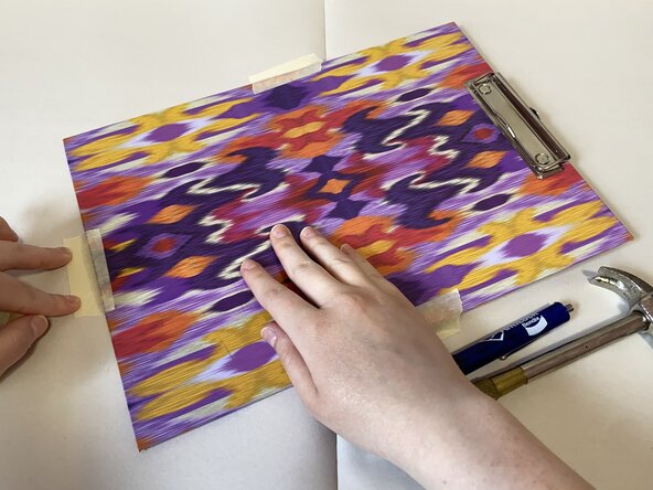

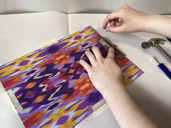

  6. How to Replace the Rivets in a Clipboard: crwdns2935265:06crwdnd2935265:01crwdnd2935265:01crwdne2935265:0
    • Use masking tape to secure the clipboard on a flat surface.
  7. How to Replace the Rivets in a Clipboard: crwdns2935265:07crwdnd2935265:01crwdnd2935265:02crwdne2935265:0 How to Replace the Rivets in a Clipboard: crwdns2935265:07crwdnd2935265:02crwdnd2935265:02crwdne2935265:0
    • Align the new rivet heads with the rivet backs.
    • Gently push the rivet heads into the rivet backs to temporarily secure them in place.

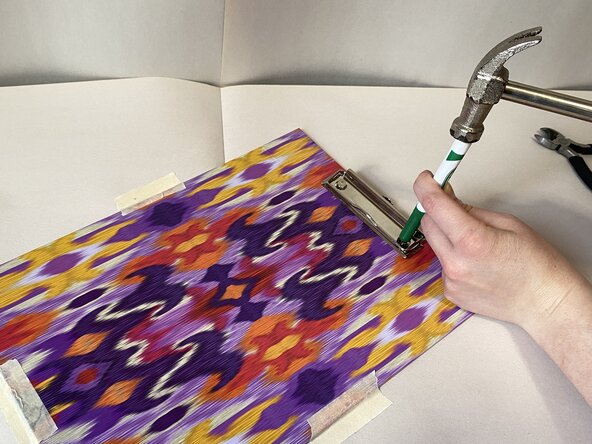

  8. How to Replace the Rivets in a Clipboard: crwdns2935265:08crwdnd2935265:01crwdnd2935265:02crwdne2935265:0 How to Replace the Rivets in a Clipboard: crwdns2935265:08crwdnd2935265:02crwdnd2935265:02crwdne2935265:0

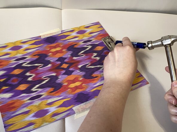

    • Place a marker or pad over the rivet heads to protect them and the clipboard while hammering.
    • Hammer the rivet heads into the rivet backs to secure the metal clip to the board.
    • Make sure to hold the cylindrical tool at a distance from the hammer to avoid injury.

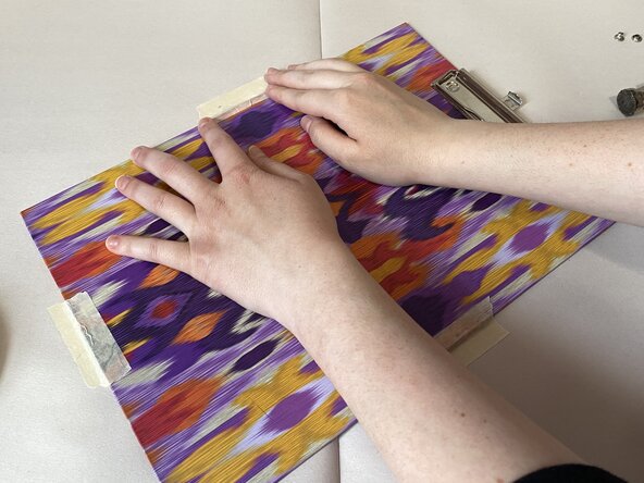

    • Remove the tape and check that the rivets have securely fastened the metal clip.
    • If the metal clip is still loose, repeat steps 6-8 until it sits securely against the board.
