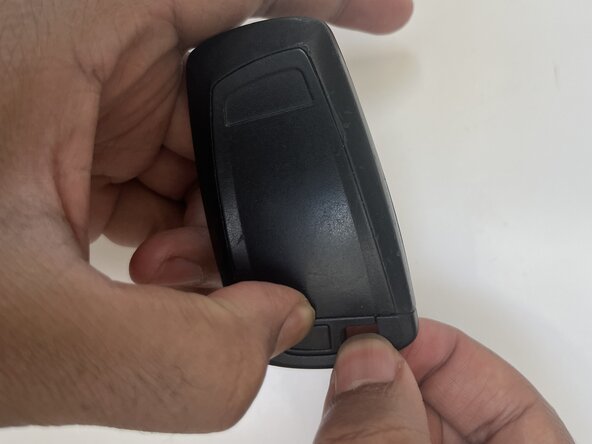

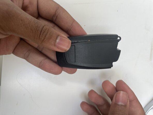

    • Press the small button on the back of the key fob to release the mechanical key.
    • Pull the key out completely.

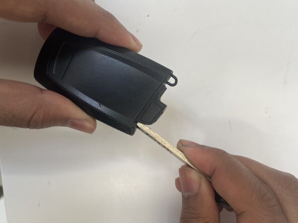

  2. How to Replace the Key Fob Battery in a 2018 BMW 330i: crwdns2935265:02crwdnd2935265:01crwdnd2935265:01crwdne2935265:0
    • Insert the mechanical key into the slot and gently twist it to pry open the key fob case.
    • Be careful not to use excessive force, as this may damage the plastic casing.

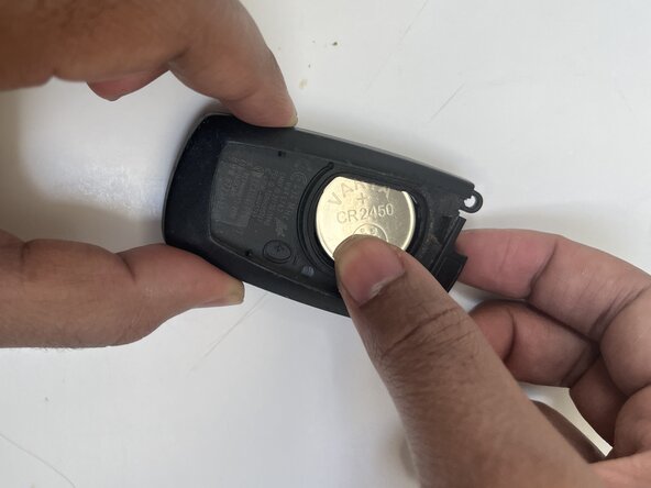

  3. How to Replace the Key Fob Battery in a 2018 BMW 330i: crwdns2935265:03crwdnd2935265:01crwdnd2935265:02crwdne2935265:0 How to Replace the Key Fob Battery in a 2018 BMW 330i: crwdns2935265:03crwdnd2935265:02crwdnd2935265:02crwdne2935265:0

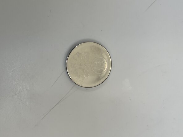

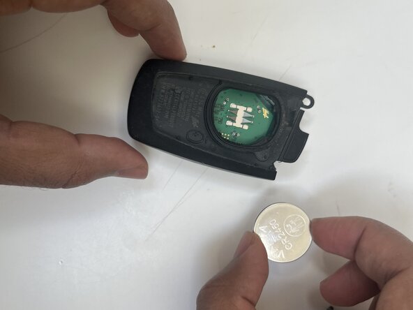

    • Once the key fob is open, you will see the CR2450 battery inside. Make a note of its positive (+) and negative (-) orientation.
    • Carefully remove the old CR2450 battery by lifting it out with a nylon spudger or your fingernail.
    • Avoid using sharp metal tools to prevent damage to the battery compartment.

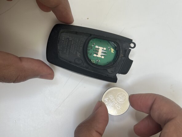

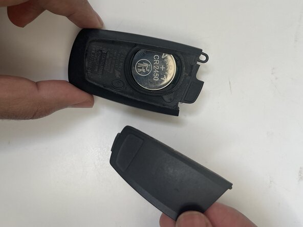

  4. How to Replace the Key Fob Battery in a 2018 BMW 330i: crwdns2935265:04crwdnd2935265:01crwdnd2935265:03crwdne2935265:0 How to Replace the Key Fob Battery in a 2018 BMW 330i: crwdns2935265:04crwdnd2935265:02crwdnd2935265:03crwdne2935265:0 How to Replace the Key Fob Battery in a 2018 BMW 330i: crwdns2935265:04crwdnd2935265:03crwdnd2935265:03crwdne2935265:0
    • Place the new CR2450 battery in the correct orientation, with the positive (+) side facing up.
    • Ensure the battery is properly seated in the battery slot.
    • Double-check that the battery is positioned correctly before closing the key fob.

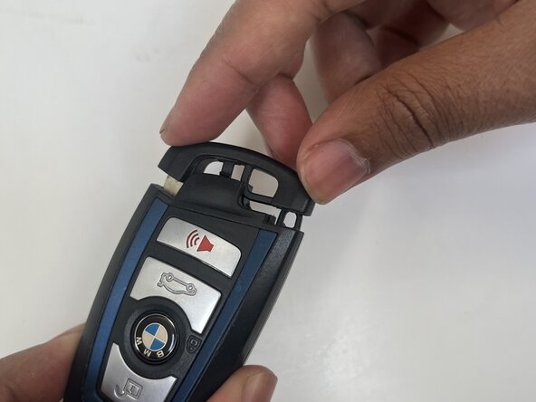

  5. How to Replace the Key Fob Battery in a 2018 BMW 330i: crwdns2935265:05crwdnd2935265:01crwdnd2935265:01crwdne2935265:0
    • Align the two halves of the key fob and press them firmly together until you hear a click.
    • Ensure all edges are securely snapped back into place.

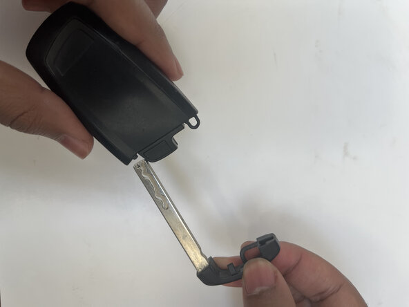

  6. How to Replace the Key Fob Battery in a 2018 BMW 330i: crwdns2935265:06crwdnd2935265:01crwdnd2935265:01crwdne2935265:0
    • Slide the mechanical key back into the key fob until it locks into place.
    • Press the lock/unlock buttons to ensure the key fob is working.
    • If the key fob does not respond, recheck the battery installation to ensure it is properly seated.
